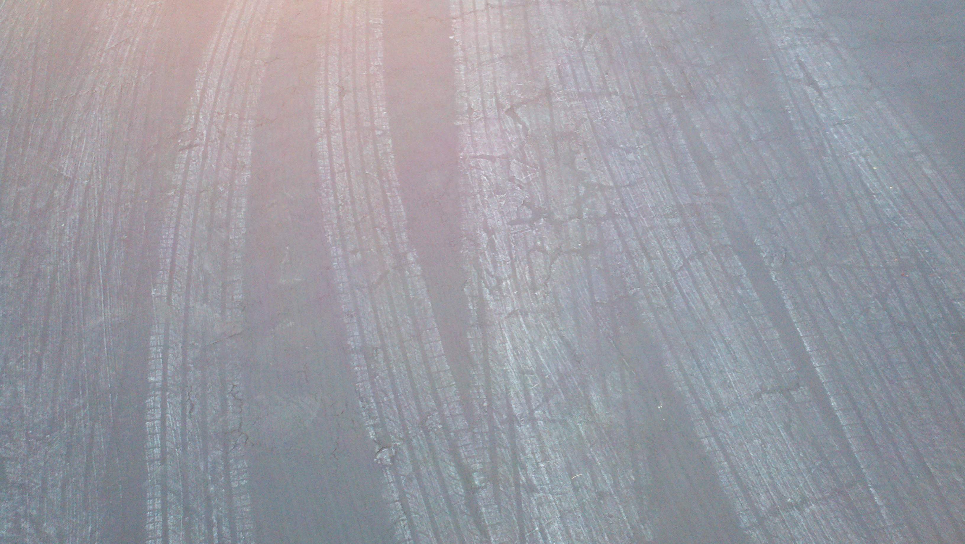

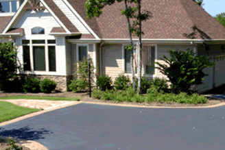

I got to looking at it after my previous work and it still had a lot of little cracks in it. Went back to the store and bought a couple more pails of sealer and this time mixed in a lot of sand - to the point that it was the consistency of drywall mud and then literally troweled it on in the areas that needed it but not over 1/4' thick. Then i let that dry for a few days and went over it all again with sealer as there were a lot of little cracks - 1/8' wide or less - that I was worried about water getting in over winter and freezing. Here are a few photos of the final result. I thought it came out looking good so now we will see how it holds up.
The first photo is a closeup of the area where all the gatoring was. I know the tires tracks make it a little hard to see but there is not a lot of the gatoring showing. The second photo is more of an overview from the same direction as the original photo. I know that since it is all black now it is hard to see the cracking like you can on the weathered photo but as you can tell from the other photo it does look pretty good up close.
All totalled - for 2400 sq ft of asphalt was right at $300. If I was going to do it again i would have mixed my first repair material thicker and troweled it on in a couple of layers and sealed it once with a sealer with about 1 part sand to five parts sealer to keep it from shrinking and cracking. I will repost next spring after it has endured a winter to let you all know how it held up.

Looks good. :thumbsup:
Just be aware that a replacement fund being started might be a good idea.:)

Update - The finish I put on it is about off now. I have decided that I need to dig water and a gas line under it so I am planning on completely replacing it next summer. I did get four or maybe five years out of it though until it got back to the condition it was in. That isn't too bad.

Read thru a couple of threads here and thought i would still ask the question with photos. Looking for suggestions on what to do with my asphalt driveway. The top looks very rough but it has very few real cracks and is about 40 years old. I was wondering if I should seal it, top coat it, or other thoughts!
Thanks in advance for your suggestions!
