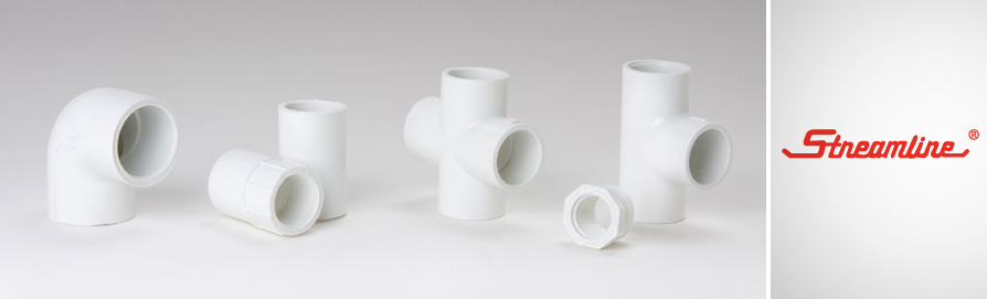

The city installed the meter and connected my pipe yesterday. I blocked the end of the gasketed pipe run today. I placed 4 roughly 1'x1'x6" rocks at the end of the line, brought the line up with a 90, used another 90 to send it on toward the house, reduced to 1.5" pipe and installed a shutoff valve.
My plan is to slowly turn on the meter with the shutoff valve open to bleed the air and clean out the pipes. Then slowly close the shutoff valve while praying that the gasketed pipe stays together.
Does this sound right?

STOP, where you are. If I am seeing correctly, that is a DWV 90 on that pipe. That is NOT designed for city water pressure. It is for drain and vent. A pressure 90 has a socket for gluing at least twice that deep. I think the reducer is also DWV but can't see it well enough to be sure. If it holds now it won't for long.
   / Assembline SDR 17 2" Gasketed Water Pipe #18
They look like this.

Thanks I will replace them!
