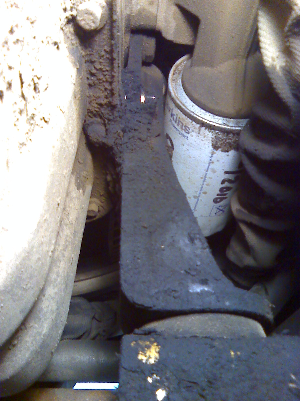

Had the exact same problem with my RC100. There's a pipe that joins both fuel tanks together with a Tee in the middle for engine supply. Over the years, debris collects in the tank and built up in the tee. Fuel gets cut off and engine dies with white smoke. Blowing it out with air in reverse direction fixed the problem. Take cap off tank before blowing out, otherwise you'll pressurize the tank and get a face full of fuel :)
Check those engine mounting bolts!! They are drilled into the crankcase. if one falls out, you'll lose your oil fast. Quick tighten with a 14mm socket. Picture below shows dirt built up from leaking oil when a bolt was loose.
