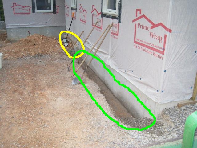

Obed, am I missing something about your brick veneer? I don't see a brick ledge around your foundation.:confused:
attachment.php
The brick ledge is highlighted in yellow in the picture. At the spot highlighted in green, the bricks will sit on the footer. Most of the brick on the front of the house will sit on brick ledges. Most of the brick on the back side (basement side) of the house will sit on the foundation footer.

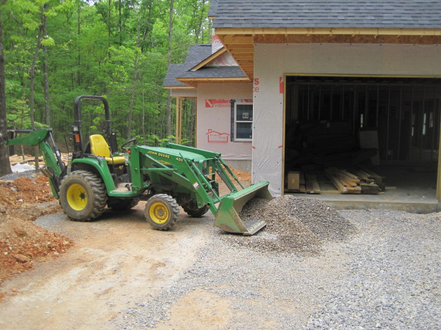

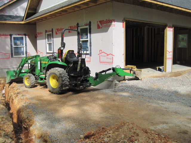

More Digging

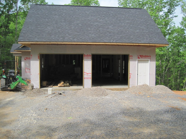

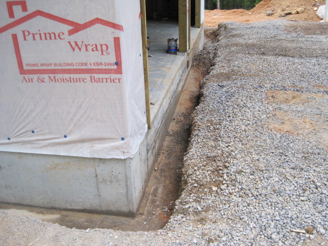

I continued removing gravel around the garage today in preparation for the brick.
attachment.php

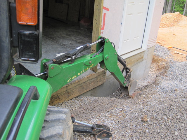

Fortunately today I was able to use the backhoe for some of the digging. I had to position the tractor just right so I could dig and create the gravel pile without getting myself hemmed in. All this gravel adds up.

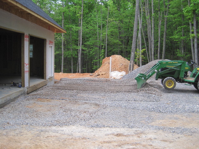

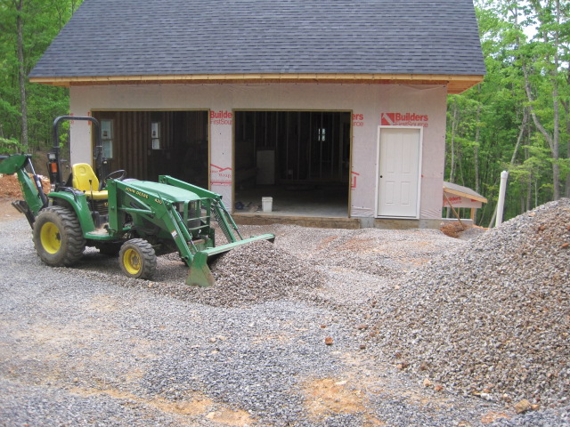

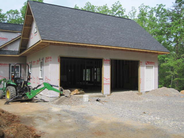

I made some gravel piles that needed to be moved. The FEL sure comes in handy. It's my favorite tractor implement.
attachment.php
I moved the gravel to my main gravel pile. I back dragged the gravel into a windrow and then used the FEL in dozer mode to push the gravel to the pile.

Obed - My guess is that the CM thought he was creating a drain around the foundation in front of the garage so that frost would not damage foundation. Why are you paying to have brick buried below garage entry? Won't you still have to provide gravel in front of brick to protect against frost damage thru expansion of the ground you said you will fill with dirt when brick work is complete?

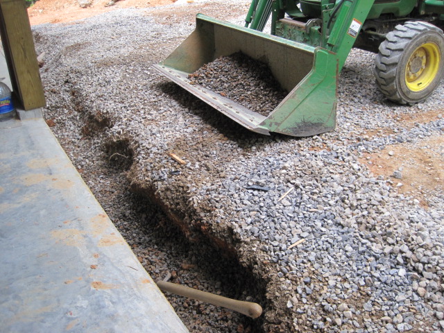

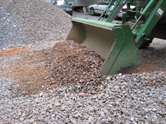

This gravel has a bunch of red clay mixed into it. Compare the color of the "clean" gravel at the bottom of the picture to the gravel in the bucket. I didn't want this gravel to polute my clean gravel pile so I moved it to a "dirty" pile. I still had to use my hand tools to clean out the bottom of the trench. I used the FEL bucket as a wheelbarrow for carrying the gravel. Our real wheelbarrow is stored somewhere in our storage trailer and is not accessible.
attachment.php
Here's how far I got today before it started raining. The rain came a little too soon so today I wasn't able to finish this last section around the garage.

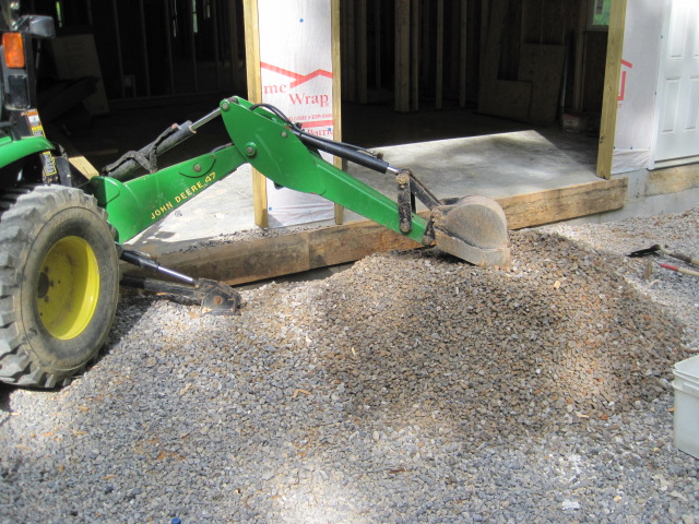

PAGUY,
I've gone back and forth about this. Here are my thoughts and I'd welcome some comments. If there is gravel against the foundation without a drain tile, it seems to me that water will be encouraged to puddle around the foundation below ground and freeze. I'm thinking that I would be better off to fill with red clay so the clay will funnel water away from the house so there won't be much moisture beside the house that could freeze. This section of the house is almost at grade and sitting on a ridge line so there's not a huge source of water other than the roof. The roof water will be caught and drained away using the guttering drains. I suppose the best thing would be to put in drain tile and a drain line. But in this situation, is a drain tile really necessary? I guess I'm getting tired of digging ditches and another trench and pipe would be necessary to drain the drain tile.
There won't be brick below the overhead garage doors. I'm just removing the gravel under the garage doors because of what I described above.
