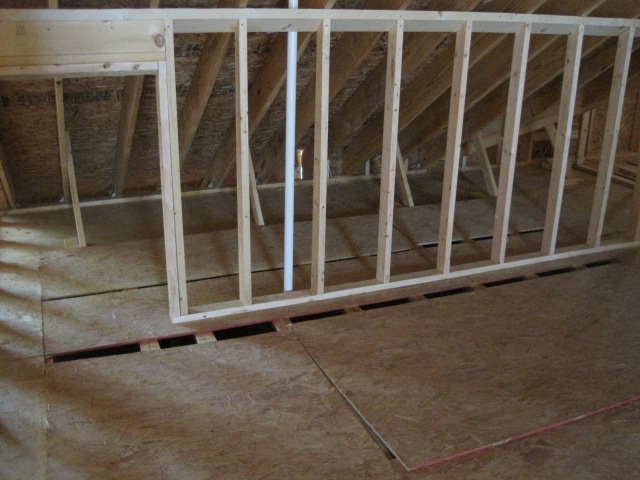

Ceiling Insulation Prep

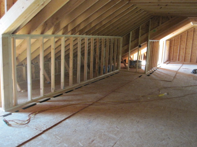

Insulating our ceiling has been aberation for all the insulation companies. The fact that we are not finishing the attic but have sub-floor in the attic for structural support has caused the insulation companies to scratch their heads. Most people who build an upstairs like ours finish it so they don't need insulation between the main floor and the upstairs. I described the rational for the subflooring in the attic here.

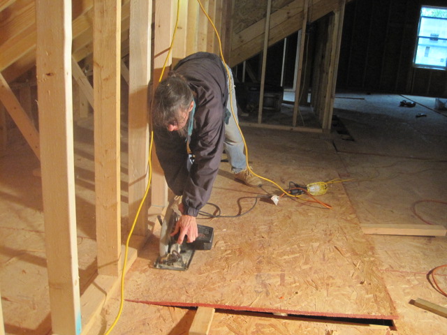

Building a house can have a never ending stream of drama. The insulation company I described here was scheduled to arrive this afternoon and blow the insulation in our main floor ceiling. We had a general laborer we've used before to arrive this morning to prep the attic for the insulation work scheduled for the afternoon. The plan was for our laborer to remove about 1/3 of the OSB sheets in the attic in the morning. That afternoon the insulation company would blow insulation in the ceiling through the openings caused by removing the OSB. This morning our worker did not show. My wife called him and left a message. He called back and said that he's in Kentucky doing some work there this week.
So my wife called her father who came over. They removed some OSB boards but found the going very slow. To complicate things, the infamous construction manager was supposed to partially screw down the OSB boards but instead he completely screwed them. There are 18 screws in each sheet; there should have been half that number in each sheet. By the time you locate the hard to see screws, dig the sawdust out of the screw heads so you can unscrew them, and remove the screws, you can spend 20 to 30 minutes removing each sheet. Plus, some of the OSB sheets have to be cut because they may sit under walls. My wife and father-in-law saw that there was no way they could remove the OSB in time so the insulation company had to be re-scheduled.
attachment.php
This evening I removed some OSB sheets after work. The loose sheets have been slid over about 3 inches from their installed location. It took me 2 hours to remove 4 sheets. The last sheet went faster than the others once I started getting a system. The screwdriver bit would tend to slip when unscrewing the screws. I found I needed to dig the sawdust out of the screw heads before unscrewing to rectify this problem.
We are trying to re-schedule the insulation blowing for Monday. That will give us the weekend to make sure we have removed the required OSB.

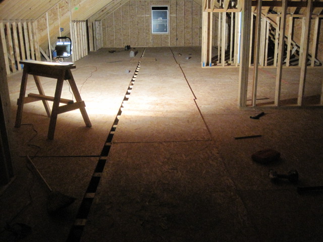

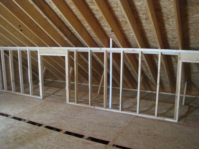

Yesterday the wife and I spent a long day unscrewing the remaining pieces of attic OSB subflooring required for blowing the main floor ceiling insulation. I'm going to estimate that we removed over 300 screws. The screws were driven deeply below the surface and were difficult to find. I spent all day on my knees with a drinking straw in my mouth and with a drill and screw bit. I used the drinking straw to blow around on the OSB so I could find the screws and blow wood ships out of the top of the screws. Along the walls and behind the knee walls we had to cut the OSB along the walls to remove the sheets. The wife worked with me all day. She marked and cut the OSB while I located and removed screws. We dragged the OSB sheets about 3 inches from their installed locations.

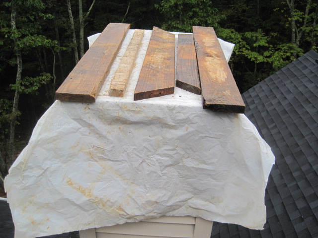

Saturday we got a lot of heavy rain. While working in the attic, we noticed a leak around the chimney flue. We don't yet have a chimney cap. Unfortunately, when the vinyl guys put vinyl around the chimney, they didn't erect anything to temporarily divert water or warn us about the need to cover the chimney. Before the vinyl was installed, water would just roll off the temporary osb that covered the chimney. After the vinyl was installed, the water was trapped by the vinyl around the osb and had to go down the chimney. So we put some plastic and boards over the chimney until the fireplace company installs the chimney cap. I'm not comfortable being up on that 8/12 pitch roof.
Things are looking good Obed. I hope the water didn't get to any drywall or damage anything else. I hear you on the 8/12 pitch, not much of a fan either.
Obed - I don't want to ruin your day but I think duct tape or a bungie cord around that chimney holding the plastic in place would be a better deal. Any strong wind is going to lift those boards off sailing them to the ground so at the very least don't have anything below them as they may even damage your shingles and god forbid if someone was standing down below when they fall. JMO - PAGUY

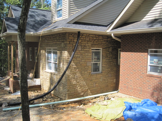

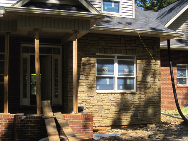

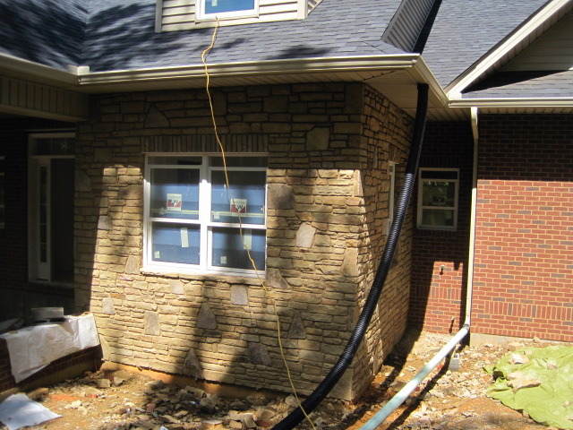

The outside stone work is done.
attachment.php
We really liked the stone mason so we have hired him to lay the stone on the fireplace in the living room. We used real stone on the outside. We will be using cultured (fake) stone for the LR fireplace. Real stone weighs significantly more than cultured stone. If we had used real stone, we would have needed to pour footers in the basement and laid a concrete block wall in the basement to support the stone in the living room. That's why we went with cultured stone in the LV fireplace; it was much simpler.
The stone mason did all the work himself; he didn't have any helpers. Several of our subcontractors (i.le. the owners) did not do much, if any, of the labor but had their hired hands do all the work. Quite a few of the subs we hired rarely were on site. We have noticed a correlation regarding how much the owner is on site and the quality of work and number of mistakes. The quality of the work on our job performed by the subcontractors who have become solely managers and salesman has been noticebly worse that the work of the subcontractors who actively work alongside their employees. This observation has not been universal; the vinyl subcontractor did not do any of the actual work but we were pleased with his company's work. But the vinyl subcontractor was the exception, not the rule.
