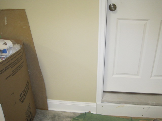

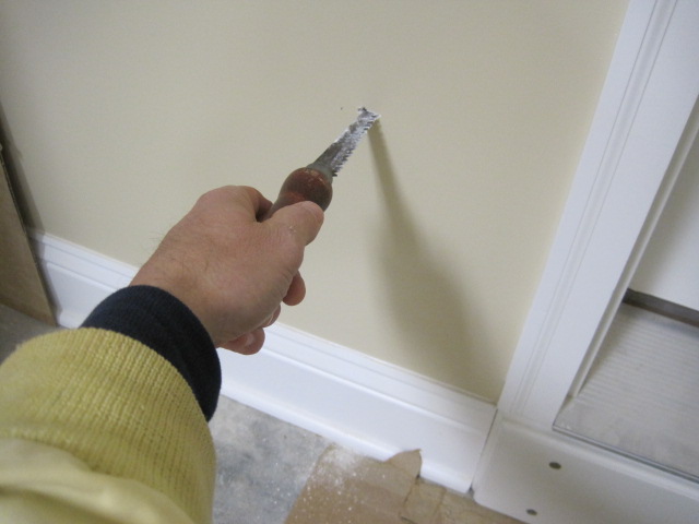

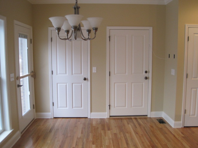

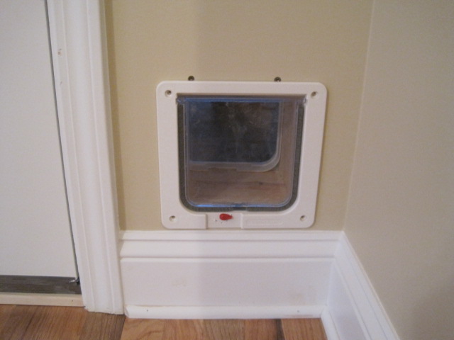

Cat Door

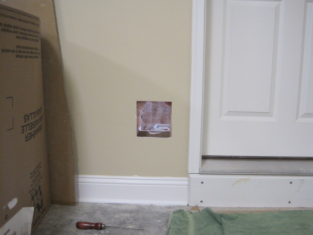

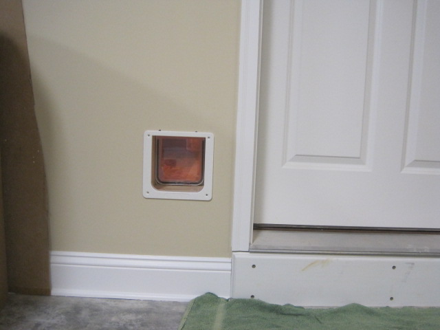

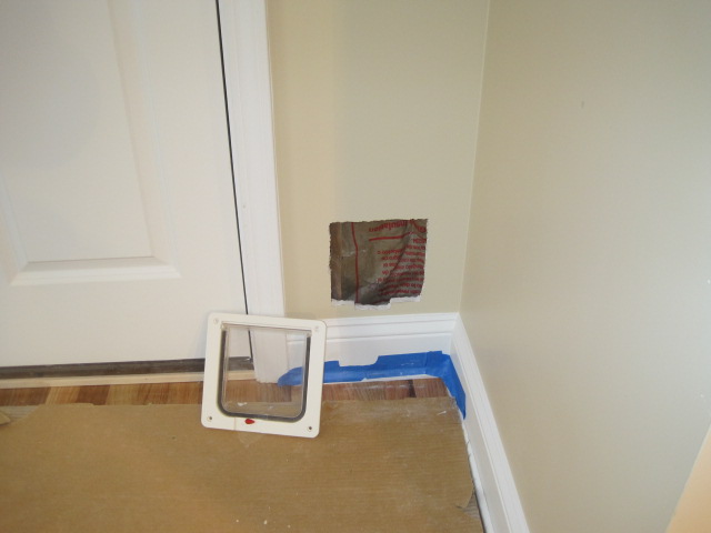

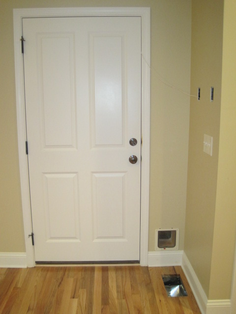

We needed to install a cat door between the kitchen and garage in order to be able to move into the house. We plan on putting the litter box in the garage. We waited until we got our certificate of occupancy before installing the cat door because it appears the county can get very particular about what you install in a garage.

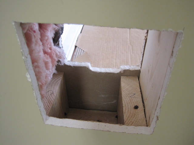

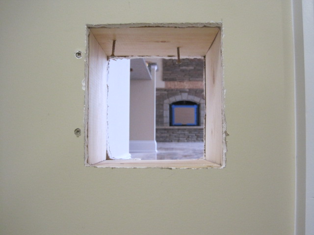

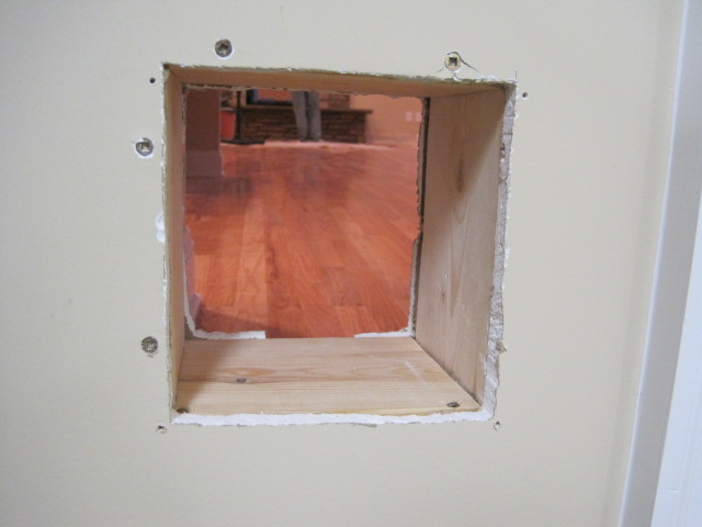

My impression is that most people install cat doors in doors but we wanted to install our cat door in the wall. I had to install some blocking inside the drywall to form a "tunnel" through the 2x6 framed wall. Some cat doors can be ordered with an optional "wall kit" but they are expensive. Of course if I consider how long it took me to install the cat door tunnel framing after the drywall was already hung, it would probably have been worth it to order the expensive kits. However, it was mostly a case of wanting to get the job done immedately without waiting for a special order kit.

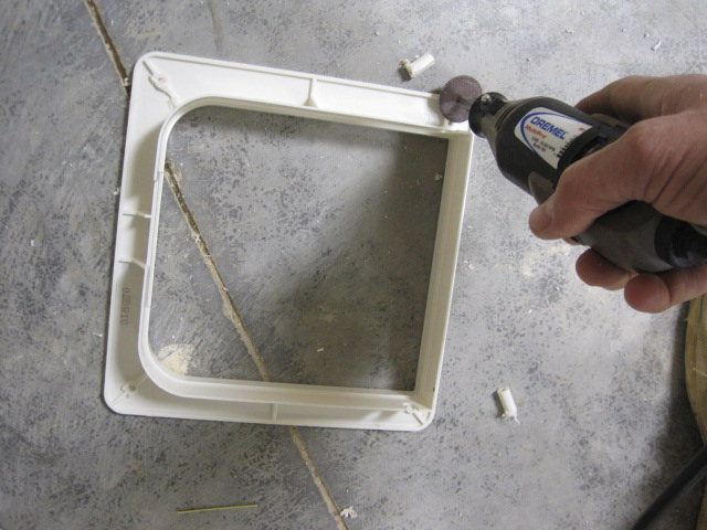

I used a Dremmel to modify the cat door so I could install it in a wall instead of in a door. I used the existing stud in the wall to form one side of the tunnel. I sanded the stud to prepare it for painting. I cut 1x6 boards to form the other 3 sides of the tunnel, these boards did not require sanding. I screwed two 2x6 vertical boards to the bottom plate to support the bottom horizontal 1x6. I screwwd the other two 1x6 boards to the drywall. I put 2 temporary screws in the top 1x6 to give me a handle so I could position the tightly fitting board.
The cat door is now ready for screwing to the wall. My wife will spackle and sand the screw holes then paint. After painting I will screw the cat door to the wall and be finished. I hope we won't have problems training our old cat to use the cat door.

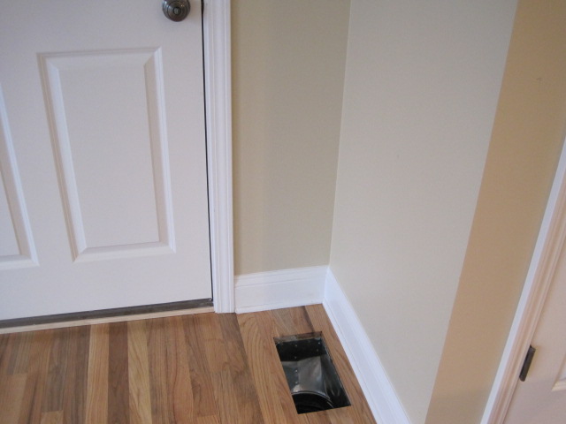

Just make sure you have a smoke detector close by inside the house, and if there are gas appliances in the garage a carbon monoxide detector. You've just made it much easier for fire and dangerous gasses to enter your house. That's why the county is probably a little funny about breaching that barrier. I understand you're an adult but just wanted to point that out to you.

The phrase "training a cat" seems so unnatural... :laughing:
We taped the door open for a while, this let the cats figure out that a passage was good. Cat treats on the other side of the door are good icebreakers. We kept lowering the door so the cats got used to it rubbing on the spine when they used it, and to having the door move.
Then there is the day of reckoning when you close it and let the cat go up and push on it, see that it moves and figure it out.
One cat was very stubborn and would just bang on the door so we would come and hold it open. For a while, she was more successful at training us than we were with training her :confused2:.
Good luck....
Pete,
Great suggestions. Thanks.
Do you have cat doors in walls? Did you install them during the house construction or afterwards? Do you have any cat doors in exterior walls/doors? How well insulated are they? My general impression is that most of the pet doors are not insulated very well; you might as well just have an open hole in your wall.
Obed
