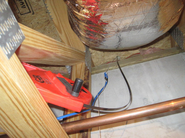

Today I ran a temporary Cat 6 wire from the phone network box in the basement to the office/dining room and moved the internet DSL modem from the basement into the office. Now my laptop has internet access via a network cable without having to use wireless. Our desktop computer does not have wireless and can now get on the internet.
I had a string running from the low voltage box in the office down through the wall into the basement for pulling network wires. Today we found that the string wouldn't budge. Either the insulation crew, drywall crew, or trim carpenter must have done something to bind the string in the wall. The string was useless so we had to run a fish tape from the basement up to the low voltage box. Once we did that, we pulled a new string down to the basement. Next we pulled a Cat 6 wire from the basement to the LV box in the office. We also made sure we left the string hanging so we can pull more cables. This wire is just temporary; eventually all the Cat 6 cables will run to the network closet.
The blue connection in the phone network box is for DSL internet; the orange connections are for phone lines. Very often, phone companies do not split the DSL signal from the phone signal. When that happens, you have to hang a filter on every phone in the house to remove the DSL signal from the phone line. We specifically asked the technician to split the signals in the phone network box.
The phone company has been very good at working with us; I've been happy with their service. They allowed us to locate the phone network box inside our house in the basement. Since the phone line runs from the street underground all the way to our basement, it will make it a little more difficult for a thief to cut the phone line before breaking into the house to prevent a security system from dialing out.
I do wish we had cut off the conduit sticking through the basement wall before the black phone line was pulled through it. I kind of thought the phone company would cut the conduit at a lenght to suit them but they just left it as is. I may eventually cut off that conduit and rerun the phone line to the network box when I don't have anything else to do in about 20 years.
I connected two pairs of wires in the Cat 6 cable to the phone network box and to two wall jacks. One pair is for DSL internet; the other pair is for the phone line.

...I do wish we had cut off the conduit sticking through the basement wall before the black phone line was pulled through it. I kind of thought the phone company would cut the conduit at a lenght to suit them but they just left it as is. I may eventually cut off that conduit and rerun the phone line to the network box when I don't have anything else to do in about 20 years.
You can cut that conduit in a few minutes without harming the cable inside by using a piece of mason's twine in a sawing motion where the conduit comes into the wall. You will cut through the conduit in seconds and then you just "walk" the cut portion around the conduit, taking care to keep the cable out of the way of the twine.

CurlyDave, I can cut it with a hacksaw without harming the twine if I'm careful; I've done that before. The problem is the black phone cable. I'm really not supposed to disconnect the phone from the network box. I might even have to jimmy the network box to get access to where the phone cable connects to the network box. Without disconnecting the phone cable from the network box, I would have to cut a slit along the length of the conduit to slip the conduit over the cable.
