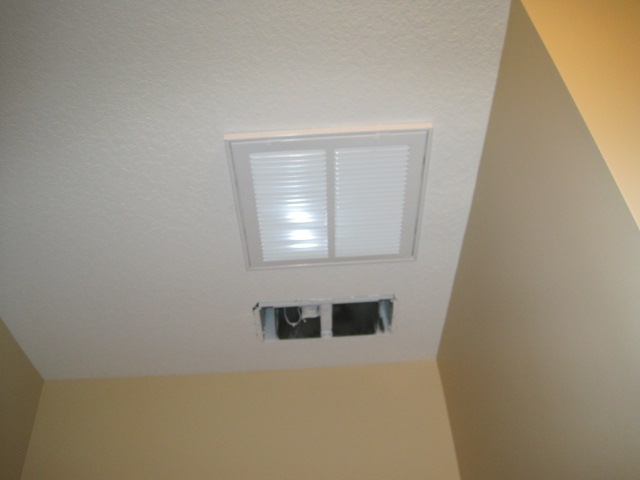

Tomorrow I will call him and have the discussion about the two return filter grills in the ceiling. I'm expecting it to be a battle. But right now, they haven't put covers over the auxilliary returns in the ceiling. Thus there can be no question that the work is not finished, even though putting covers over the ceiling returns is a small thing. Personally, I feel that I am going the extra mile to not make them redo the ceiling returns with grills that will accept filters and am offering to do the work myself if the H&A guy will just provide us the parts.

We were unable to come to an agreement with the HVAC guy. He was unwilling to talk about the fact that our baby's bedroom was noticeably colder than the rest of the house. When he wouldn't have a civil conversation about the coldness in the baby's room, I decided to hold my ground regarding the ceiling filter grills. He was also unwilling to put filter grills in the two ceiling returns.

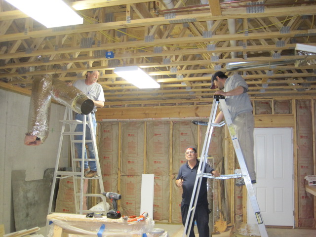

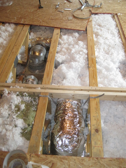

The baby's room is at the other end of the house and has a single 6" duct running to the register in that room. The other rooms in the house have 8" ducts. It seemed like a no brainer that the smaller duct to the baby's room at the end of the house was affecting the cooler temperature but the HVAC guy tried to claim that the duct size had nothing to do with it issue.
I told the HVAC guy I would pay him his final payment when he rectified the two issues to my satisfaction. This was after he had made threats to take us to court. I sent him an e-mail giving him 7 days to start work. When I heard nothing from him, I sent him a certified letter that contained the e-mail conversations we had had just to have a document trail proving we tried to work things out with him.
After sending the certified letter, we interviewed a couple HVAC companies and hired one of them to increase the duct size going to the baby's bedroom and to install filter grills in the ceiling returns. The new HVAC company did the work last week. My wife fed them homemade vegetable soup and cornbread for lunch. When I paid for the work at their office the next day, the lady who took my check commented about how the workers really enjoyed coming out to our house.
We've not used the fireplace the last few days and been checking the temperatures around the house. The temperatures around the house are now very similar. The baby's room is as warm as the other bedrooms now. Keep in mind that the original HVAC guy claimed that increasing the duct size to the baby's room would not help. We also now can put filters in the return grills in the ceiling. I'm very happy!

Obed, I'm assuming the new HVAC guys agreed that the original size of the duct work going to the babies room was too small since the new larger size apparently corrected the issue.
   / At Home In The Woods #2,869
Glad the duct size worked. The original guy should have had a manualJ calculation to back up his design. If the required room flow was over what one 6" duct provides, then he should have increased it. However, the final balancing is the real determination. Glad the 8" worked out for you.
I have one room where I suspect the flex duct got kinked when it was installed. It's in a attic dormer, and I can't get to it to check without tearing out the ceiling. That room is always a little cooler than others, and it's a smaller room than others with one duct.
