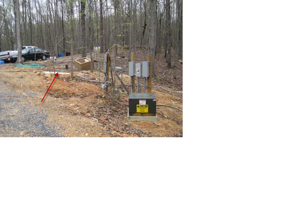

Dave,
The well guy told my wife that we don't need to cover the the well casing. The water pipe from the well pump runs through the casing 2 ft below grade using a pitless adapter. While building the house, we had a temporary water pressure tank above ground in the well house that needed freeze protection. The permanent pressure tank is now in the basement so we don't need freeze protection at the well casing any longer.
That's a good point about any saplings close to the transformer. We will may plant some shrubs to hide it but will need to consider how deep the roots will grow.
Obed
Ah - Makes sense - I couldn't figure out why you had the concrete pit around the well. Around here, the well head at the surface is just for pump access and the pipe actually goes horizontal 6' or so below grade (usually more to go under the foundation), so it never sees frost.
The power Co guys usually have some spec of clearance they want on given sides of the transformer. If you stick to that with just smaller shrubs, you won't have any issues, but trees could be an issue.

Here's the picture of our outdoor electrical service panel pedestal where we will eventually install a jack for the future generator.
attachment.php

We don't have a concrete pit around the well; I'm not really sure what a concrete pit around the well is. We don't have any concrete at all around the well. The well was dug 300ft with the drill. The steel well casings were driven down 200+ feet into the well to protect the well from debris. There's not any concrete.
Obed
Well, OK, but I'm confused. What's this thing that looks like a concrete pit?
attachment.php
Dave,
Those were loose concrete blocks stacked on the ground two high. The well house was sitting on top of the blocks. The blocks are no longer there. We removed them when we removed the well house.
Obed

Ah. Well there ya go. (I'm Dave BTW). But that was what had me confused. I see now it was something you had done for the camper, which makes sense. Just checking, as these things vary around the country.
