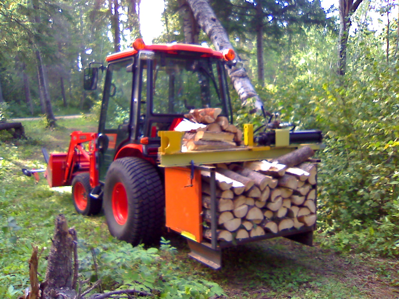

There are lots of threads about wood splitters. Depends on your needs which will suit you best.
I didn't want to spend a lot on one so built mine out of steel I had around and about $300 worth of hydraulics that I bought and run it off the tractor rear remotes. I have never needed to but I like that I can lay mine on the ground and roll large heavy rounds onto it. Most of my wood comes from trees the wind has knocked down so I rarely need to concern myself with felling.
