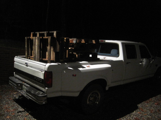

My wife brought home 13 used pallets today. She stopped at some businesses and asked if she could have them. They all seemed happy to give them away. One guy mentioned it was good because now he wouldn't have to cut them up and dispose of them.
Hopefully this weekend I'll get to put some freshly split logs on the pallets!
