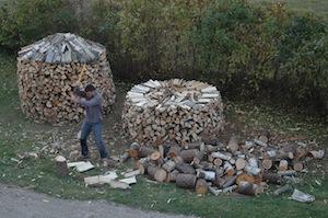

Something else I've been considering is to stack my firewood in round stacks like shown here - A Better Way to Stack Firewood.
attachment.php
I think these round piles are rather attractive and interesting. But mostly, they appear to be really easy to make. Only the outer circle has to be carefully stacked. All the wood in the middle is just tossed in unstacked.
The two downsides I could see to the round stack could be:
1. The center pieces of wood may take longer to dry than in a regular stack.
2. The bottom of layer of wood appears to sit directly on the ground (termites/rotting).
I'll be working out my firewood process for a while to find out what works best for us. I'm finding the firewood project to be a lot of fun.

Obed, couldn't you build the round stacks on pallets thus eliminating the problem of being on the ground? I would think the wood in the middle would dry faster as there would be more air, but I am probably wrong.

Why dont you just stack it between two trees with treated boards or old tin or pallets under it all to keep it off the ground and not worry so much with it. It will dry this way the best. Or just build you a small lean to shed like i did to keep rain off of it and stack it in there. You can then get a wood cart like i have or use you pallet method and take enough wood to the house for a few days. I personally dont want much more wood than that near my house as some had termites in it when split. I dont pay enough attention to it or get wood in the dark as to notice the termites at handling time. So i do not want termites near my house. The wood shed is 35 yards or so from my house.

Yeah you don't have much hope of keeping stacks in place on a pallet without some side support. If you have a good source of pallets, that trick should work, or you can just use 2x4's or whatever. Best bet would be to put them together with galv screws so you can break them down to save space.
When stacking on the ground, lay down a plastic tarp first so you don't get moisture coming up from the ground. Even if you put it on pallets, this is a good idea to put under the pallet. Tarp on top and bottom but leave sides always open for airflow.

Putting the round stacks on pallets sounds like a great idea. I was considering putting some gravel under the pile but I hate spreading gravel because it's forever. And a mix of gravel and topsoil is a useless combination.
I had not thought of a moisture seal on the ground but I could see where that makes sense. I read something today that suggested putting a perferated plastic drain tile pipe running vertically in the center of the pile with a cap on it. Supposedly the pipe will allow air and moisture flow out of the center of the pile to help dry it.

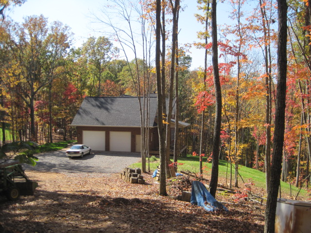

Sunday afternoon, my wife and I loaded into the back of the truck the freezer that died last year while we were still living in the camper. The junk freezer has been sitting on our property long enough. You can see it on the right side of the first picture. Since we are having a couple big gatherings at our house over Thanksgiving, my wife decided it was time for the freezer to vacate the property. I hurt my back a few years ago moving this freezer. Now I have a tractor. Lifting it into the truck was a breeze this time.

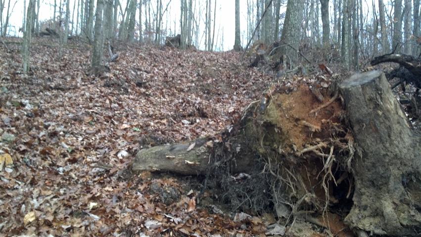

While I was on the tractor, I decided to haul off a couple of stumps to our stump dump which is down a steep hill in the woods. Rain was in the forecast so I wanted to get this done before the ground got wet. I made sure the tractor was in low gear and 4WD and headed down the steep downhill path through the woods. After dumping the stumps on the pile, I put the tractor into reverse so I could back up the hill. I have done this same maneuver a few times before. I could not turn the tractor around and face uphill for rear of rolling the tractor if I got it sideways.
attachment.php

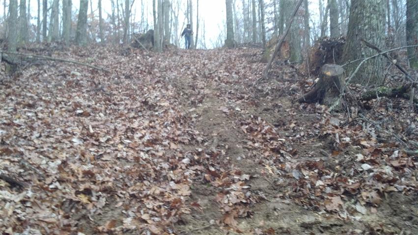

However, when I put the tractor in reverse, the tires just spun in place. I saw quickly that there was no way I was going to be able to drive the tractor backwards back up the hill. The ground was wetter than I had thought. Plus, I had no weight on the rear of the tractor to give the rear wheels some traction. I had removed the box blade the day before in order to move the trailer with the tractor.
Too make things worse, it was starting to lightly rain. We had several days of rain in the forecast and we are approaching the wet season in this area. If I did not get the tractor back up the hill out of the woods within the next couple of hours, I didn't know when it would be feasible to get the tractor out of that spot. It could be months before the path down that hillside dried out. I parked the tractor and ran to get my wife. On the way back, I brought a chain, two steel cables, and an almost useless come-along we bought from Lowes when we rescued my tractor a year ago.
We hooked the come-along to a tree and hooked the cables and chain to the tractor. While turning the tractor tires in reverse, my wife tried to crank the come-along without any success. The come-along could not pull the tractor up the hill. Meanwhile, the rain continued to threaten and we got spurts of light drizzle and the ground just got wetter. I then tried to use the FEL bucket to push the tractor up the hill while keeping the tractor tires moving in reverse. This method worked and could move the tractor 6 inches to a foot when the operation was done successfully. However, the tractor just as easily would slide back downhill into the holes made by the spinning tires.
Thus, I would use the FEL to push the tractor up the hill while my wife cranked on the come-along. The come-along did not help pull the tractor up the hill but it did prevent the tractor from sliding back down the hill. We inched the tractor up the hill in this fashion as the conditions continued to get wetter. Every 4 or 5 feet, we would have to reposition the come-along, cables, and chain when the ran out of come-along cable. I would say we did this routine for about 40 feet until the hill got a little less steep and the tractor tires finally got traction.
I was a very happy camper when we got the tractor out of that predicament! If I had been by myself, I couldn't have gotten the tractor up that hill. I'm not exagerating when I say I don't know when we would be able to retrieve the tractor due to the approaching we season if we weren't able to rescue it when we did. It rained 4 staight days beginning the day I got stuck down the hill. We would probably have needed to hire a tow truck with a winch to come winch the tractor up the hill. I'm assuming a tow truck winch could pull the tractor up that hill but don't really know for sure.

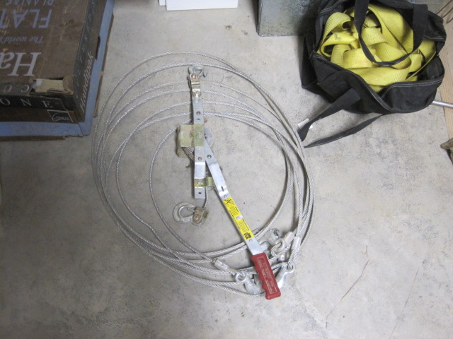

I'm considering purchasing this come-along. Do you guys think it would be able to pull out a stuck tractor?

Yes, any competent tow truck/recovery vehicle operator could winch your tractor out no problem. FWIW, I would never put my wife or anyone else on the working end of that piece of junk come along. That thing is for maybe a lawn and garden tractor, not a CUT. As an example we just broke a 3/8" winch cable pulling logs out of the woods. It was no easy task but it can and does happen. The tension in any size cable is enough to do serious injury to the operator, and there is no time, and no warning to get out of harm's way when the cable breaks. The only way to minimize potential injury from a broken cable is by having something like a heavy jacket or blanket thrown over the winch/come along cable prior to it breaking. That takes knowledge and forethought to be safe when working with something that has the potential to do serious bodily harm.
The other thing one ought to use in a situation like yours is a snatch block- preferably a clamshell type for ease of cable install/removal.
Here is what I use- available from various sellers:
Winch Snatch Block - 4050 Winch Snatch Block
The advantages are several; doubles work result that is, 2x the result for the same amount of effort. And the cable being used gains double it's rated capacity. Allows OP to move to an angle where a broken cable will less likely come back at them.
Some of the clamshell snatch blocks come with a tree protector nylon strap about 5' long x 3-4" wide, to wrap around the tree which one is using as their anchor point.
Here in VT we have the visiting 'flatlander' tourists running their go anywhere Range Rovers and Expeditions, etc. over steep mountain ravines, cliffs etc. and tow vehicles have to do recovery work to pull them back onto the road when their 4x4 goes into the trees and through the woods on the way to grandma's house. It makes for some treacherous rescue efforts.
So maybe next time, better know your equipment and the risks involved, or get the tow truck, neighbor's tractor, or something more suited to safe recovery of your machine.
NO! See my post about come alongs and the inherent hazards of using them. And your question is too open ended. What do you mean by stuck? Can't gain traction or up to it's axles in mud and rocks?
You're better off buying a roll of logging cable 3/8 inch, with the intent of using it to attach to something like a 4x4 truck to pull your tractor out of the 'stuck' situation, from a location where it has traction to ease you out of the hole.
