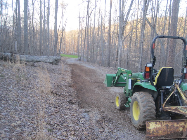

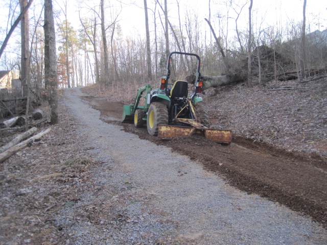

Then I did some badly needed maintenance on the driveway. A spot recently appeared where the water started crossing the driveway. That part needed fixing immediately before it became a big rut.
I borrowed a scraper blade from my dad many months ago but never used it until today. After attaching the blade to the 3PH, I forgot to put the pins in the sway bars. When I realized the blade was swinging too much, I noticed that one of my sway bar pins was missing. I spent 5 minutes looking on the ground for the pin but it was hopeless. I expect that replacing the pin will be a bit of a headache.
Fixing that newly forming rut across the driveway took almost no time. So next I started working on the swell on the uphill side of the driveway. The water path along the uphill side of the driveway had started encroaching on the driveway and needed to be filled in and reshaped.
I have never fine tuned the driveway grading since it was installed. When the gravel was laid down, the gravel truck poured gravel in our swell on the uphill side of the driveway. So we had gravel on the bank on the uphill side of the driveway. I've needed to scrape the gravel off the bank and put it on the driveway where it belongs.
I was curious how well the scraper blade would work for reshaping the swell on the uphill side of the driveway. I debated using the box blade but thought I would try the scraper blade first. Like any tool, it took some experimenting to figure out a technique that worked well. I got better with the blade as I used it. The winter is the wet season here so conditions were ideal for doing this job. The ground was soft from the winter rains but it wasn't muddy.
I was able to reshape the swell rather well with the scraper blade. It seemed to be the right tool for the job today. If the ground had been harder, I might have had to use the backhoe. After I reshaped the uphill swell, I graded the driveway by back-dragging with both the blade and the FEL. That method worked rather well.
attachment.php
Being able to get outdoors and accomplish something did wonders for my spirits. I have more work to do on the driveway. The success of this afternoon's work is encouraging me to get going on the rest of the driveway.
