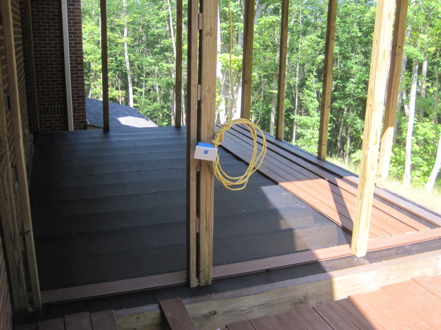

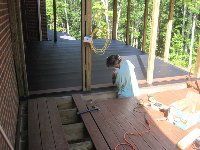

We finally started installing the deck boards. Yay! The first board down was the picture frame board beside the posts. We then used that board to line up the ends of the other boards that run parallel to the brick wall. We have found that the published dimensions of the Trex boards cannot be relied upon. The boards were narrower than advertised so we are one board width shy of what we need.
The published lenth of these boards is 16'. I measured a half dozen of the 16' boards just to get an idea whether or not they would all be the same length. Since they all measured the same, I figured the whole lot of 16' boards would be 16' and 3/8" and accordingly calculated the cuts of the picture frame boards that lie perpendicular to the brick wall at both ends of the 16' boards.
It turns out that only half of the 16' boards are 16' 3/8". The rest are varied lengths up to 1 1/4" longer than the 16' 3/8" boards. I'm fortunate that I planned the layout of the boards using the shorter boards. If I had assumed all boards were the same length and happened to measure one of the long ones for planning the layout, then I would have had a mess when installing boards that were over an inch shorter. You can always shorten long boards but I haven't done this type of work long enough to figure out how stretch short boards.
The only board that has been screwed down so far in the pictures is the picture frame board by the posts. The rest are just lying on the joists.
