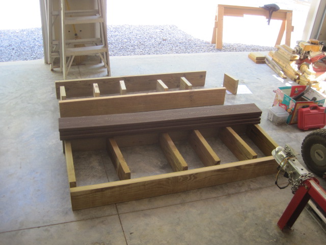

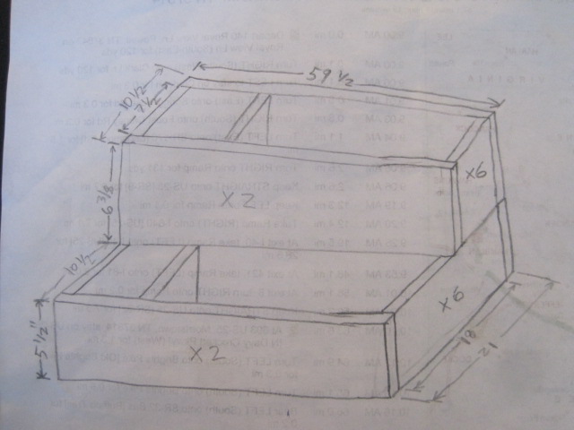

I've been remiss in uploading pictures. I built the porch steps and temporarilly propped them on some wood blocks so we could use them. A friend's son helped me build them.

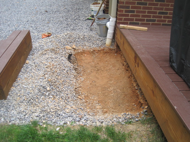

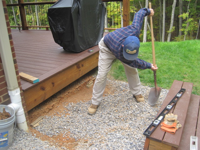

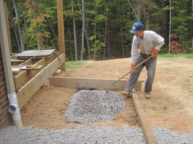

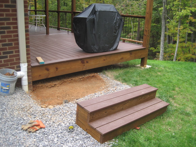

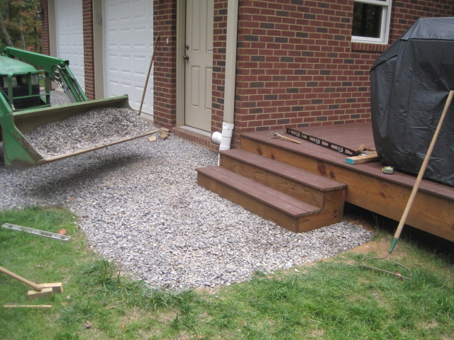

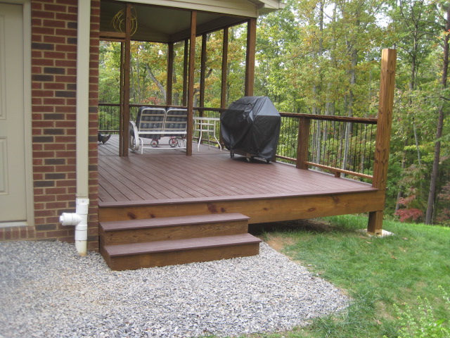

On Saturday I took the day off and went whitewater kayaking. When I got home I discovered that my wife had moved the steps and started the prep work for putting the steps on their final base. She scraped off the gravel and dug out some red clay dirt. I took over and finished the job. I added gravel to provide a level base that would give the steps the correct height. Each step is a 6 1/2" drop. After leveling out the gravel we sat the steps in place. They feel rock solid when walking on them.
Also, you can see that my wife has finished staining the posts, railing, and rim joists. She also stained the steps.
We will take a break from working on the porch and deck for a while. At some point we will install removable screens on the porch.

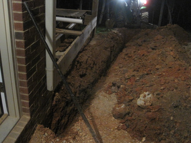

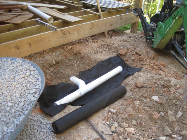

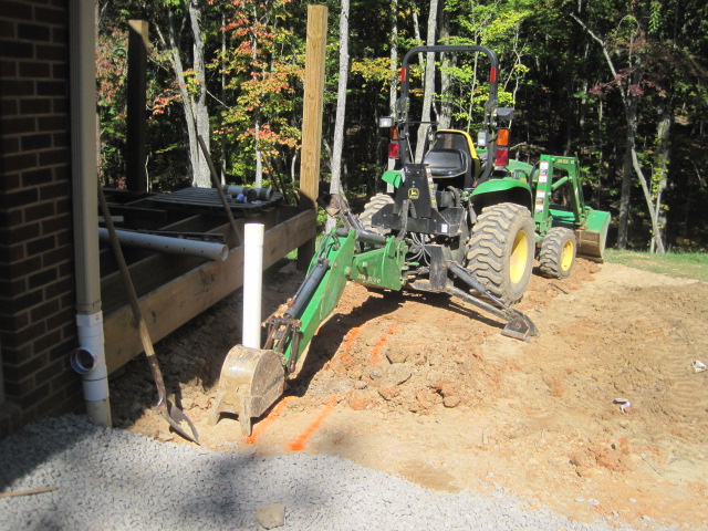

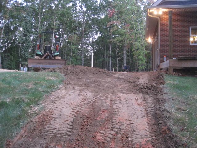

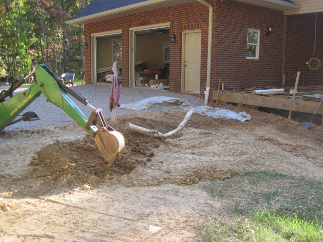

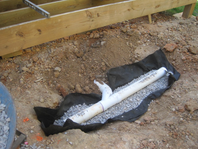

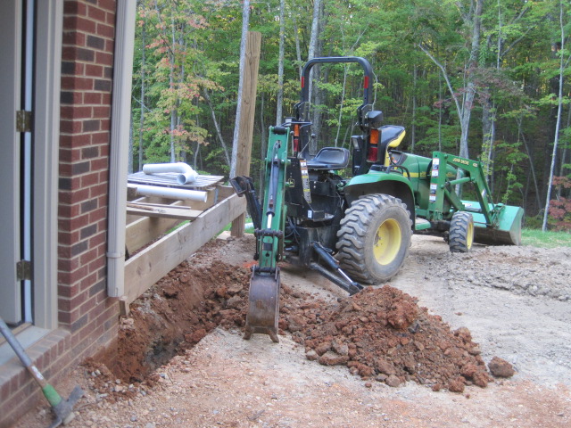

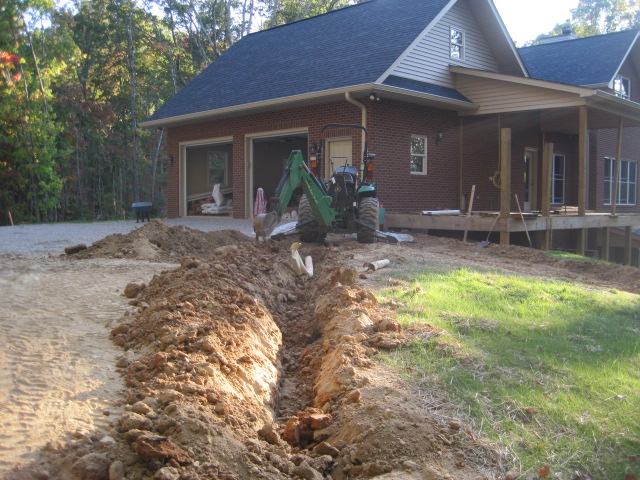

Here you can see what is under the steps. A year ago when we were grading the yard, we reinstalled a drain line for the roof gutters. The grading contractor had installed the drain line under the spot designated for my wife's herb garden. So I dug up the errant drain line.
We installed the new drain line in a better spot.
In preparation for the porch steps, we installed a French drain under the gravel and connected it to the gutter drain line. In this way, the top of the gravel under the steps could be level with the surrounding topsoil but not turn into a mud hole.

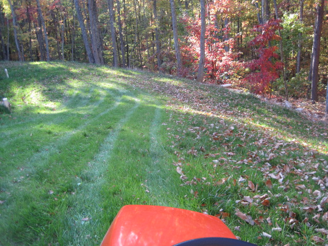

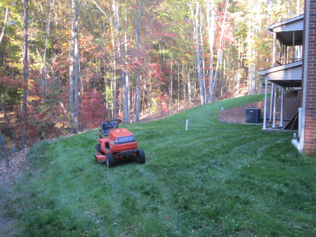

Our new grass has come in quite well. I need to keep the leaves off the new grass to keep from smothering the grass. Here's how I rake leaves. Raking by hand is for the birds.

That tall green grass doesn't help your leaf problem all that much. Your grass is gorgeous, but it sure will catch leaves. I like to keep mine trimmed so a gust of wind will blow the leaves into the woods. Of course, more leaves blow into the yard too, but it makes a good excuse for not raking leaves. I will probably put my mulching adapter onto my mower before cutting again. Like you, I am surrounded by trees.

Yes, I already have leaves all over the yard again. But that's ok. Sitting on lawn mower is much more fun than raking. My wife gets all the credit for the grass. A few weeks ago she put roundup on the onwanted junk that came from the straw we put on the yard when we first seeded last fall. She then re-seeded and fertilized. The yard looks much better now. It has the grass we wanted without the extra stuff. We'll just have to see how it survives next summer.
