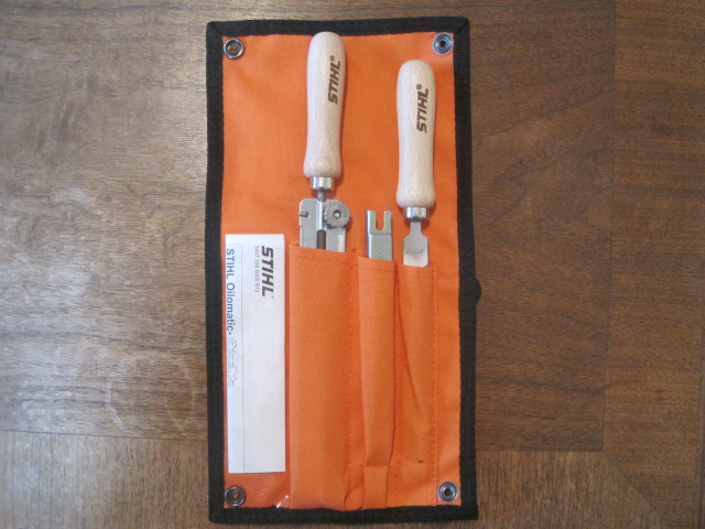

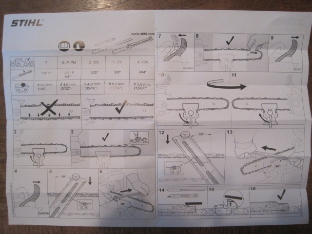

Today I'm going to watch some YouTube videos to help get me started learning to sharpen a saw. When I bought the Stihl sharpening kit, I asked if the kit had instructions and I was told "Yes". Have a look at the instructions that were in the pack.
Does anybody else reminisce about the old days when English was used?
