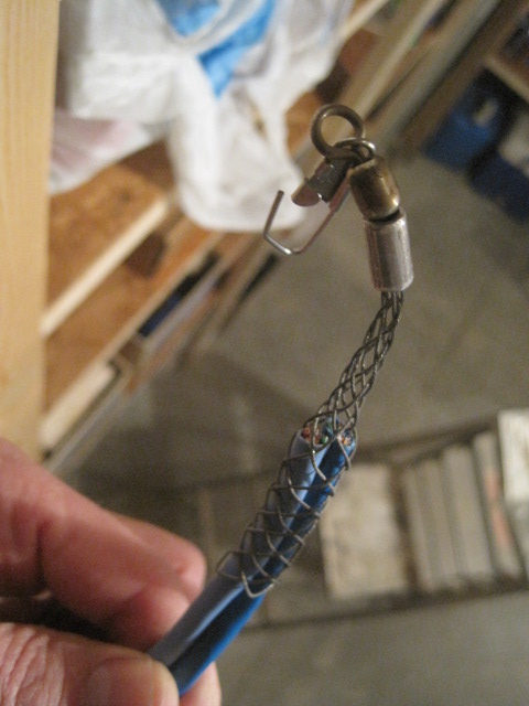

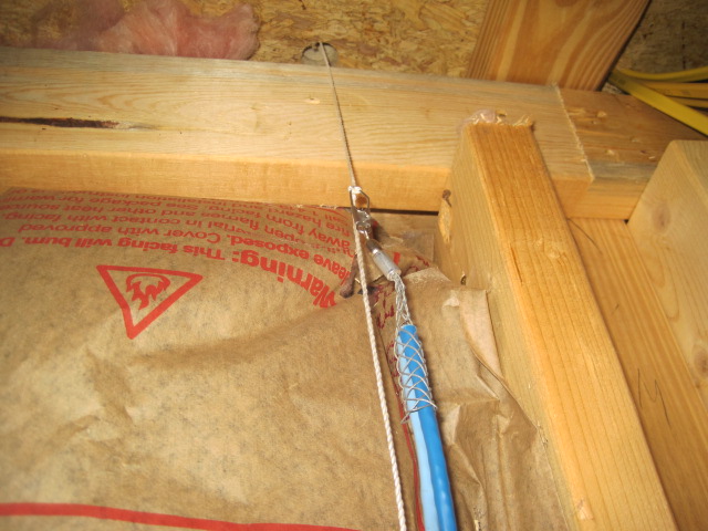

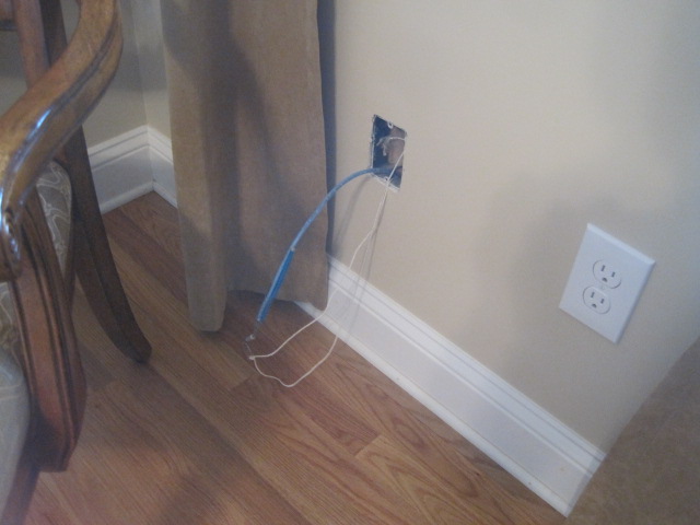

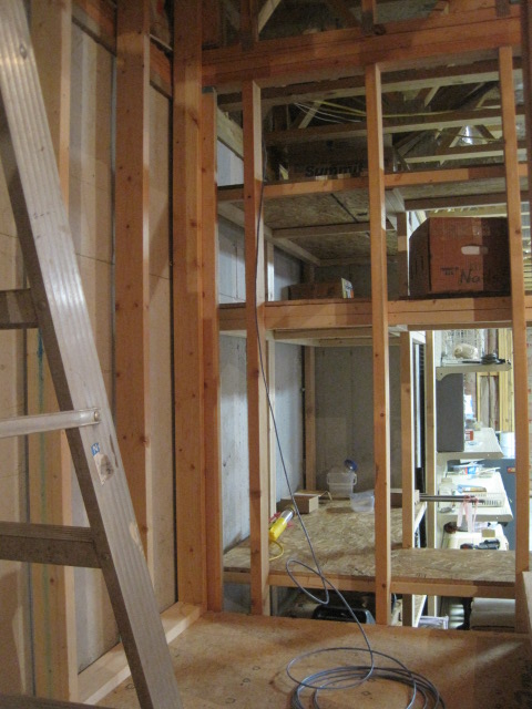

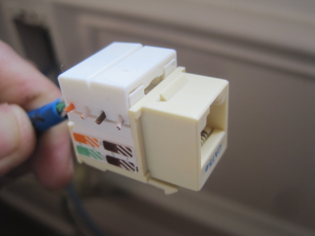

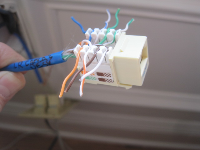

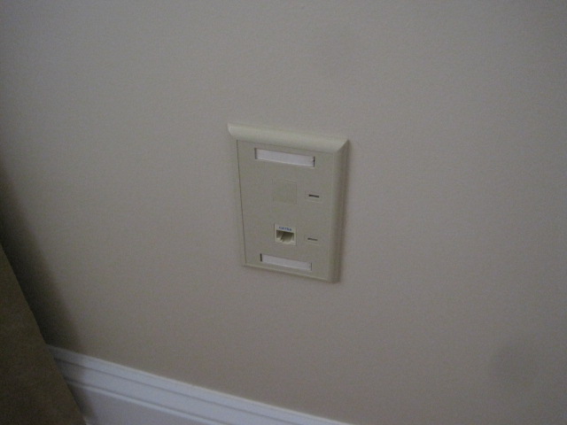

I ran a couple Cat 5 network wires from the office to other rooms in the house, one to the LR and one to the guest bedroom. Wireless network connections are slower and less reliable than hard-wired connections. I eventually want to put a patch panel in the hall closet and run all the network wires to that central closet. So the two wires I just ran are somewhat "temporary".
Running wires through the exposed trusses in the basement is pretty easy but still takes a little time. When we built the house, I installed empty low voltage boxes in all the rooms and left a pull string running through the wall and subfloor.

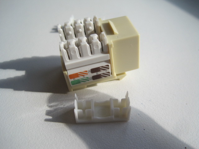

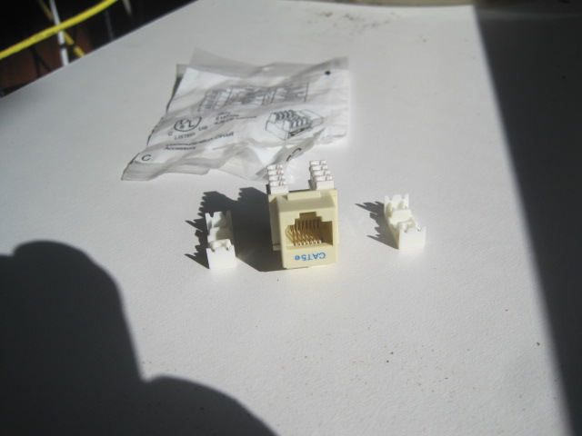

Wiring the jacks just requires matching the wire colors to the color coded wire terminals.
