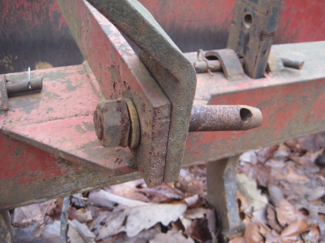

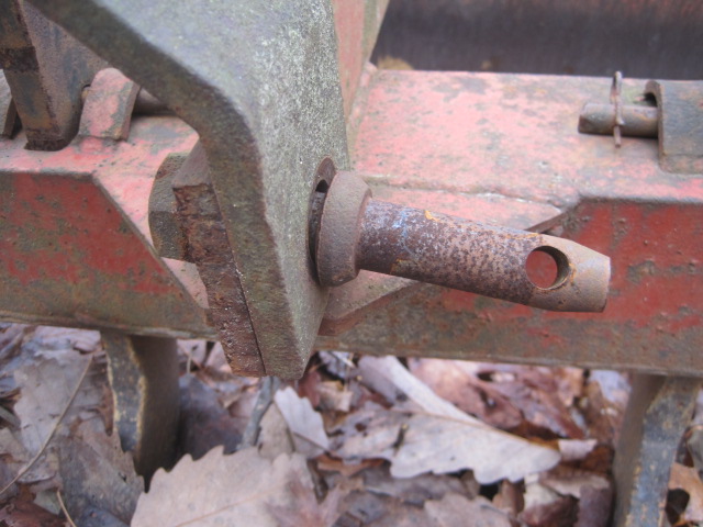

I would also like to fix the 3PH pins on the box blade. One of them is in particularly bad shape; it is loose and is bent. I am talking to the welder to see if he might replace them. I doubt I can get the nut off. Also, it looks like the hole the pin fits through is too large.

You can buy new pins. A 4-1/2" angle grinder will cut the nut easily, if you don't have one, it's a great addition to the arsenal that will get used again. The hole size looks like maybe someone changed to a lower CAT size? There might be bushings easily found to solve that. Tractor And Skid Steer Attachments For All Tractor And Skid Steer Manufacturers would be a place to start.

Here is a handy chart for 3pt pin sizes. That may help to know what to look for. Page 10 shows conversion bushings. You may be able to find pins with a built-in conversion step-up in the portion that fits through the hole in the implement arm.

Thanks Dave. You may have steered me onto the right path. I suspect you are correct in that my box blade originally had a larger 3PH Cat size pin and somebody replaced the original pin with a smaller diameter Cat 1 pin. The bushings I have found for stepping down from a Cat 2 to a Cat 1 are all to long. If I could find a Cat 2-1 conversion lower link pin, I think that would work. The pdf link you provided at ricksagsparts.com showed a conversion link pin, but I don't know how to order it.
I'll have to do some digging. I might just end up replacing the bent pin with another Cat 1 pin. It's not idea but might be good enough.
