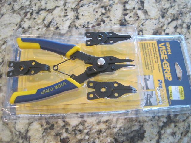

The idler pulley arm was held in place on the pin using a snap ring. You've all seen these things. They look like this:
We have all removed these things by cajoling them off with a pair of needle-nose pliers, screw driver, seance, etc. I figured it was time for be to finally go get the right tool. A trip to the hardware store 5 minutes away resulted in the purchase of a pair of snap ring pliers.
The snap ring pliers made removing the snap ring a simple task. Once I removed the snap ring, the idler pulley arm still did not want to slide off the pin. With much grunting, prying, and some help from my wife with a second set of hands, I was able to get the pulley arm off the pin. The pin and pulley arm joint were filled with gunk that kept the pulley arm from swinging freely. We cleaned the pin and pulley arm. I then greased and reattached the pulley arm. It now moved freely like it should. The spring that causes the pulley arm to put tension on the belt may be a little old but I hope is still strong enought to properly apply tension.
