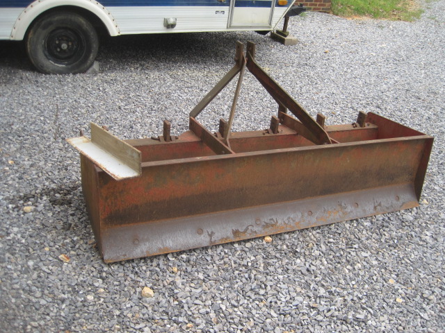

I found this piece of 1/4" angle iron at the scrap yard when I went back to find some heavier metal on which to practice my welding. It's about the size of a brick lentel. However, I keep picking up practice scraps and then thinking of some real use for them which makes it difficult to then use them for practice welding. It's funny now that when driving around, I keep my eyes on the watch for junk metal sitting around. A month ago, junk metal was just junk. Now it's something I covet.
I think I'll cut a piece off of it and use it to make Jinman's suggested ball mount for my box blade. I may not even add the side support pieces shown on Jim's drawing. I suspect this angle iron may support 500 lbs tongue weight by itself.
