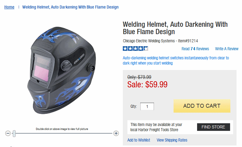

Seeing what I'm doing seems to be my biggest obstacle. I pointed a work light at my target and that may have helped some. While welding, I can't really tell how thick the bead is that I am laying. I also have trouble being able to see where the two pieces of metal meet.
My helmet is auto-darkening. I have the darkness set to "10" which is what the manual recommends for a 90A welder. I'm going to test adjusting the darkness knob while welding to see if the shade control is actually working. I wonder if the shade is too dark.

I have the same hood and use it on the lowest setting of 8 (I think). I also picked up a chceater lens, sorta like reading glasses for welding. This set up is used for my 240volt Longevity mig welder.

Alright obed, we need a pic of you wearing that snazzy helmet. :D
