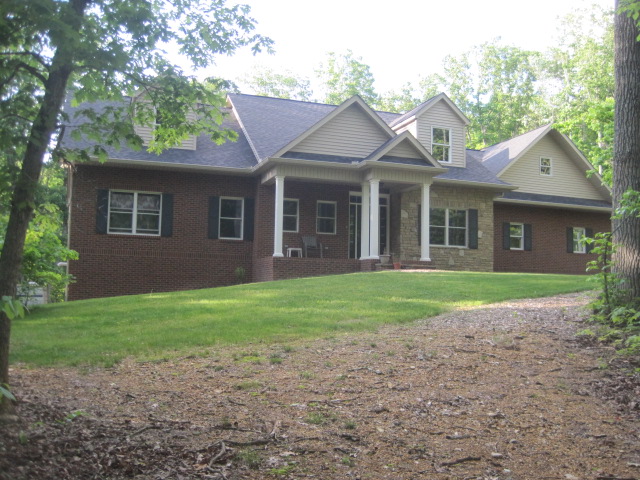

I have followed your thread from the very beginning, and just wanted say that you ave a absolutely beautiful home/property, and a remarkable take on life in general. I have learned a tremendous amount from this thread and thank you for taking the time to post all of it and for continuing it.
I believe you have mentioned before that your roof pitch is an 8/12. Is this for all your roof lines, or just the main? How wide is your main house? I ask this because the roof pitch and roof detail are the last items up for debate in my own house plans. Do you have upstairs space or are the dormers just decorative/skylights? I like the way your dormers look in your recent pictures, and originally didn't think dormers would look right on an 8/12 roof. Yours looks fantastic?

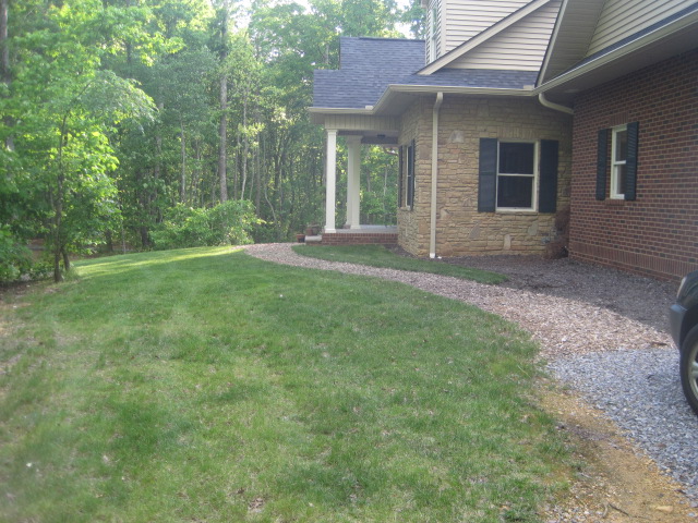

I'm enjoying how green things are with all the rain we've had this spring.
View attachment 318006 View attachment 318008
I really like this view. The garden area can be seen in the background.
Last fall we poisoned and reseeded much of the lawn that had weeds in it that we suspect came from the straw we used when we first planted the grass. Now we have a bunch of clover in the grass. I suspect the grass seed we bought had lots of unwanted clover seeds in it. Can't win for loosin'! You cant really see the clover in these pictures because the grass was freshly cut. However, the clover is there and turns much of the lawn white as the clover flowers.
Dont forget the turkeys you have all over your yard!! They love clover, they could of brought the seed in and pooped it into your yard. Most of the ones i have seen cleaned or the 2 i have cleaned myself (not a good hunter or either i dont have good enough places) have the actual clovers in them not the flowers but the may eat flowers too? But they pick up seeds off the ground and have amazing eyes so i guess they can see the seeds which are the size of a seed tick.
But i agree 24d kills all broadleaf weeds and does not harm grass species. So it will kill your clover, dandilions and other weeds.

you can always spray your lawn with 2-4-d to kill off the clover. I think that it takes at least two growing seasons to get a lawn looking nice. I redid half my lawn last spring, and this year, it looks better, but I still have some clover and other weeds that I'll be working on getting rid of through the year.
+1 on the 2,4d
I've been using it + a liquid fertilizer in the spring for a few years now, and its really helping to keep the clover problem in check.
We may have to check out the 2-4-d. Thanks for the tip.

Thanks for the kind words Tony. The main roof lines are 8/12 pitch. The dormers, front porch, and garage are 10/12. I don't ever have to walk on any of the 10/12 pitch roofs. I do need to go on the 8/12 pitch roof, for example when I clean the chimney and the dormer gutters on the back side.
When we were designing the house, the house designer was trying to get us to build at minimum a 10/12 roof or steeper. So we put some blocks under a piece of plywood on the grass and simulated 10/12 pitch. I could not walk on 10/12 pitch. I was able to walk on 8/12 pitch so thats what we went with. 8/12 pitch is still a steep roof.
The dormers are real. Our upstairs could be finished living space but we only plan to use it as an attic. Our house, including the garage, is approx. 75' x 40' give or take.
IMO, the roof lines on many newer houses these days are too steep, too complex, too expensive, and too hard to maintain. Asthetics have their benefits but they shouldn't completely ignore practicality.
Obed

Thanks for such a detailed answer. I actually went back to the beginning of this thread and read the first 10 pages last night. I hope to break ground in the next month, but I am still waiting on material and sub pricing before finalizing my construction loan. The current cost of lumber is very discouraging!! It does seem to be dropping some though.
My original plan has a 12/12 roof (cape code with 3 dormers). I like the look, but the cost is just too much for nothing more than future space. We have three bedrooms on the main floor and a full basement. I talked to the truss company today about going with a 9/12 over the house and 10/12 over the garage, still giving a nice sized bonus room over the garage but only attic space over the main house. The overall cost difference should be substantial.

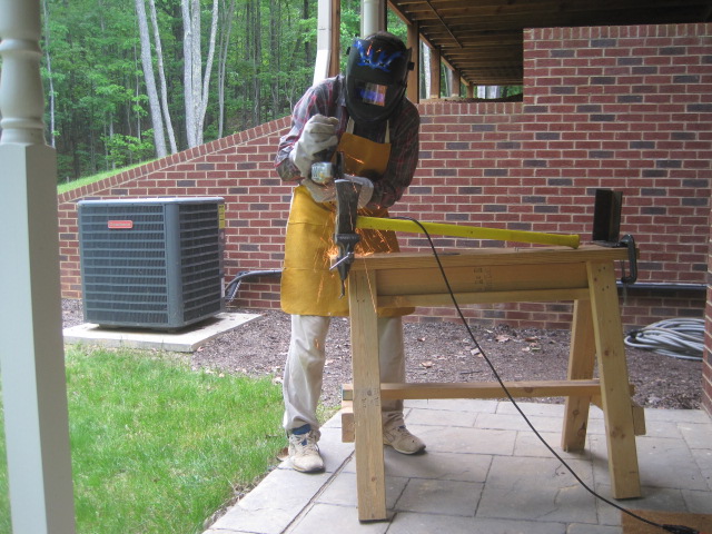

You can buy new pins. A 4-1/2" angle grinder will cut the nut easily, if you don't have one, it's a great addition to the arsenal that will get used again.
Dave,

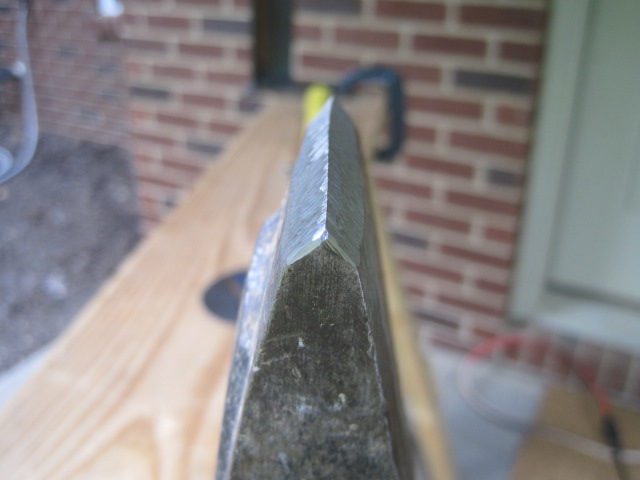

I have to say THANKS for suggesting the angle grinder. I didn't know anything about them until you suggested it. I wish I would have had one a long time ago.
Last night I sharpened my maul with the angle grinder.
