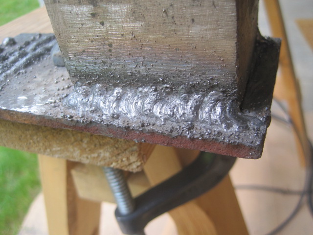

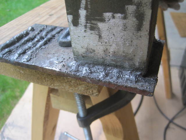

I made some more practice welds using my 1/4" thick pieces. Here's the first one.
Second one.
Third.
Fourth
Cutting off the practice welds wore out a cutting wheel.
Fifth
Sixth
My last one looked really good to me.
I probably should have done some more to try to burn into my memory the technique that worked. However, the weld looked so good to me, I didn't want to grind it off so I stopped.

That series of welds looks much, much improved. Congratulations!

Welds are looking better.:thumbsup: Try watching CL for a used stick welder. There are ton's out there, and they often go for under $200 here. Find an AC/DC if you can. Then get some rods and practice with that. You are getting a better idea of what looks decent now, so stick should not be too far of a reach. You won't have to worry about not having enough power with any decent stick welder out there. Mind you I do NOT mean one of those 90A HF specials like you have now. Something like an old Lincoln Tombstone or the Miller Thunderbolt or one of the newer Hobart Stickmates. Millions of them out there. Most stick welders are 220V and should give you over 200A capacity. Once you buy the welder, the rods are very reasonable to buy in smaller quantities.
Either that or you need to get a bigger wire feed. The one you have just does not have enough power to do much, as you have found.

still seeing quite a bit of little dimples in the welds. Could be an indicator of porosity... in the mig world I generally turn up the shielding gas flow to fix it, but you really can't do that on the flux core machine.
My guess on whats changed... slower wire speed, and you've slowed down your travel speed. One of the new welder faults is they try to complete the weld too quickly and don't stay in one place long enough to get the base metals to melt.
You are exactly right. This was exactly my problem when i first started. I was just moving across the seam in a straight like like i was caulking, I ended up with a splattered mess.
