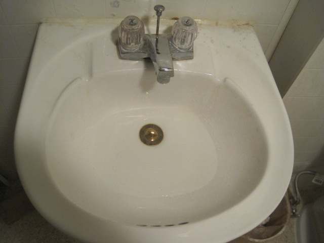

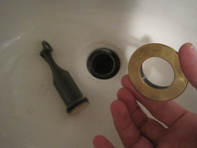

I replaced a sink drain in the rental house. Plumbing is definitely not my gifting. On my first attempt, I did not use any plumber's putty which resulted in a leaking sink. I got it right the second time using copious amounts of putty.
I still haven't finished fixing the shower so the house is still empty. Granted I haven't killed myself working on the house but I have spent almost every Saturday there for a while. I am looking forward to getting my Saturday's back so I can cut some more firewood.
