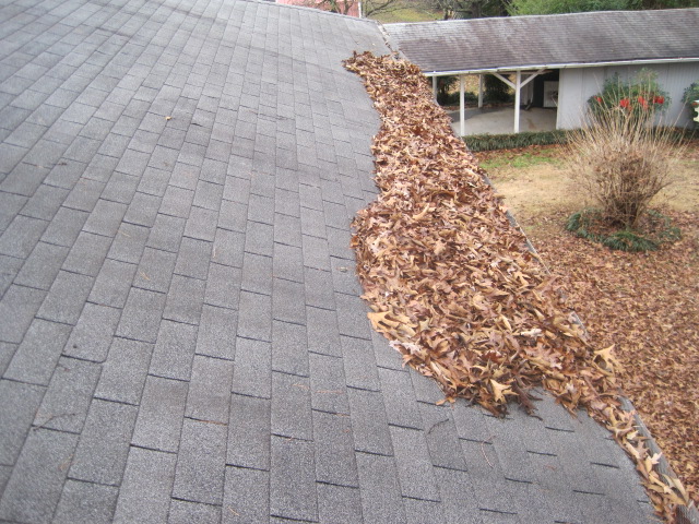

I cleaned out the gutters on the rental house. The rental house has gutter guards. While the guards did keep most, but not all, of the leaves out of the gutters, the gutters still needed cleaning. One side effect of the gutter gards is they caused leaves to settle on the roof.
By the time I swept the leaves off of the roof, detached the leaves that were caught on the gutter guards, and removed the leaves and debris that made it into the gutters, it seemed to take more time to clean the gutters than if the gutters had no guards.

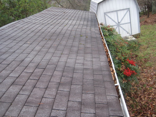

Here's the roof of the detached carport. These gutters do not have gutter guards. Notice that there are no leaves settling on the roof. Cleaning the gutters around the carport was much quicker than cleaning the gutters on the house that have gutter guards.

Depends on the type of gutter guards, wind, orientation, roof pitch, prior maintenance, climate change, and location of trees to the roofs in question.

Coyote,
Yes, gutter guards are a mixed bag. At the rental, the guards did keep most of the stuff out of the gutters even though the lot has lots of large trees. So the gutters did not clog even though lots of leaves fell on the house. So having the gutter guards bought some time before cleaning the leaves and debris of the roof and gutters. However, these guards did not prevent the need to maintain the gutters because they caused a "leaf" dam on the roof.

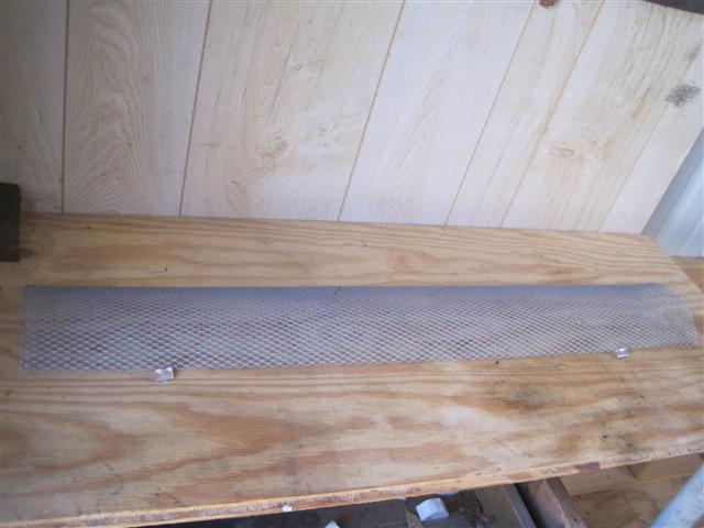

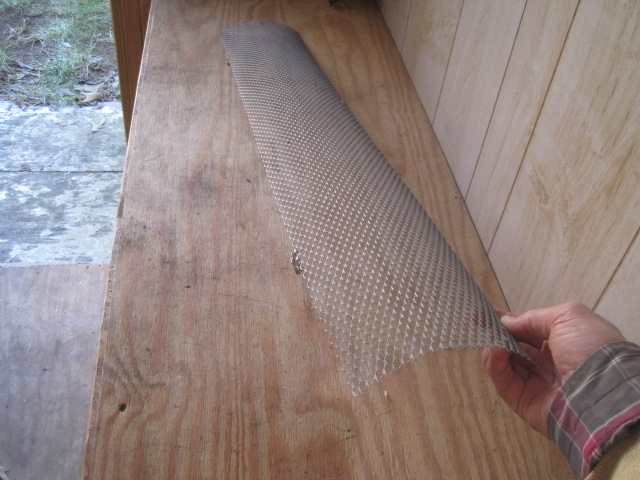

Obed,
Show pics of the leaf guards, I bet they're not the kind that actually work as intended.
Here's what I had on my CT property roofs.
Roof Gutter Design, Roof Gutter Guards, Gutter Designs, Tested for Strength
Coyote,
Here are pictures of the one of the gutter guards on the rental house. They did a reasonably good job of keeping leaves out of the gutters. However, they tended to keep the leaves from sliding off the roof. The leaves would get caught on top of the gutter guards and then pile up on the roof.
