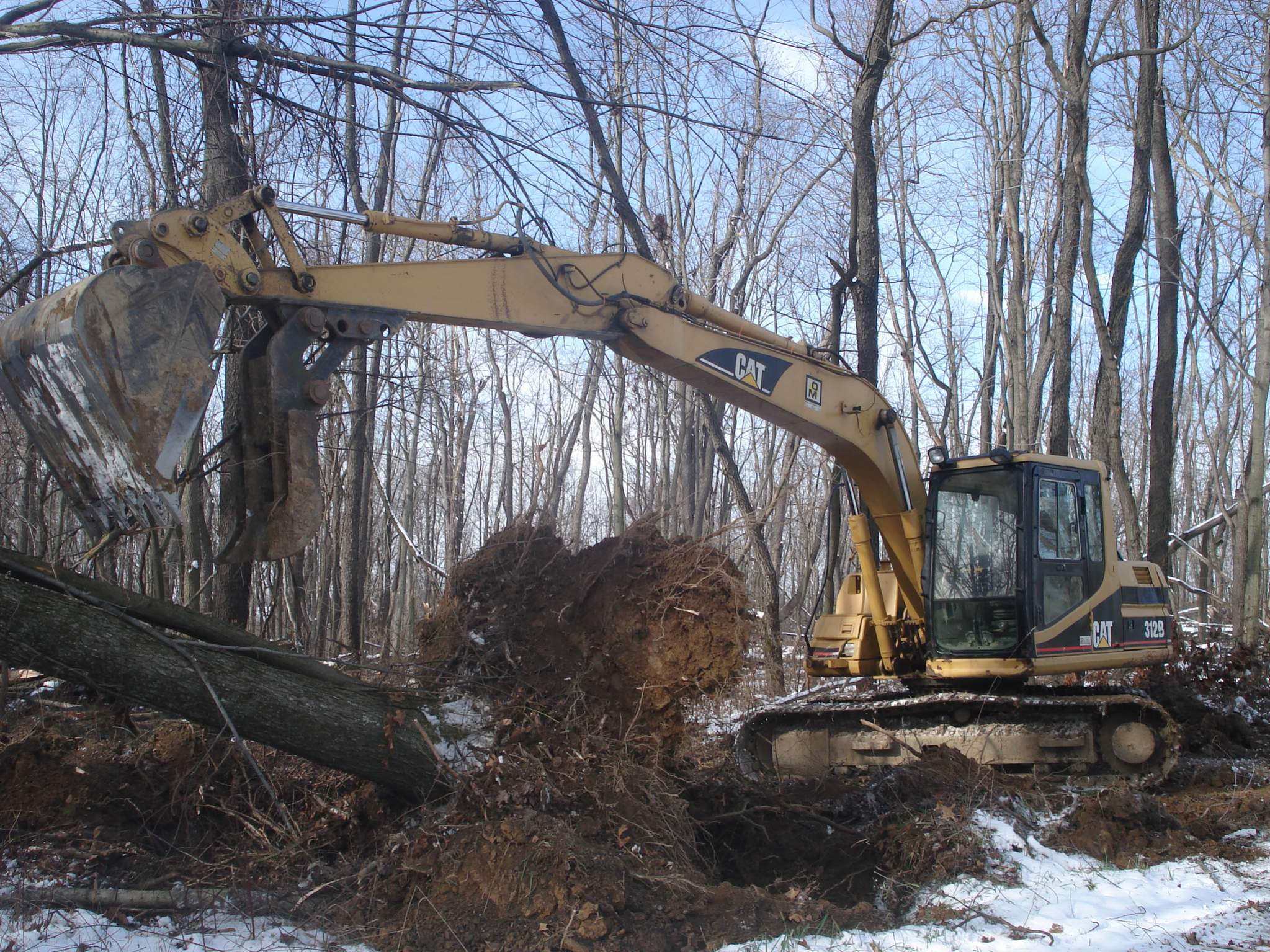

Hey Coyote -
I see you feel so strongly about this, you posted it twice! :D
Point taken regarding endorsing the procedure to those perhaps not up to the task, should we now start offering disclaimers?
If you read thru the thread which Obed refers to, this same conversation came up with other posters. Some are, and probably always will be, dead-set against the procedure. And, you're certainly entitled to your opinion of "foolish endeavor", "seriously dumb thing to do", etc.
This same thread also has solid points from Eddie Walker supporting the use of backhoes for felling trees, as well as a book on the subject that Curlydave mentioned....while it may not be a professional logging author, it seems to me there is a accepted practice among the general population.
I have been cutting trees down my whole life, and am pretty familiar with chainsaws....and also have pushed trees over with my 32HP TLB.....and my dozer....and excavator. The excavator is the way to go, definitely the safest and easiest. I guess I'm in the camp of getting the whole tree over with stump attached being far easier than cutting and digging the stump out....and I know from experience, having done both hundreds of times.
This is a great forum for sharing ideas and practices, and perhaps we should guard our words and recommendations....but to ambush a particular procedure as completely unsafe and dumb does not move us forward as a community.
Just sayin....
I'll leave you with a pic of my choice....:)
