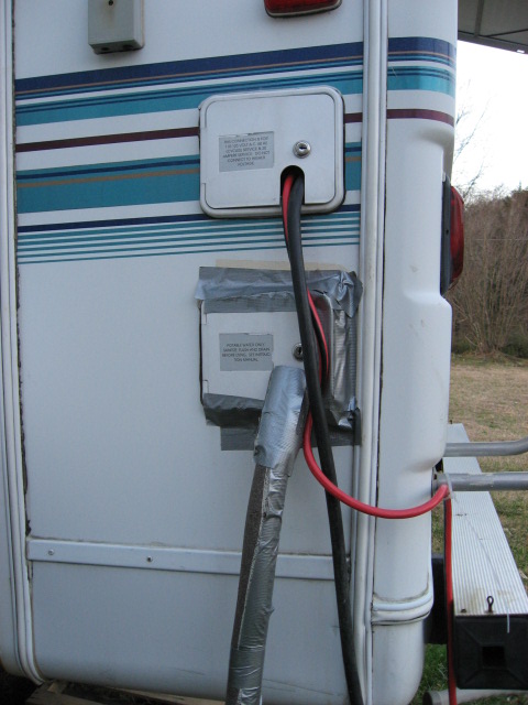

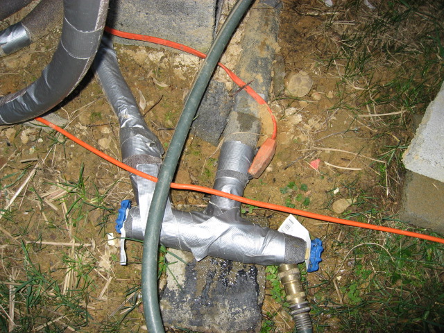

Our 5th wheel is 36 ft long with one slideout. We insulate the waterhose from the spigot to the camper and run heat-tape inside the insulation. The coldest weather we've experienced was 7 degrees. The water did freeze on us that night. With temps in the teens we do pretty well without freezing as long as we drip the water in the sinks. At times, the bathroom froze when the kitchen did not. We found a susceptible spot in the "basement" (the storage area below the bathroom) where the pipes tended to freeze. On very cold nights, we place a small electric heater in the basement and that normally keeps the bathroom water from freezing. We run two oil filled electric space heaters in the camper living spaces. Our propane furnace has developed an intermittent noise in the fan so we rarely use it.

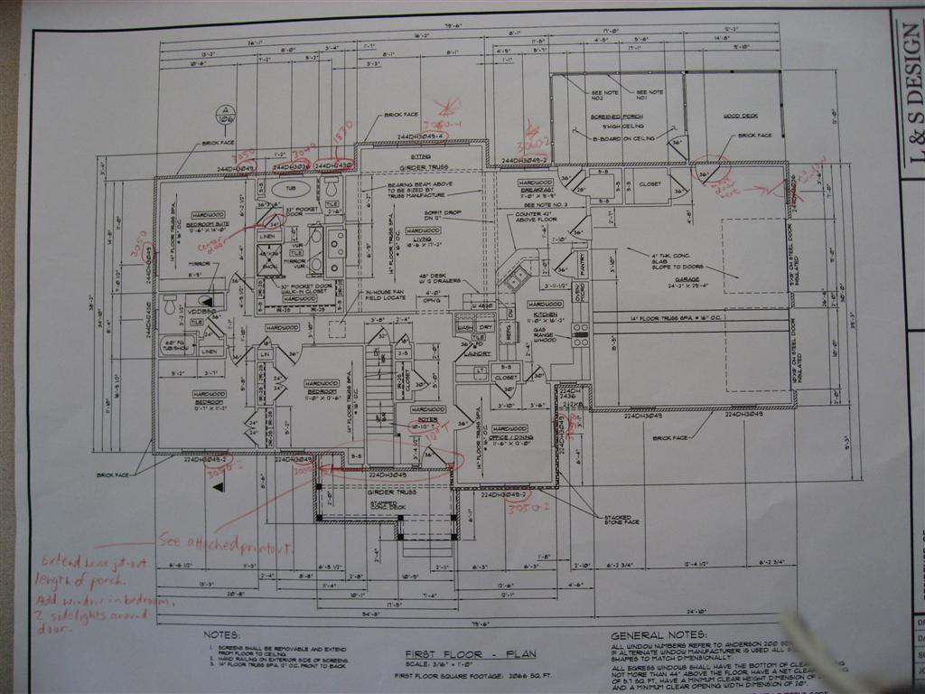

My wife worked with a designer and created the house plans. It took the better part of a year. After finishing the plans, it was decided that the house was too big and she started over. The designer was very patient. He is a retired draftsman who was in no hurry. So the second house plan was finished. Then the wife got pregnant and guess what? She changed the house plans again. We were going to have 2 bedrooms on the main floor, plus a dining room with a closet that could be called ad 3rd bedroom. If we ever finished to attic or basement, we could get more bedrooms. However, with Junior on the way, the wife wanted all 3 bedrooms on the main floor. So the house plans changed again.

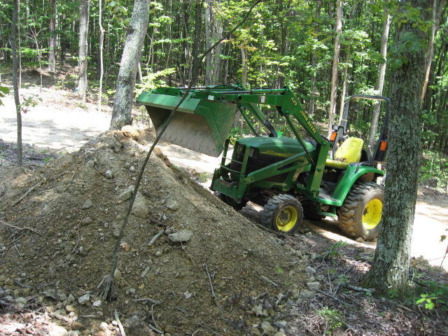

The tractor has really come in handy with the house project. I really don't know what I'd do at this point without it. I'd have to pay someone to do all kinds of little things. For example, I needed to move this pile of topsoil that was scraped off the house site to another place out of the way. Now I can use this topsoil at my leisure. That wouldn't have been the case without the tractor.

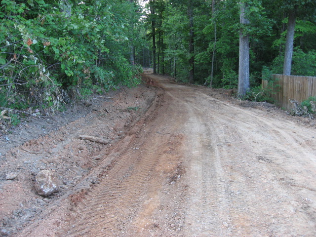

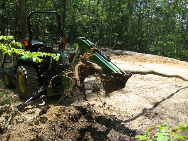

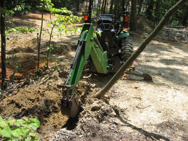

I needed to prep this spot so that the well drillers could park their rig and drill the well. Once again, the tractor made the task not just easy, but also fun. These pictures were taken in August of this year (2009).

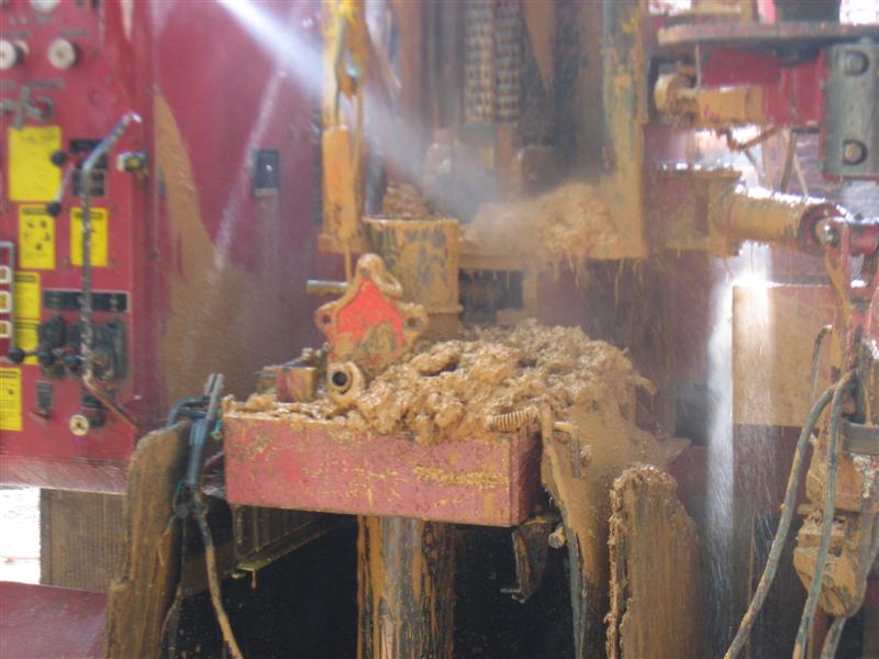

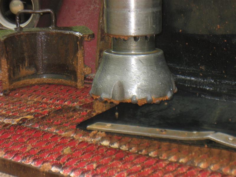

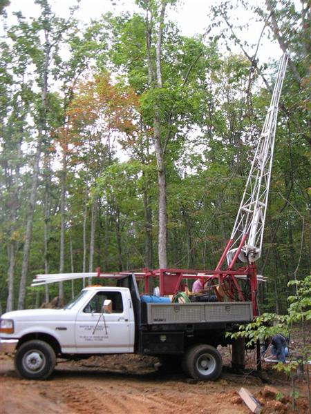

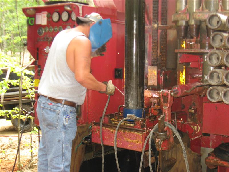

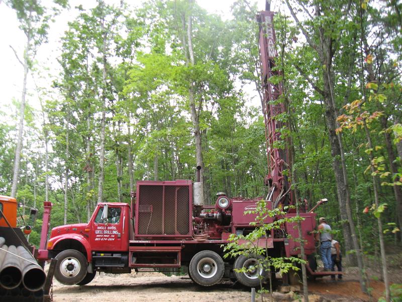

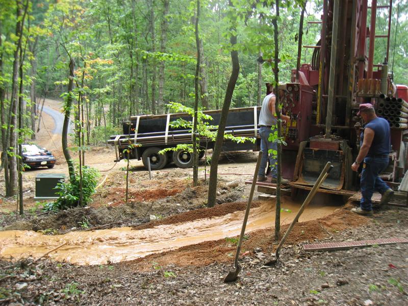

In September, the well was dug. We have the option for city water but we prefer well water if the water is good. We hit good water without iron or sulfur. Yay! At one point during the drilling, some pressure in the well sent up a bunch of mud out of the well. You can see the results. The well is a little over 300 ft deep. The steel casing goes down 200 feet. Cost was somewhere between 10K and 12K including drilling, materials, pump, pressure tank, and installation.

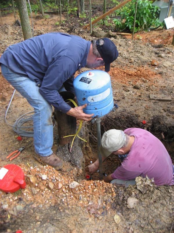

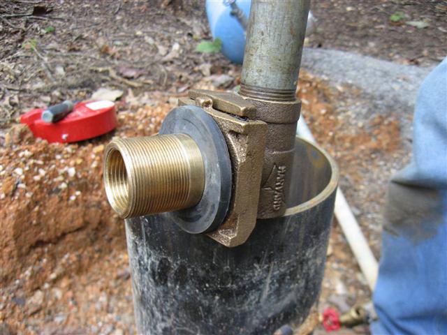

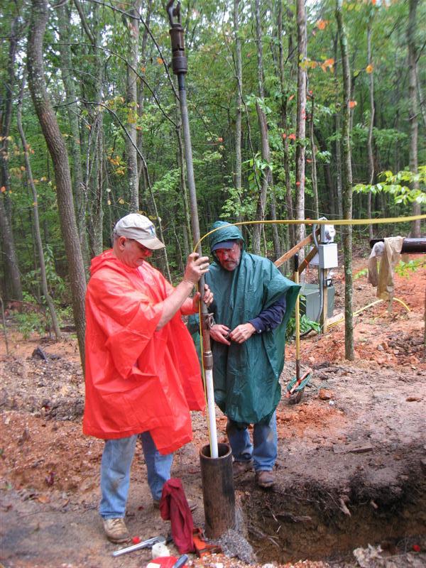

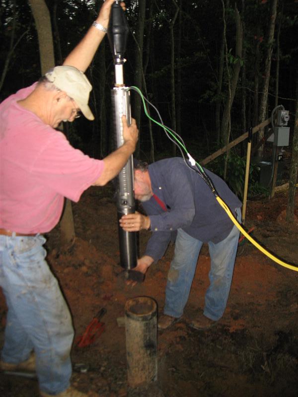

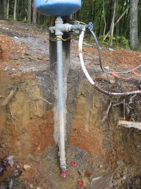

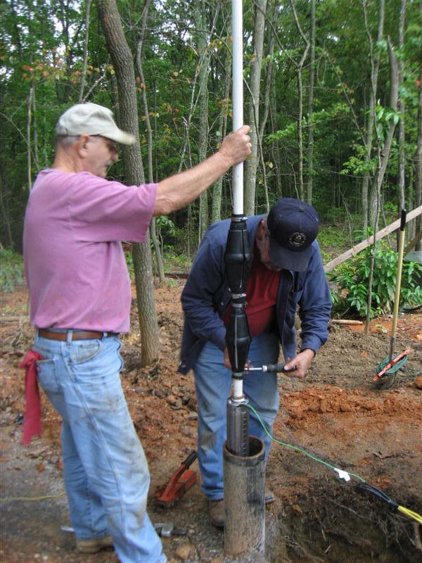

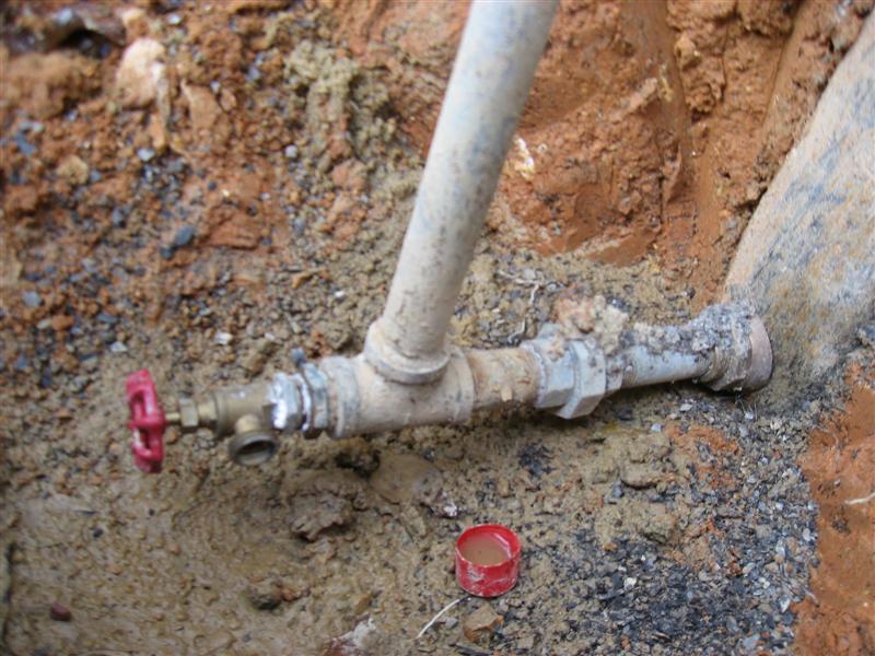

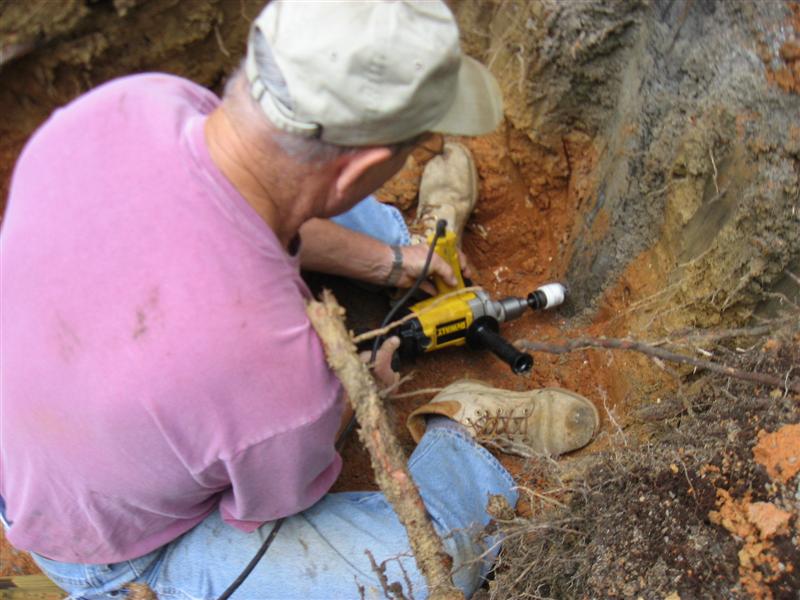

Here are the pump installation pictures. You can see the pitless adapter that runs through the pump casing 2 feet below. The pressure tank is temporary. Once the house dried in, a permanent pressure tank will be installed in the basement.
