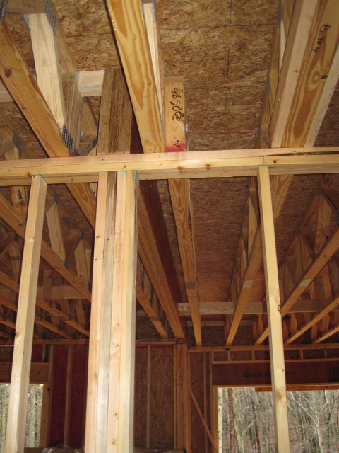

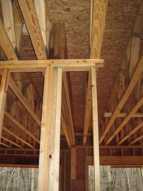

If you look above the 4 studs nailed together you can see some long LVLs between the trusses. These LVLs support the room in the attic beneath the large dormer on the back side of the house.

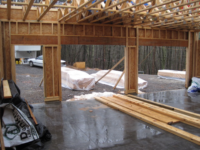

You can see a very long (about 27 ft) single LVL over all the garage doors. The picture shows 4 temporary vertical 2x4's nailed on the outside edges of the big garage doors so it's not obvious that that LVL is one LVL. The reason for having a single LVL is to hopefully prevent the garage from caving in if someone backed into the narrow section of wall between the garage doors.
If you look above the person door, you can see a wider section between the trusses. These two trusses are 24" O.C. in order to provide space for the pull-down steps to the attic.
Do you have much wind at your site? The single header gives more resistance as well. However, it would have been even stronger if the header extended all the way to the side walls.
If you google "JLC narrow wall bracing method" the first result is a good article by Carl Hagstrom that expains why it should be done. And how to do so cheaply.
The way your garage is currently would be an issue where I am located. Not sure for you.
