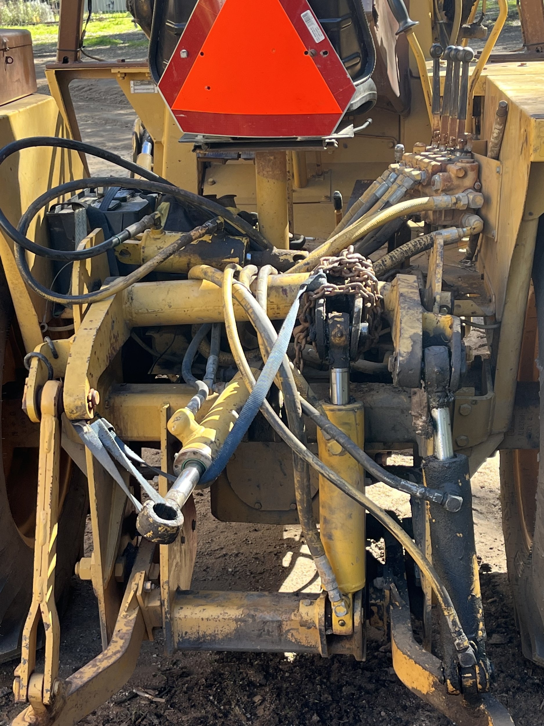

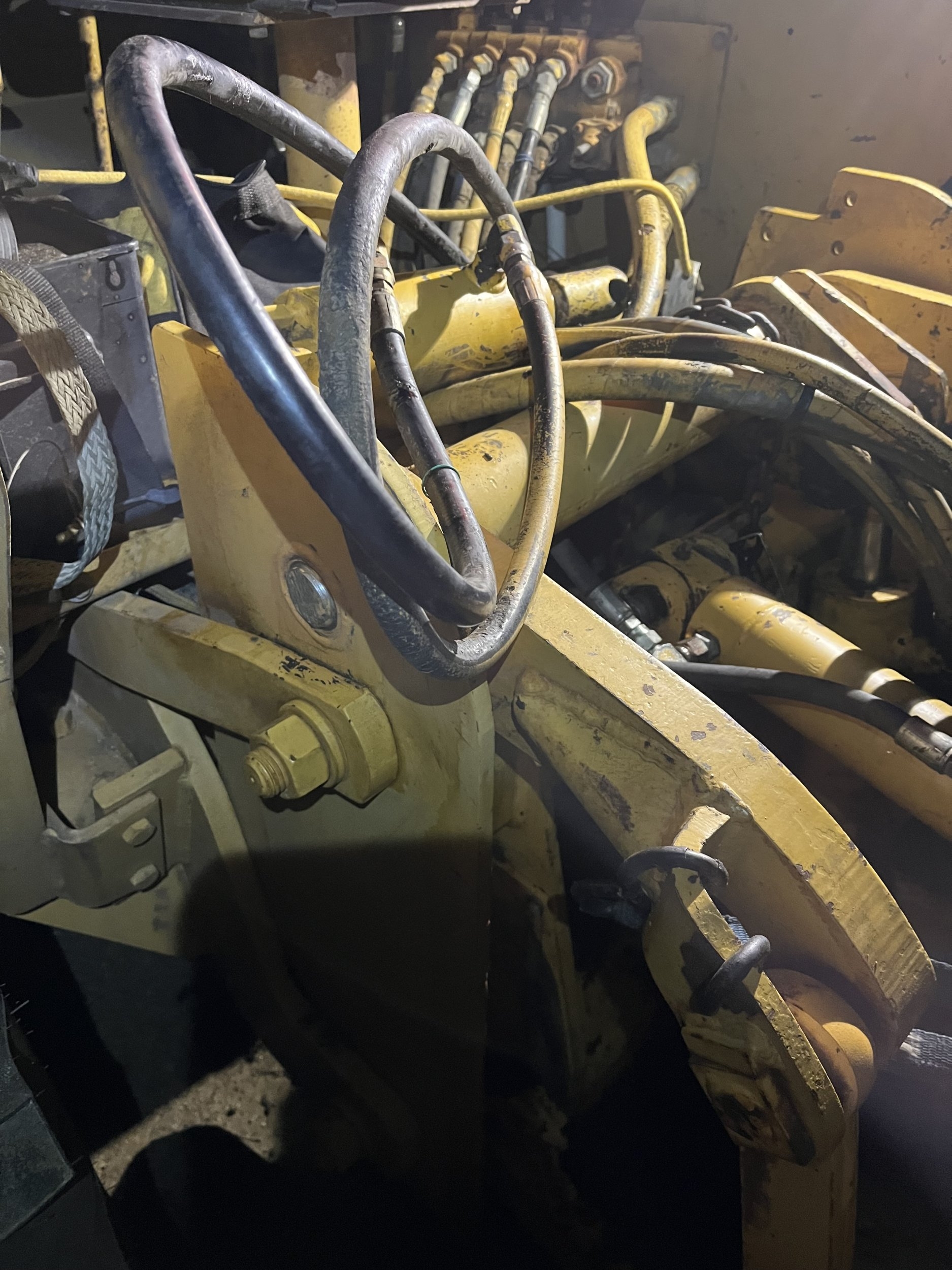

Case 480 F LL

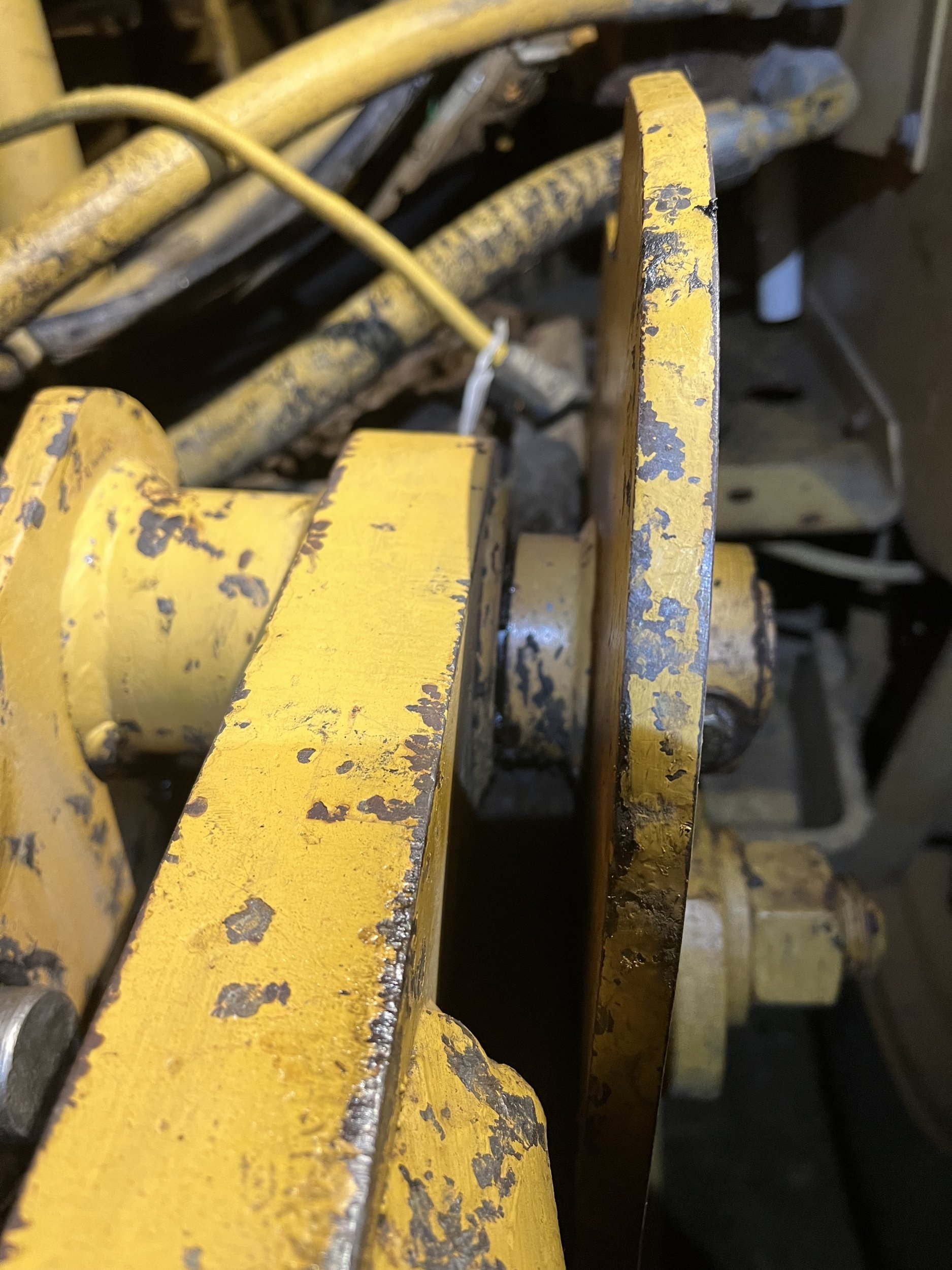

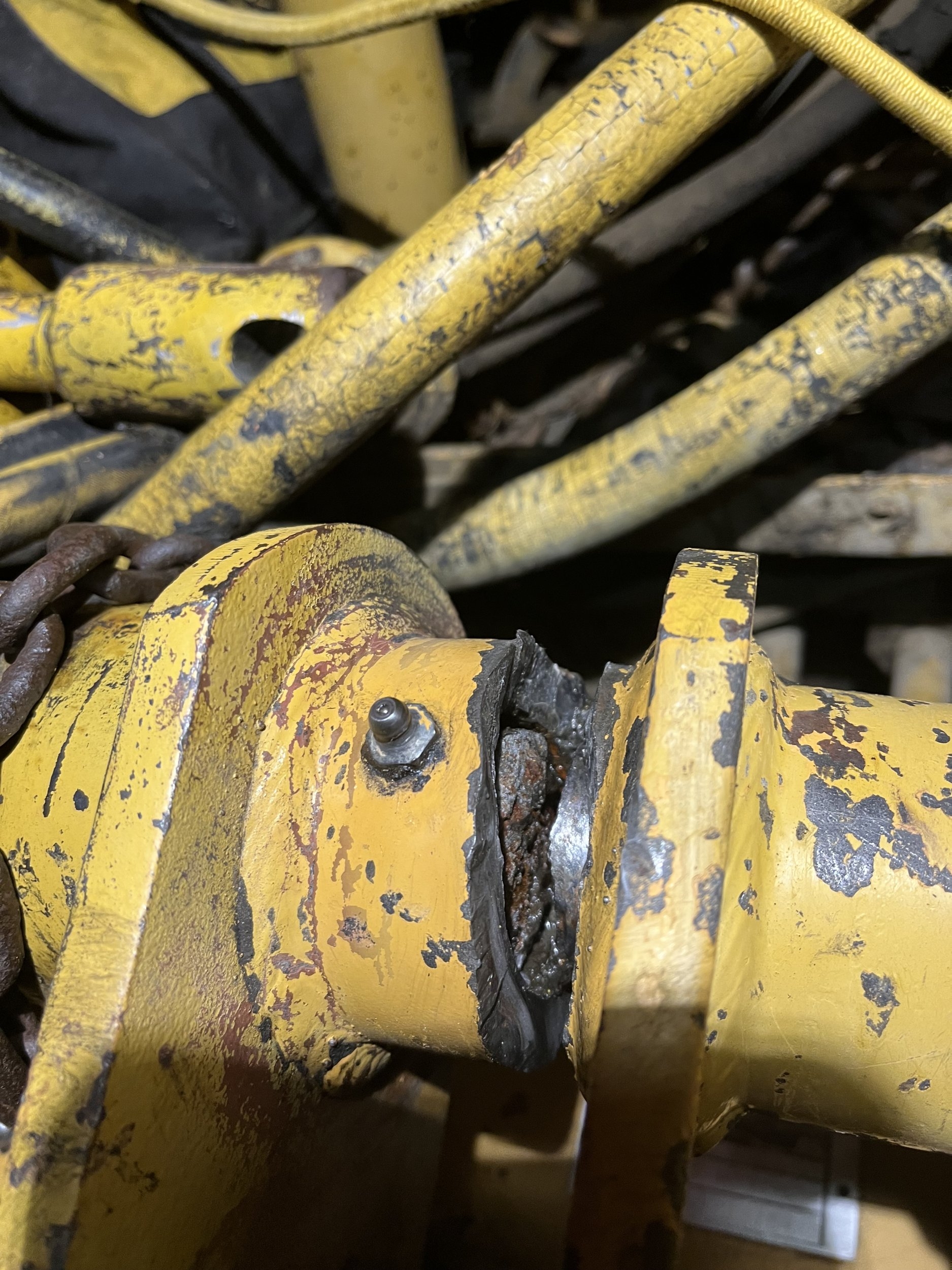

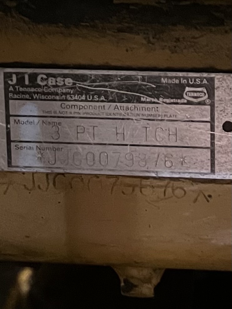

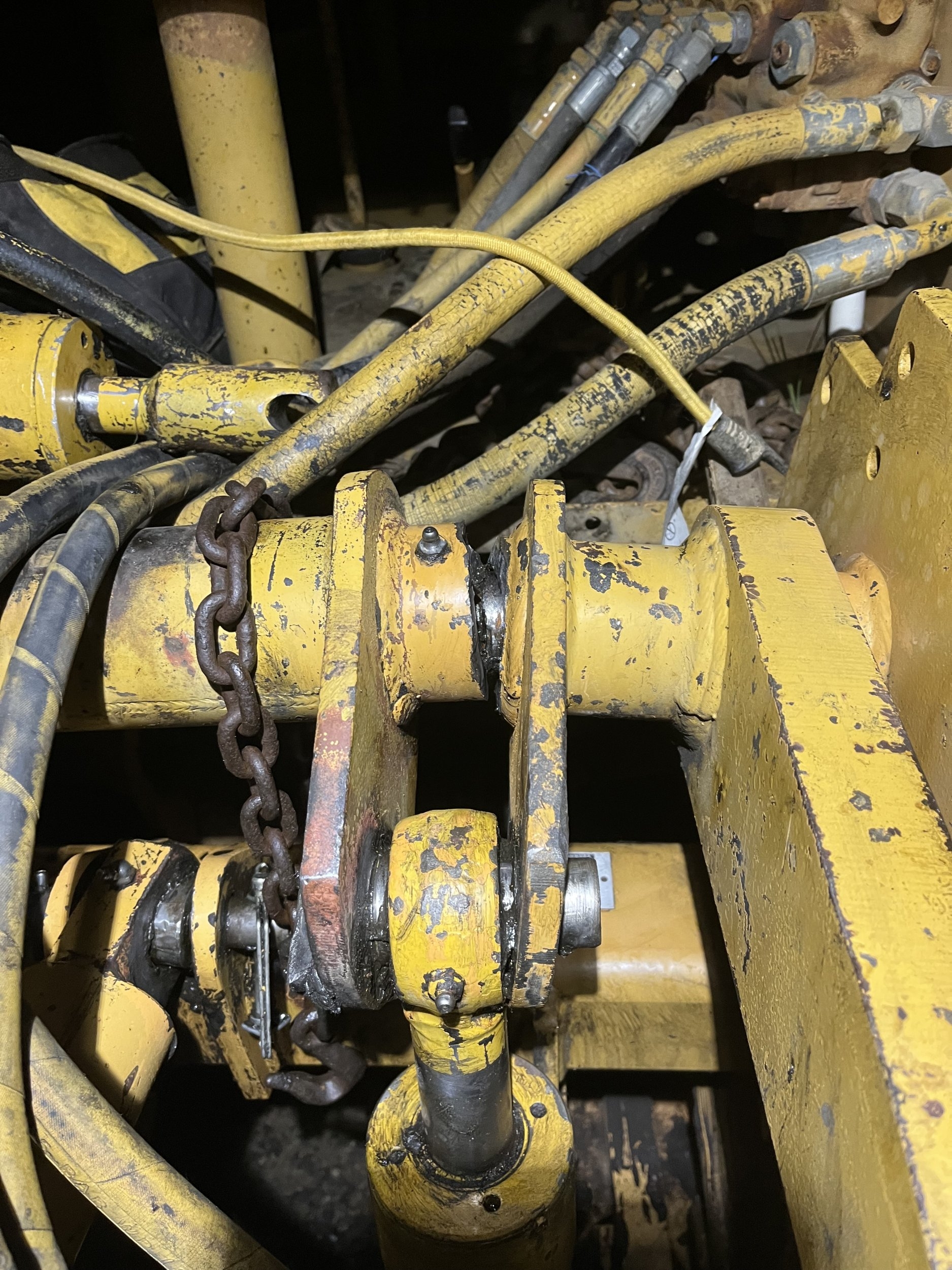

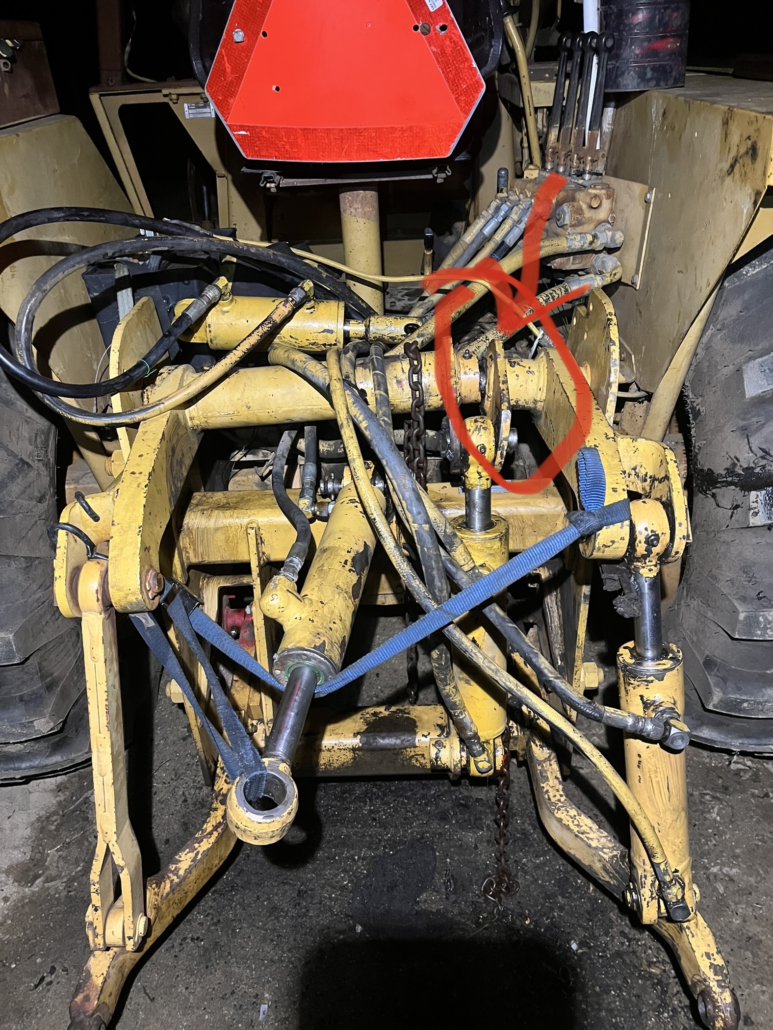

Does anybody know if you can take this rockshaft out without taking the tire off? Sheared the housing and shaft? Having a heckuva time driving it out and it’s looking like I got to take the tire off now I already got a broken back don’t have a crane truck can’t even find the part New or used in the whole US trust me I’ve had people say they could find it and they can’t finally found one of the guys shipping me because of my location but I want the right one anyway tracker was only made for five years 89-93 was born a backhoe I need my Skiploader back Grammy not real great grading roads with the front loader that was wore out 30 years ago. I’m not talking about the loader lol.

That doesn't look like fun. I think you better call up some friends.
A machine shop should be able to turn a new shaft from high strength steel.
I think the housing can be ground out and welded back.
   / At Witt’s End! #4
If you expect to keep this mule you need to remove the wheels and the fenders first to remove the entire assembly
opposite of how it was installed at the factory.
After that you need to find a tractor repair shop to remove the broken cross shaft and possibly line bore it and
install new properly machined bronze bushings that have been machined with grease passage grooves and
machine a high quality steel bar stock cross shaft on a lathe and also mill grease passage grooves in it as well.
