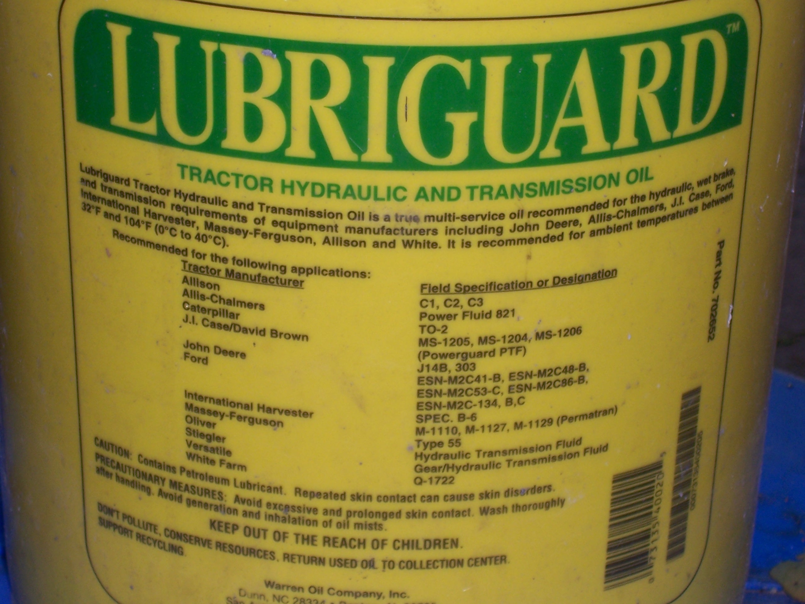

I discarded the Bucket Yrs. ago but found this old pic. I used on TBN of all places around 2008. :rolleyes: From TSC. 32F was hard to believe.
