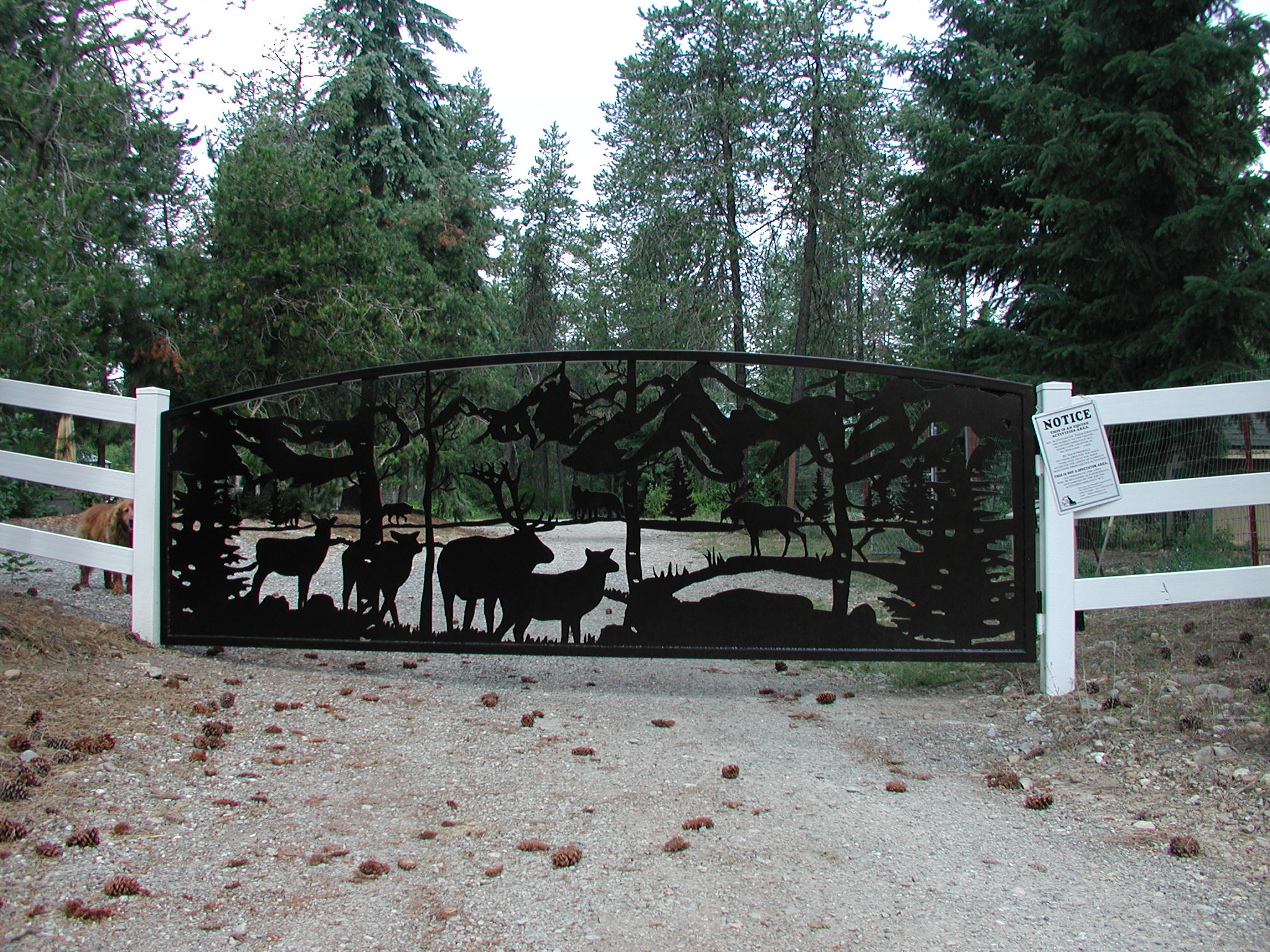

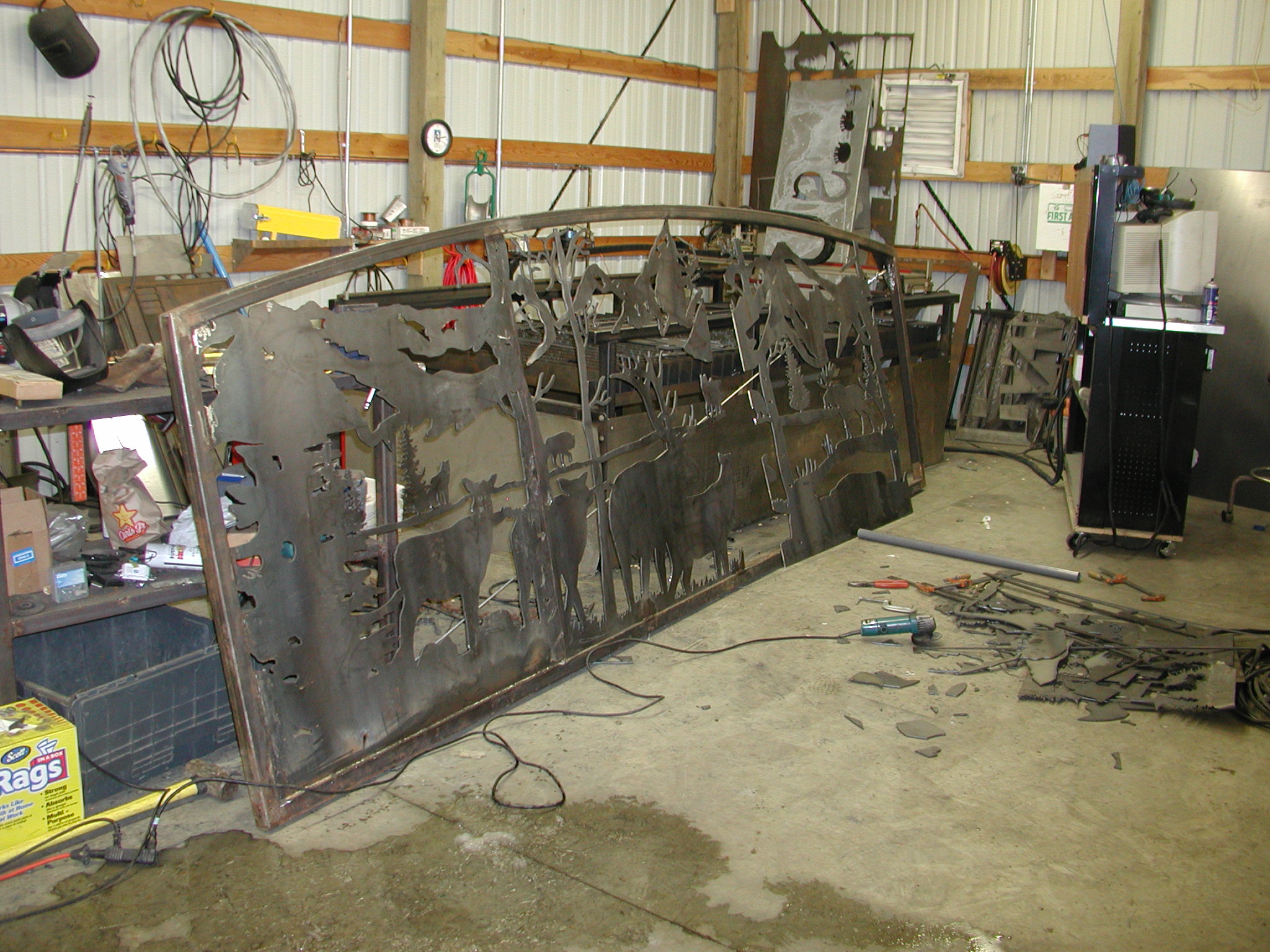

i have a similar 125,000 btu hanging unit...i use it for an hour to knock off the cold, then turn it off and can work for hours out there. and oh yes...i love my plasma cutter cnc table.....its comes to the rescue so many times over the years. its hard to see the table thru the gate, but its a 4x10 unit. heres a gate i built last year.

What a fence. Tom
