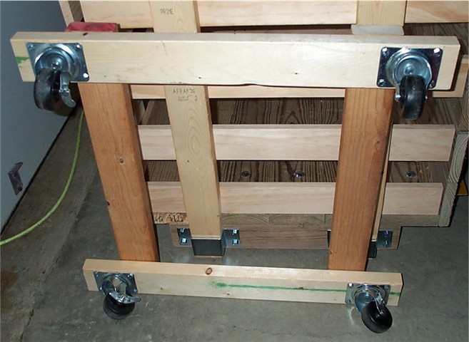

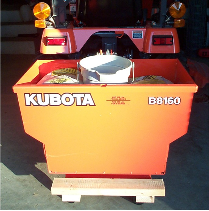

I made Dollys for most of my implements and it makes them easy to mount and to push them back in the corner when you remove them. See attached photos.
