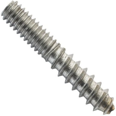

I'm a bit late but here's what I did. I got two copper pipe hanger clamps. They come in two different styles. The first uses two screws, one on each side and the other uses one screw and the outer half swings open. The inner half has a threaded hole and I just picked up a stud from the local hardware store that's half wood screw and have threaded rod. I put a piece of plastic inside the loop to cause enough friction so the umbrella could be turned but wouldn't spin on it's own. The copper looks nice.

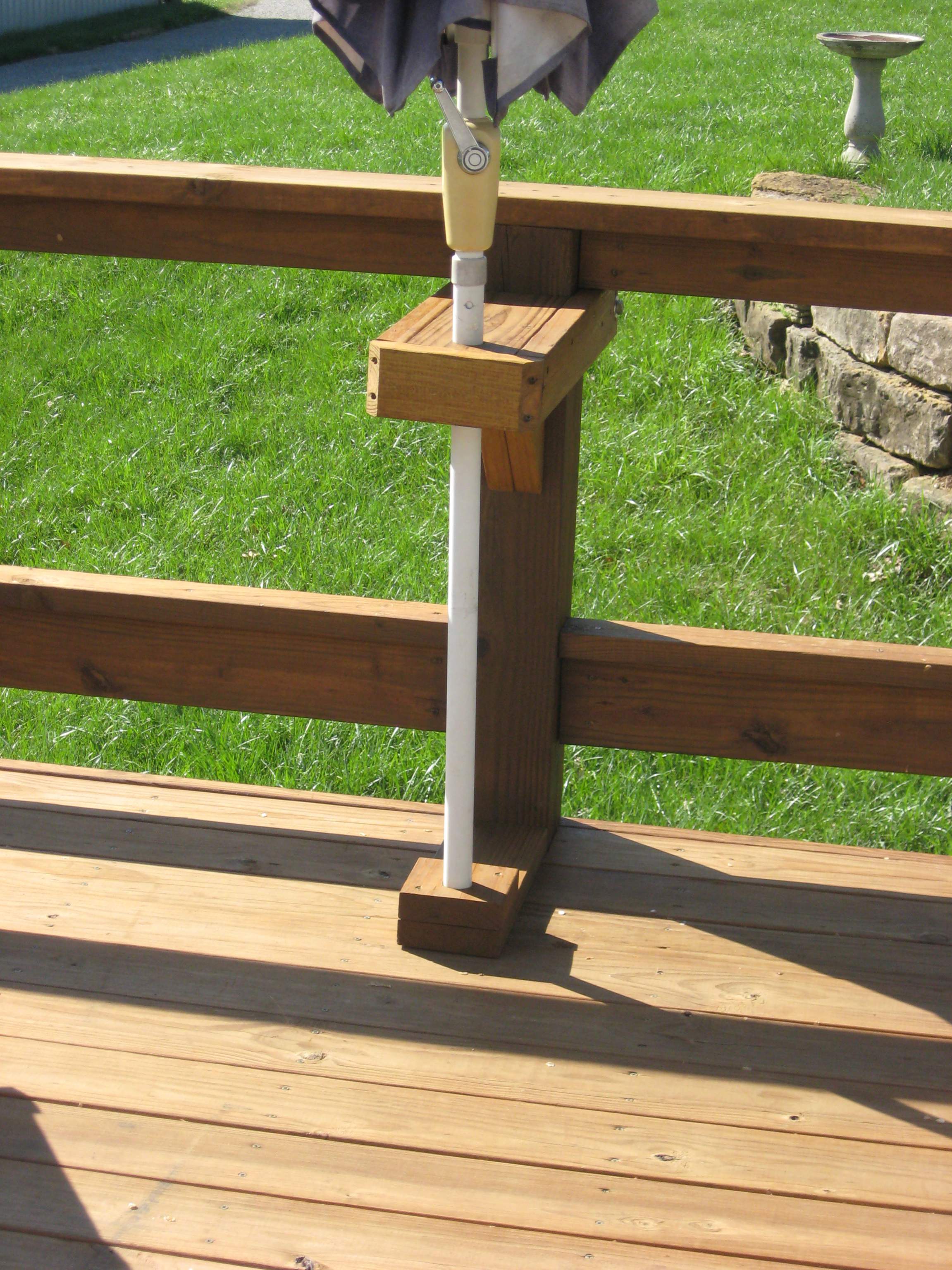

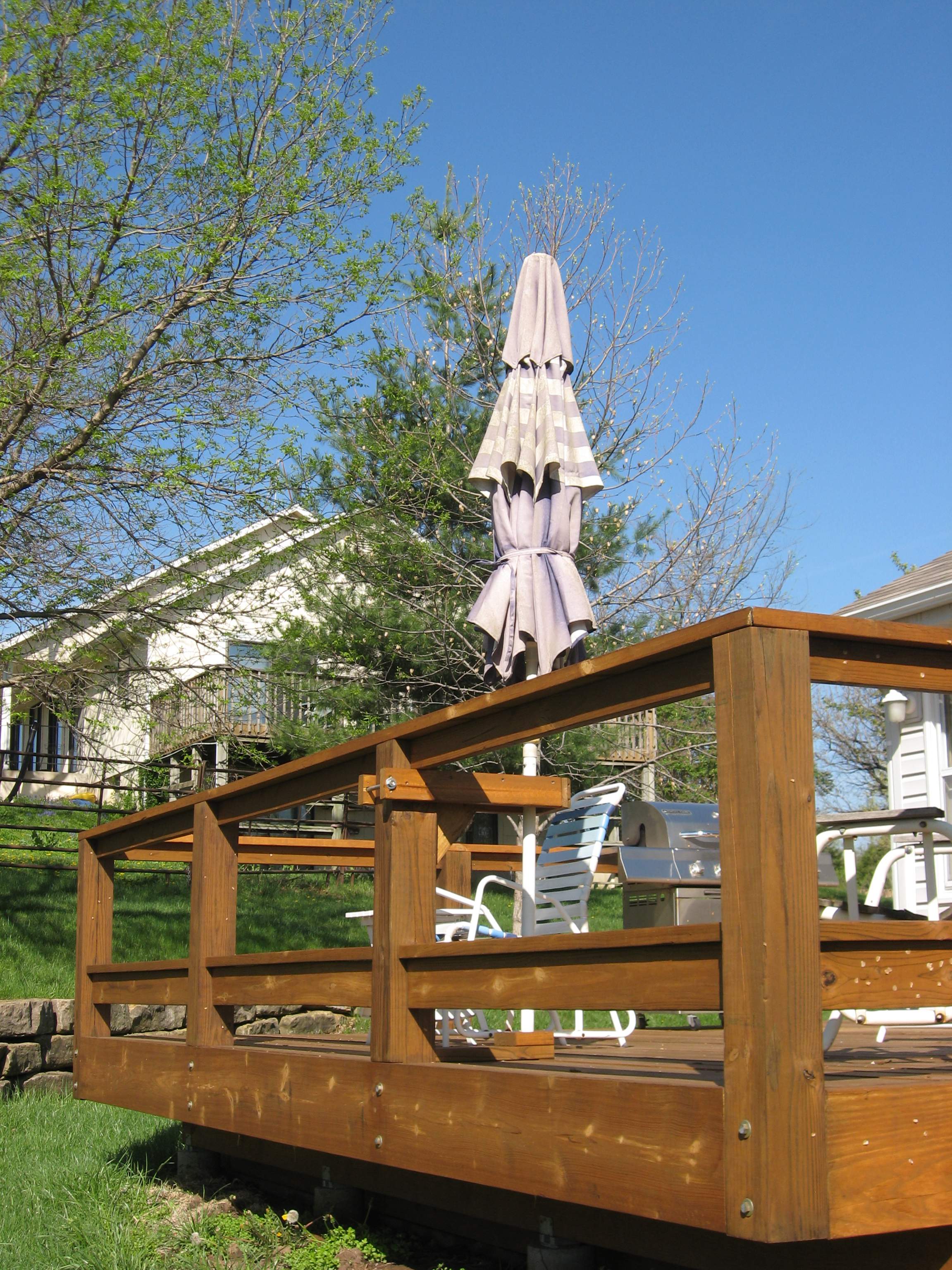

While I think that all solutions mentioned will work fine, I believe Runner's solution, shown in his attached pictures, actually look like this addition was a designed and integral part of the deck from the start, not just a pipe bolted on. If functionality is the main goal then go with one of the other solutions, they probably take less time to implement. If looking as if the deck was originally built with this feature is also a goal, my opinion is you should go with something similar to Runner's solution.
