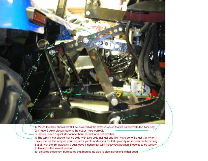

Newbe here.
I just got my Liberty BH and i am not sure about hooking it up.
