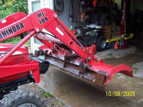

Here is my Meyers 6.5'attached to my loader arms, a project I did last month.

   / Attaching Meyers plow to the front of my tractor.. #24
wetstuff,
Looking good. Plenty heavy, gonna need to men to put that on.
Keep us updated.

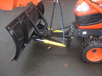

here is my rig so I can still use the bucket

   / Attaching Meyers plow to the front of my tractor.. #32
KHNewman,
Looks good. What make is the plow blade?

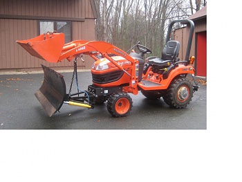

#33
So... we're ready. This pic is in the transport position.. I have both the FEL and plow rig'd to the hydraulics. When I get it home, I will probably drop the FEL ...but I don't have to.
Hank made the frame so I can leave it on. I can also drop the FEL (not yet tested..) as usual because he re-made the bar that -I gather- the FEL rest upon when loose.
The frame stays in place and I can completely pull the plow cylinder and stow it where it stays clean when not needed.
The plow is manual, but do not see that as an issue unlike those of you living in Yellow Knife. I have seen many creative ways to mount them in the previous posts and in FARM Show magazine, but feel more comfortable that -perhaps- when I come upon an immovable object, I won't tear much up.
.... you know how people have 'label makers' ... I happen to have a sign cutter so I can get **** about information where it is handy.
Next project is an overhead lightbar with solar charger. ..and a video cam mount also. Thanks for all the encouragement and info.
Jim Cancil/Salisbury MD
   / Attaching Meyers plow to the front of my tractor.. #34
Looks Great! Can you explain this in more detail please:
#36
Kenny: The hydraulic split was luck: In this mode the Tilt (R/L stick movement) lifts the plow and the Lift - lifts the FEL. When I drop the FEL at home, I will use #3-4 outlets for proper Up/Dn.
K-NH .. but I was scared as **** of tearing up the loader. I looked at a number of used tractors in the last few months and a few lost their ability to set the bucket flat on the ground. ..one Kubota had the retaining collar busted/welded back at the base of the right arm.
...Again, 'appreciate all the other great ideas out there. You gotta love this internet!
