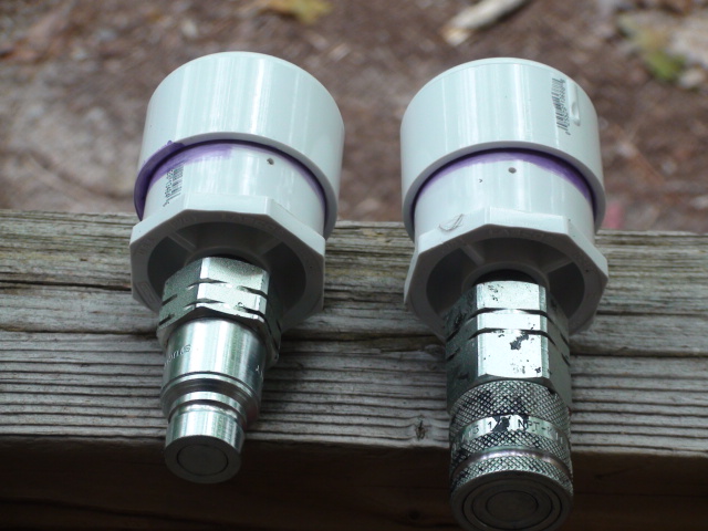

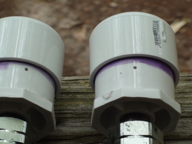

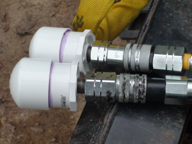

I replaced my flat face couplers with connect under pressure types on the tractor and grapple. This fixed about half the problem, but enough pressure could still build up to cause issues I did not want to deal with and I searched for a 100% fix.
After posting my issue, several TBNers came up with various methods that would have fixed my connection problems. The one I finally decided on was the one attached. It has the mating connectors screwed into standard PVC plumbing adapters with a tiny hole drilled into each PVC set to allow pressure to escape and stay low. Now after I relieve pressure on my grapple and disconnect them, I simply reconnect my terminal end couplers to the grapple side and now not enough pressure builds up to stop reconnecting under any circumstance I have encountered so far.
The first two pictures show the drilled holes for pressure relief. Inside of the caps are filled with rags to absorb the oil and reduce any long-term dripping. These are the original flat face couplers removed from the grapple and replaced with connect under pressure types.
