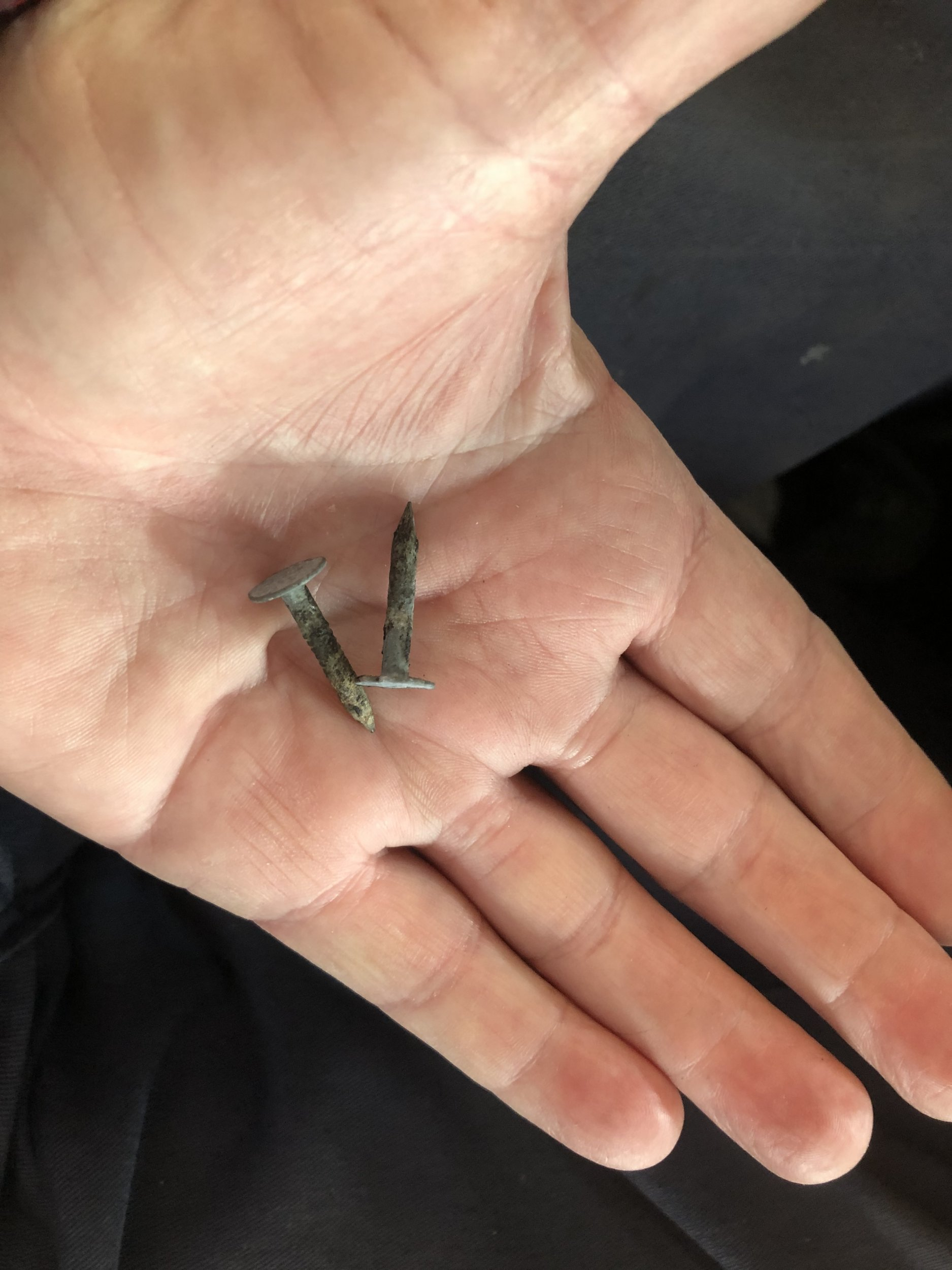

My grandkids house after CA storms. This was second layer so no interior damage. Adjustor is coming today.
   / Attaching tarp after blown off shingles. #12
Second layer ?? so shingles on top of shingles ... when new shingles are installed on top of existing shingles the nails need to be longer at least 2 inch if not that what happen... the good news is they did their time, they started to curls on the one side.
Yeah, the failure was probably due to installation. The roofer probably saved $20 on nails. I know that the roof was put on at least 20 years ago, so they did the job.
