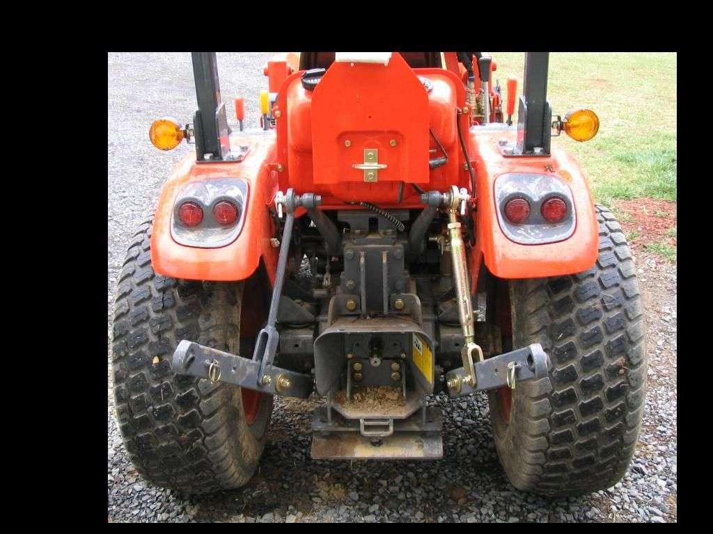

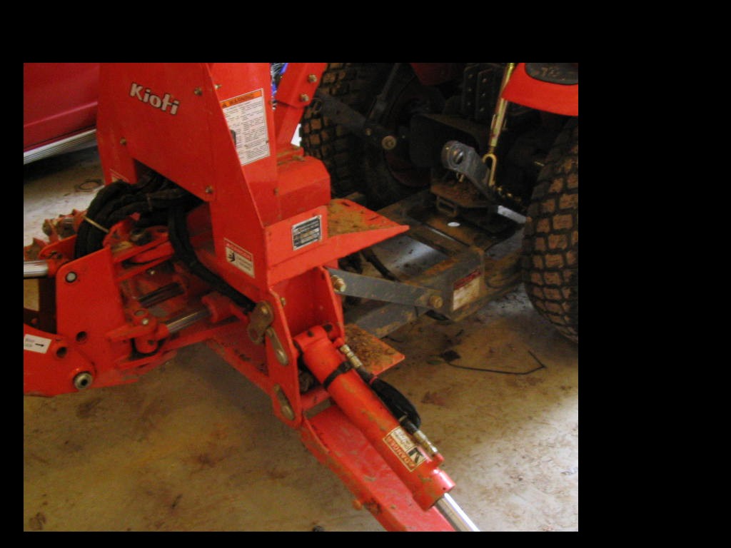

As promised here are some shots of the procedure.
Front subframe attachment on the tractor

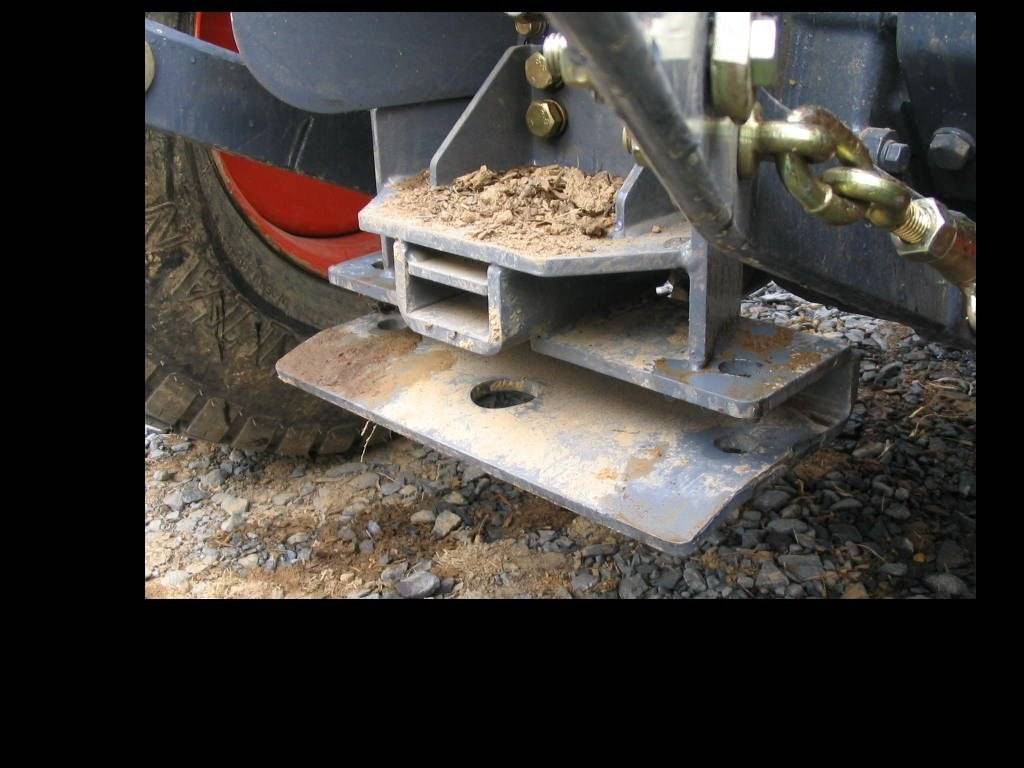

   / Attaching the BH OR My 1966 shelf
#2
Rear subframe attachment on the tractor
Top link has to go

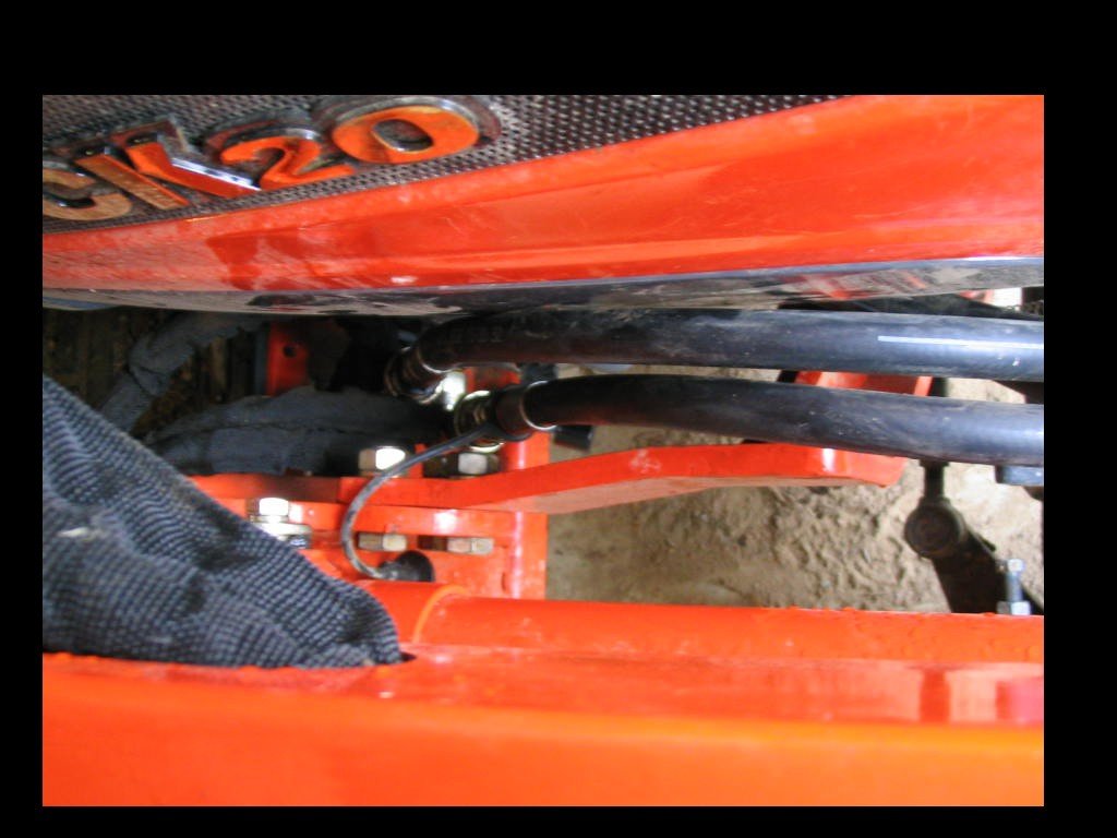

Back str8 over the subframe, str8.... straight straight and then hook up the hyd lines

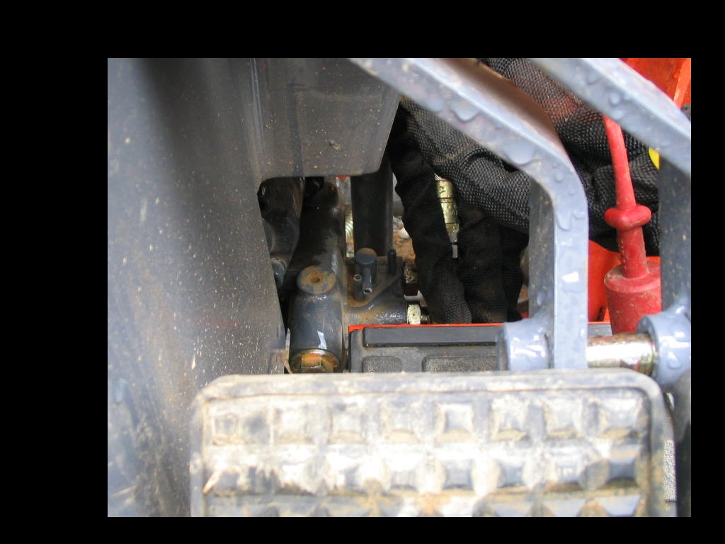

don't overlook this little baby, it can be easily hidden in all the hoses/cables--- Hydraulic switch

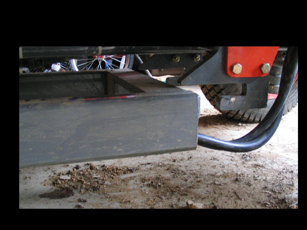

with hyd lines connected lift up the BH with stabilizers and boom
now back up some more to see how well you are aligned, make adjustments if necessary.
once aligned just back up a little more and sha-bam
#9
Drop the pins in the rear subframe mounts and your....

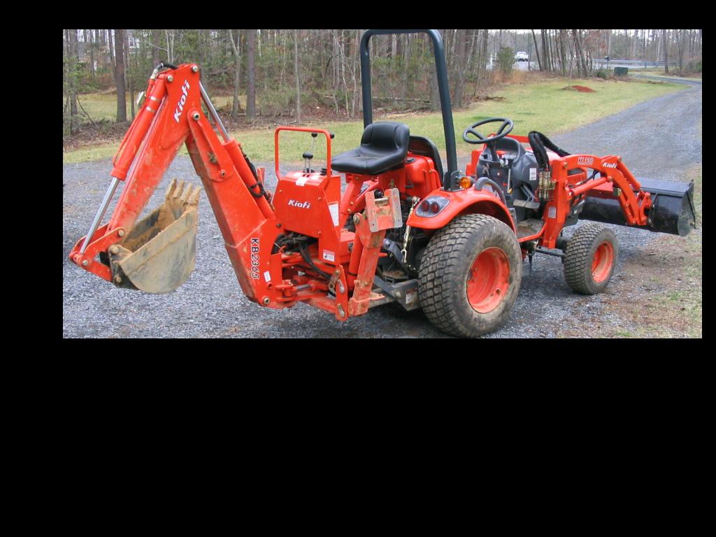

.... done
