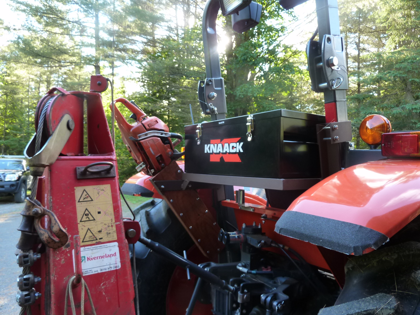

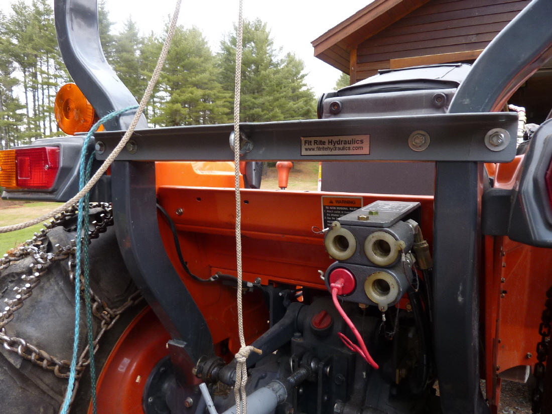

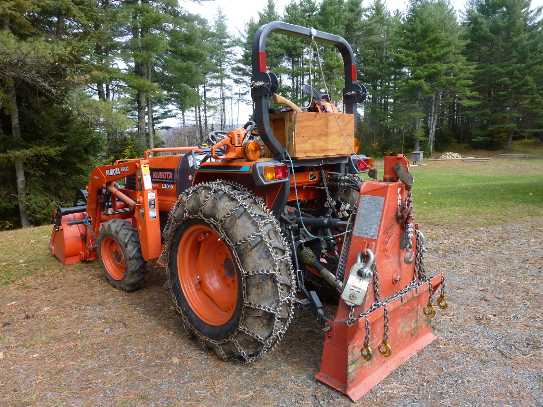

The ROPS on my tractor (Branson 3520h) has a very convenient hole on each side, probably to hold the ROPS in place when it's folded down.
I never fold my ROPS, and it looks like a really convenient spot to attach a shelf behind the seat, to which I'd attach a toolbox or two.
Any good reason not to use that as an attachment point?

No reason what so ever - at least to me. A great place for a tool box.

I attached lights to the top of my ROPS by clamping to it so I wouldn't have to drill. It would be just as simple to do the same for a tool box. If you have a hole that works, use it.

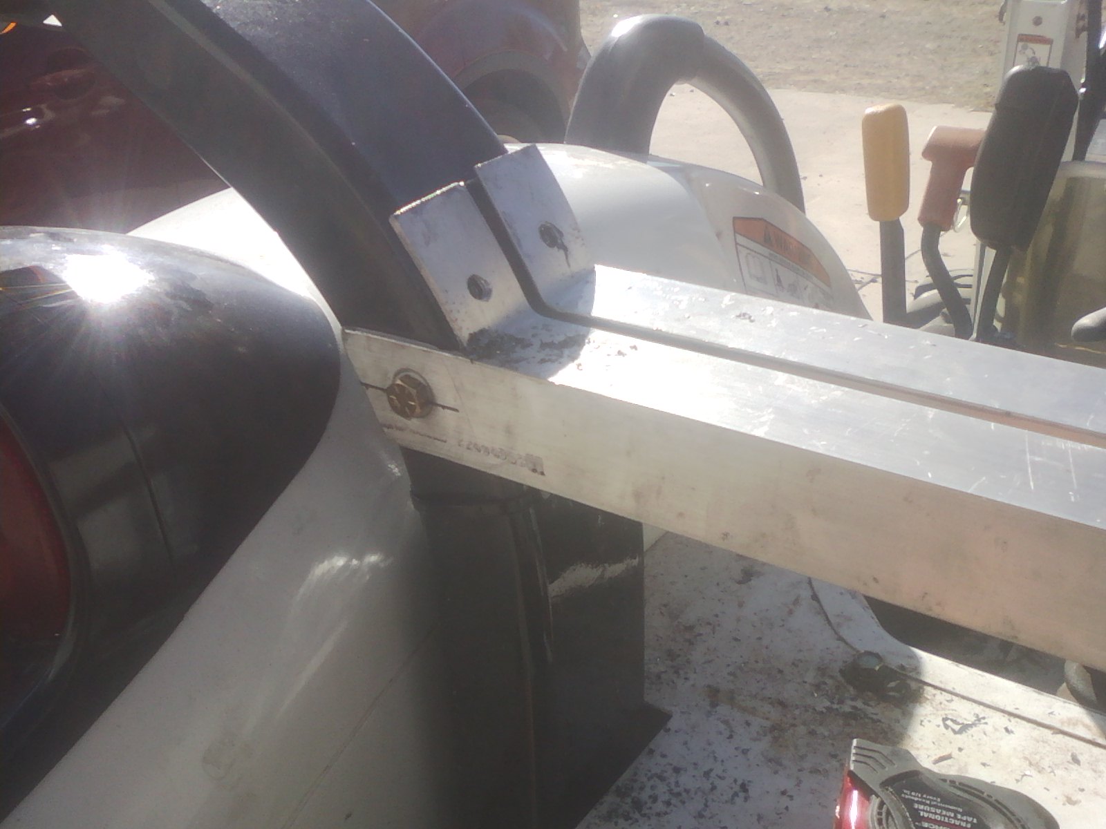

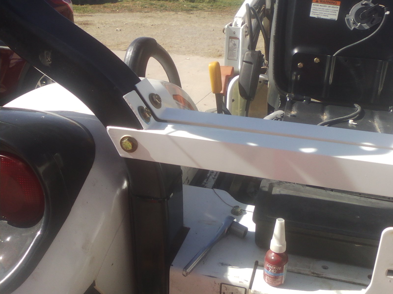

I used heavy duty aluminum angle material and split the ends to get tabs to bolt to the ROPS. Steel angle would also probably work. I then bolted a standard metal tool box. Just check the top opening clearance on the seat befor bolting it in. To bolt to the ROPS I drill and tapped the holes for the 3/8 bolts.

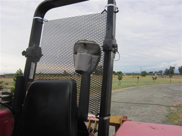

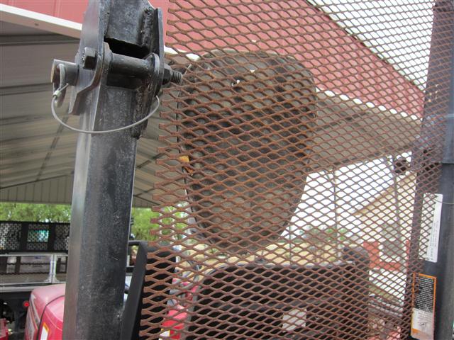

I use hose clamps to attach an expanded metal safety screen to the ROPS on my 2008 Mahindra 5525. Makes a handy place for a magnetic cup holder also. Don't see why you couldn't use existing holes in your ROPS for attachment.

   / Attaching tool box to ROPS using pre-existing hinge holes? #9
View attachment 526604View attachment 526605
I thought drilling into ROPS is a BIG no no. Is it ok now?
   / Attaching tool box to ROPS using pre-existing hinge holes? #10
I think it is, from a insurance claim stand point anyway but structurely speaking why would a small hole or two make any difference ?? I can tell you this: I bought a used tractor last spring and received all the maintenance paper work with it. The original owner had the Kubota dealer install 3 work lights. The dealer drilled the ROPS and used self tapping 5/16" bolts. Two in each light. What does that tell you ???
