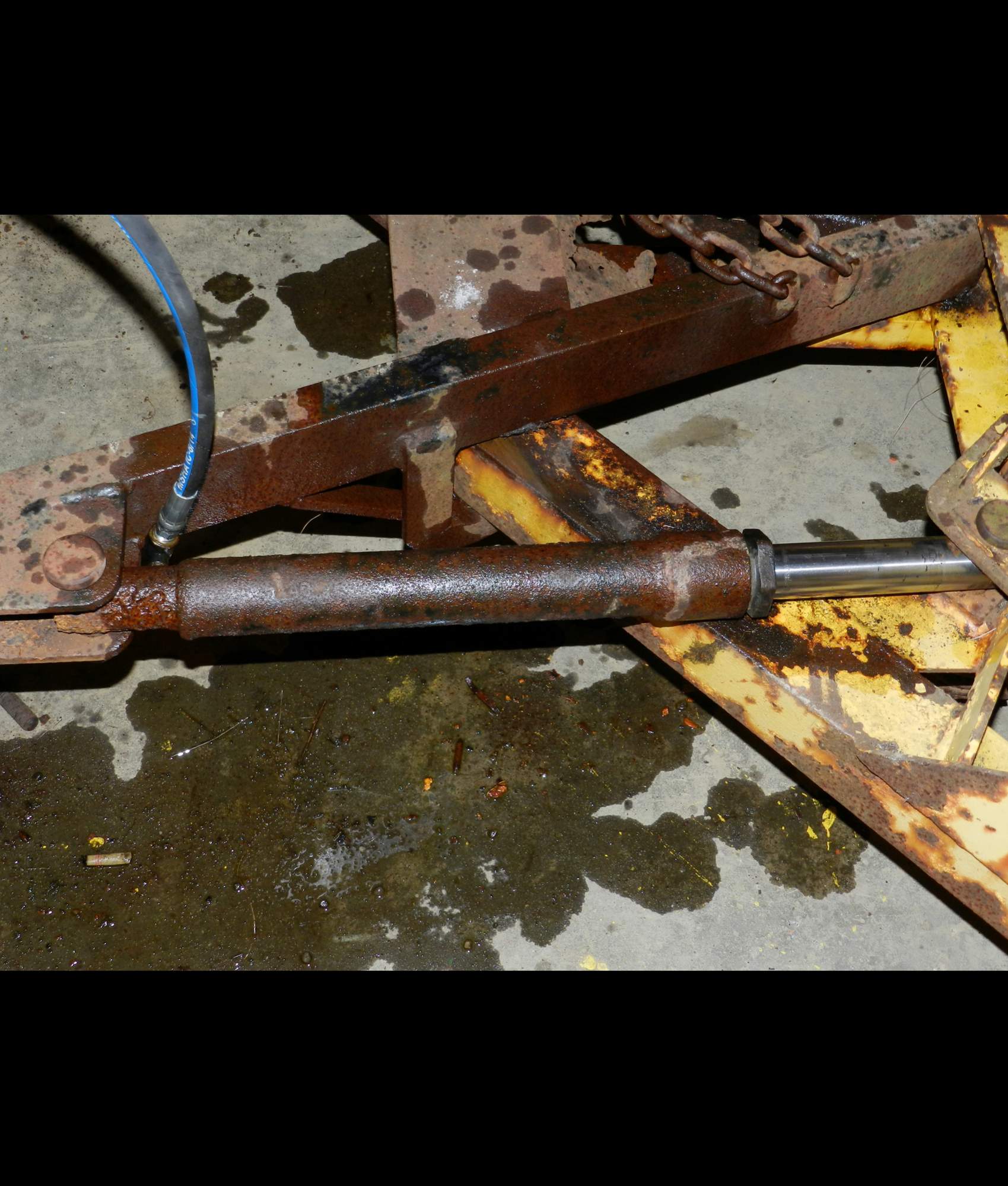

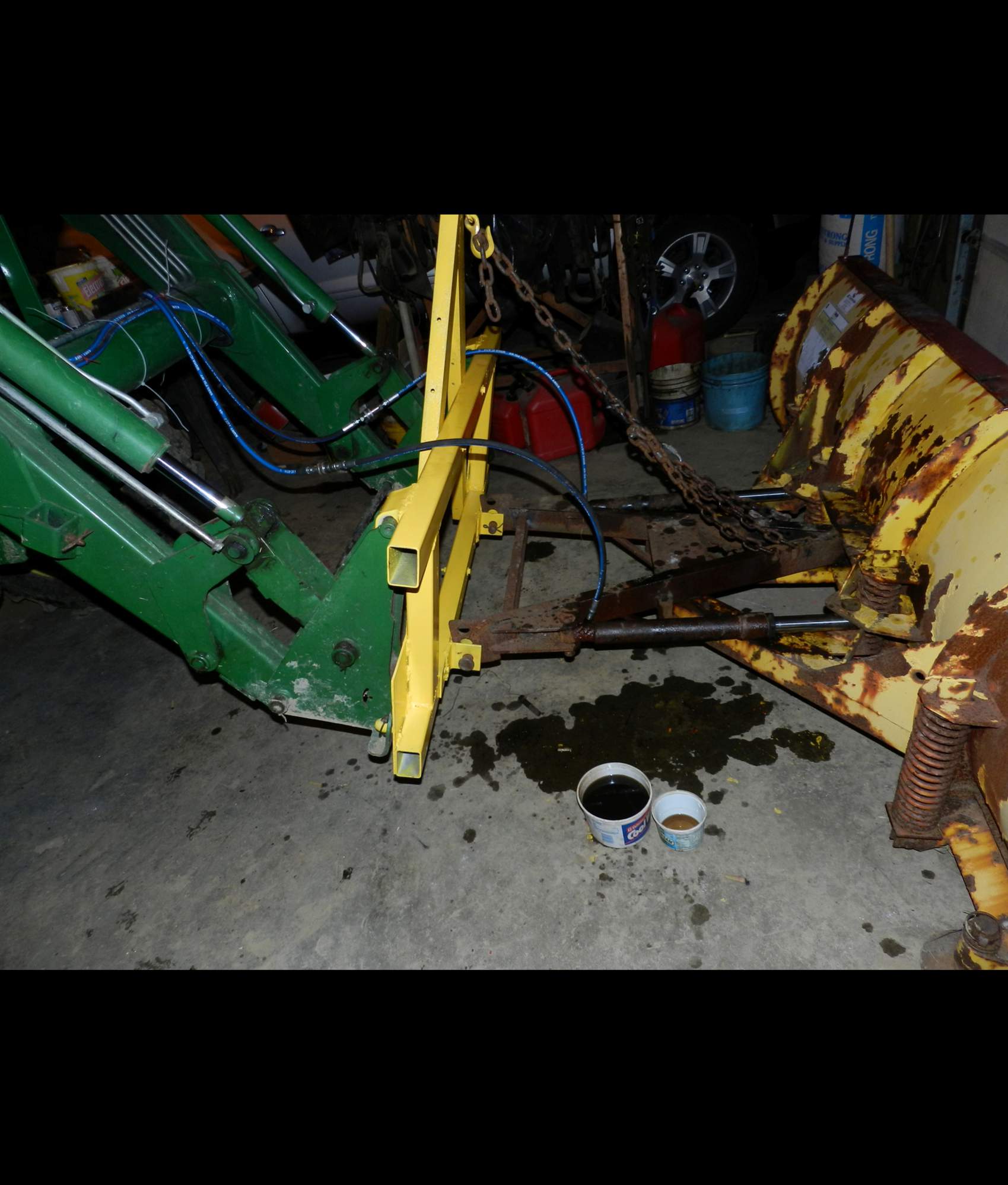

I am mounting an old Fisher truck plow my FEL, i have the mount complete and am in the process of trying to get the hydralics to work. The plow has two single action hydralic cylinders so i ran two hoses from the tractor's rear hydralic valves to the front of the loader arms, then i installed short sections of hose to the cylinders and placed quick disconnects between the hoses. The first attempt to rotate the blade worked fine but after cycling the blade a couple of times it froze up and would not rotate either direction. When i checked the cylinder hoses both were pressurized so i couldn't get the quick disconnects apart, i bleed the pressure off by loosening the threaded connectors at the cylinders. If i leave one cylinder hose disconnected i can pressurize the other cylinder and get the blade to rotate, but if i connct the hose and try to rotate the blade back the other direction both cylinders pressurize and the blade locks up again until i bleed pressure off of one of the cylinders.
I mounted the quick disconnects with the female part on the plow and the male part on the hose from the tractor's remote valve. Is there a specific orientation for which end goes on which hose?

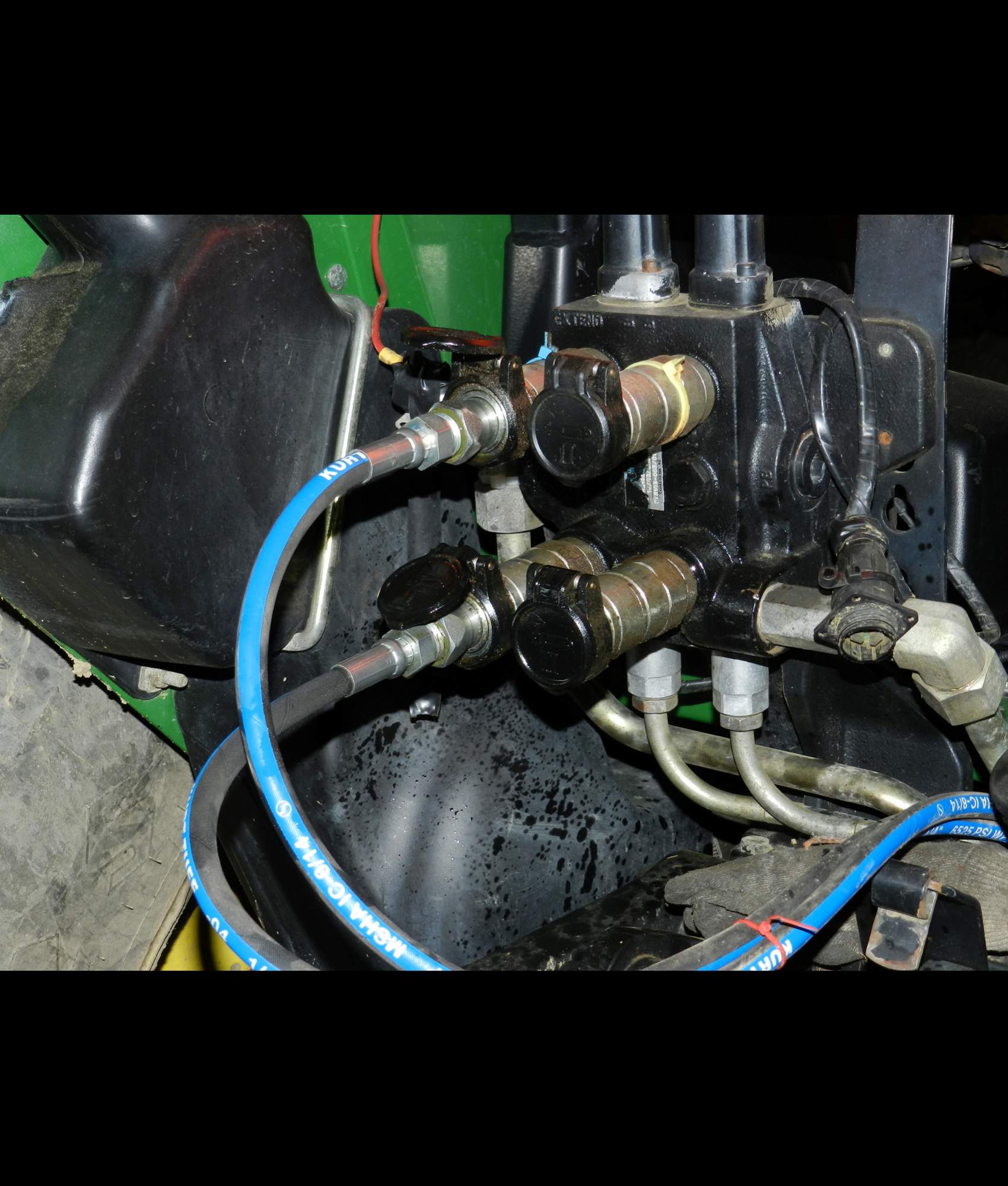

Thanks for the reply. It is a John Deere 5425, i am not sure about the valves they are the standard remote valves on the rear of the tractor. I had one cylinder hose hooked to the Cylinder Extend port on the tractor and the other cylinder hooked to the Retract Port. These are the same ports i use to hook my discs and baler hydralic cylinders to so i know they work, the difference is they are dual action cylinders.

Can you try the setup without the quick disconnects? Just get the correct fittings and join the hoses together. My guess is that you will find it works OK without the quick disconnects. Once you find out if I am correct you can look for the problem in the disconnects.
