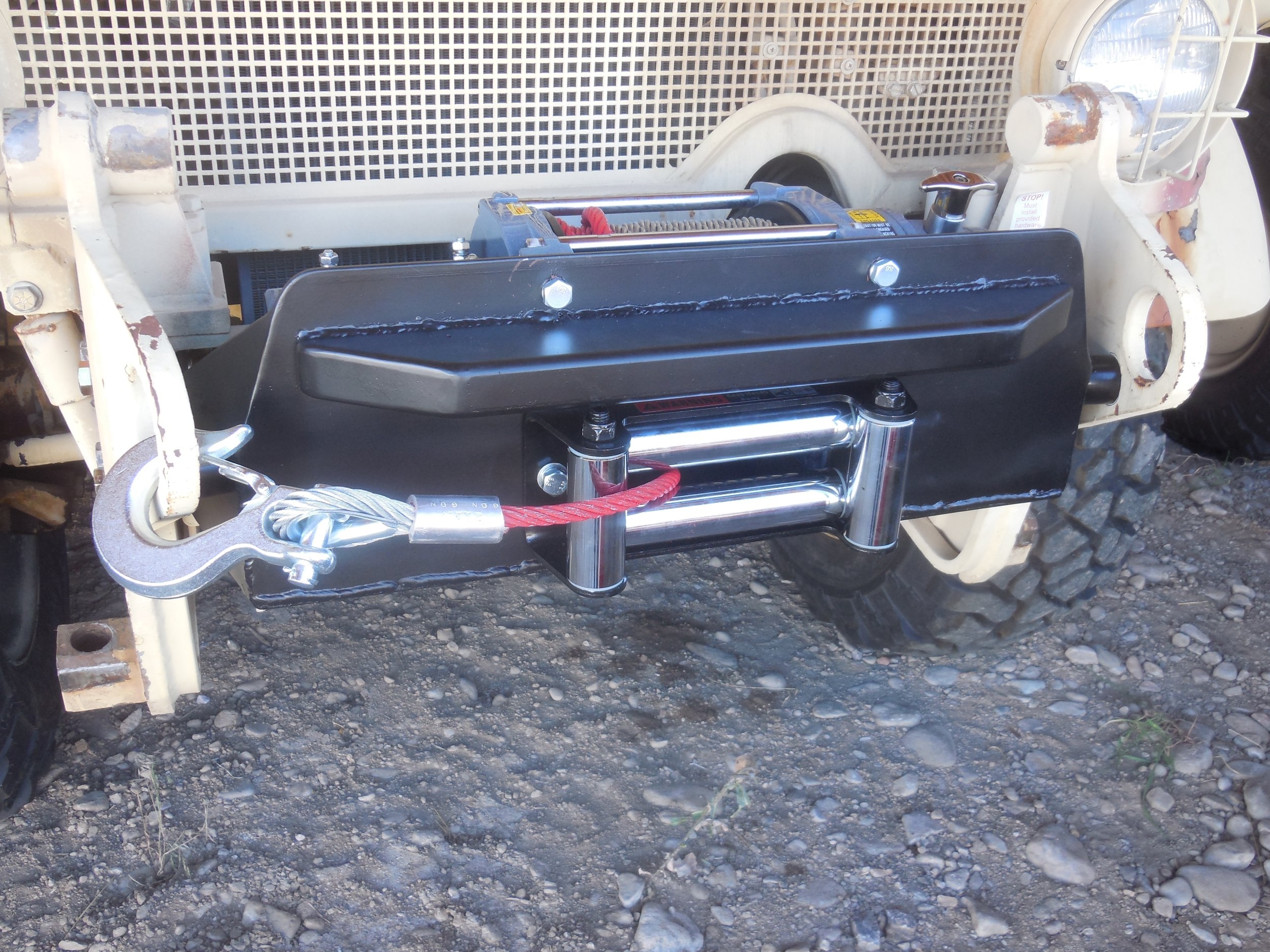

About two years ago I installed an 18K winch on one of the Unimogs, one of maybe two dozen winches I've added to various vehicles, basically to be able to upright a tractor if needed.
That was the most complicated mount to make to date, due to very little space to work with, but being able to pull the skid steer out a couple of times made it well worth it.
