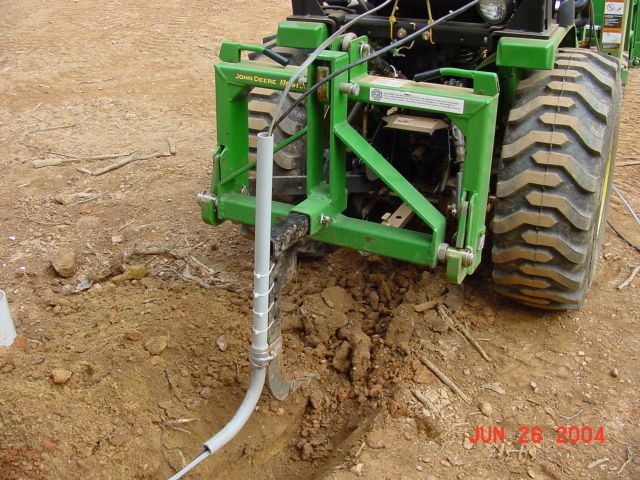

Was wondering what would be a good attachment for running an electric line about 30-50yds.
/ Attachment for Running Electric Line #2

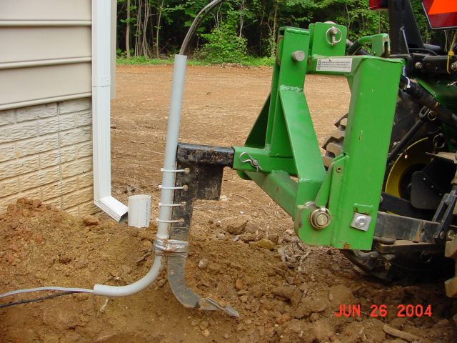

What kind/size of wire? I used this rig for a 12-2...there are quite a few other posts is you search some also.

I'm looking to bury the line, so was thinking a subsoiler with some kinda of adapter.
/ Attachment for Running Electric Line #6
I'm planning on running from a 100amp breaker to a breaker box in the barn. I'm not sure how big a wire I need. I'm going to have to stop by the local electric shop and see what they suggest. It will definitely be bigger then 12/2
100 amp will need 3 conductors of #2 wire at least and a minimum #6 copper ground wire...That will be be a bit much for a subsoiler attachment and also won't be deep enough (24" min. around here)
I suggest renting a trencher and burying 2" conduit for that type of service. You can also add a second 1" for low voltage wiring.
