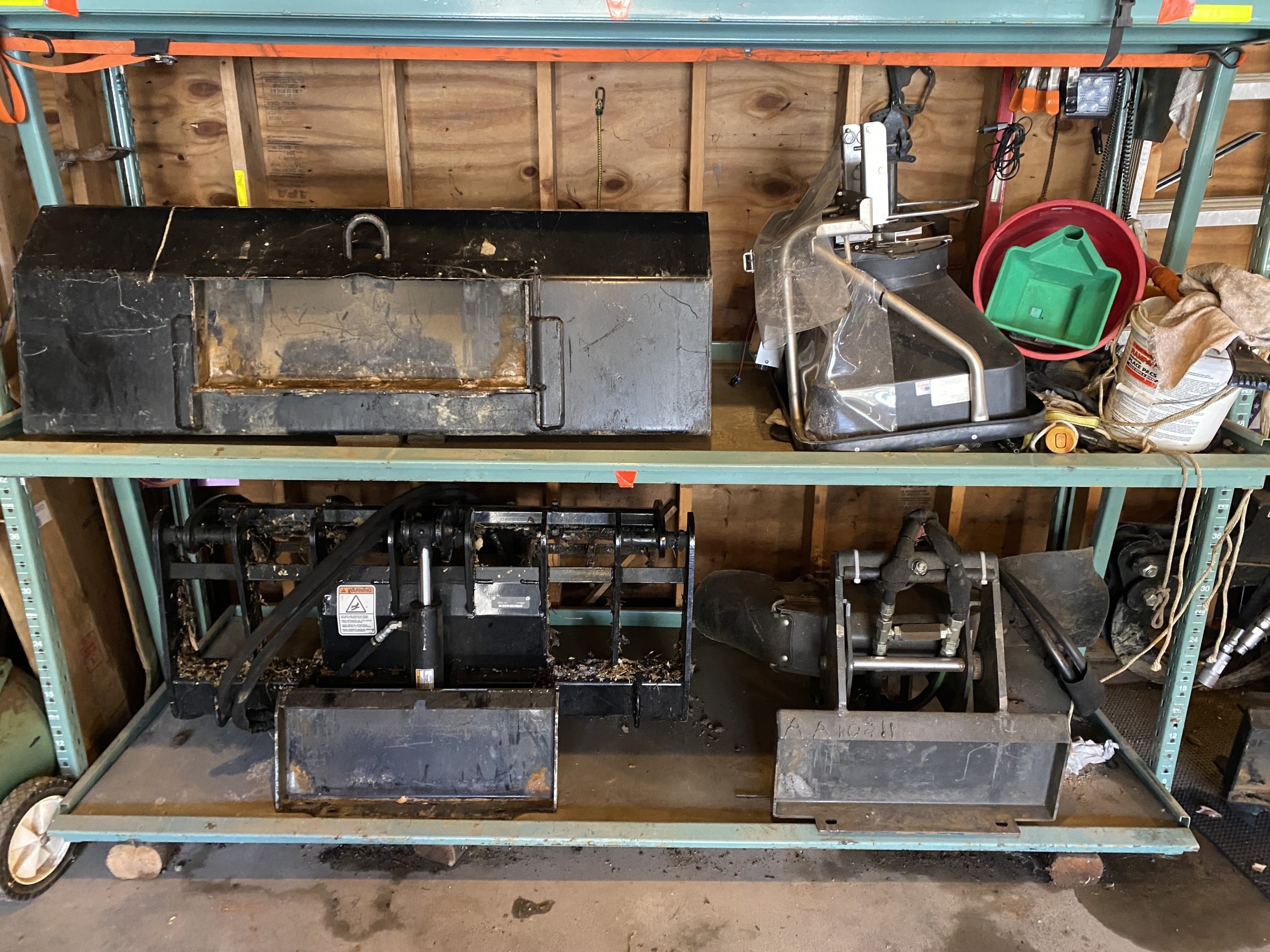

Greetings,
I'm looking to replace a metal shed building with dirt floor with a permanent garage. I'd like to keep the garage pretty small but then have a shed roof off to the side or other side storage for a covered and secured area to store implements. Considering racking and other ways to keep these all in out of the rain, protected from prying eyes while I'm away from the cabin, and yet have decent access.
I'm in the Northwest (USA) and don't have severe cold but tons of coastal moisture.
I'm interested in what others have done to keep track of a handful of attachments under cover in a compact way and yet be readily accessible.
For reference, these are all pretty small implements for a 24hp compact. They tend to weigh 500-700 lbs. each.
Probably everyone can relate to not having enough storage space.
Thanks in advance.

I took an idea from others here and built dollies for many of my implements. I can stack them in the barn and move them around by hand to get to the ones behind them.

Another option are pallets and a pallet jack.. assuming a concrete floor.

If you have a front loader and pallet forks, have you considered Home Depot style lumber racks to stack them vertically, keep them off the floor, maximize floor space, and make them difficult to steal without a loader/forks?
