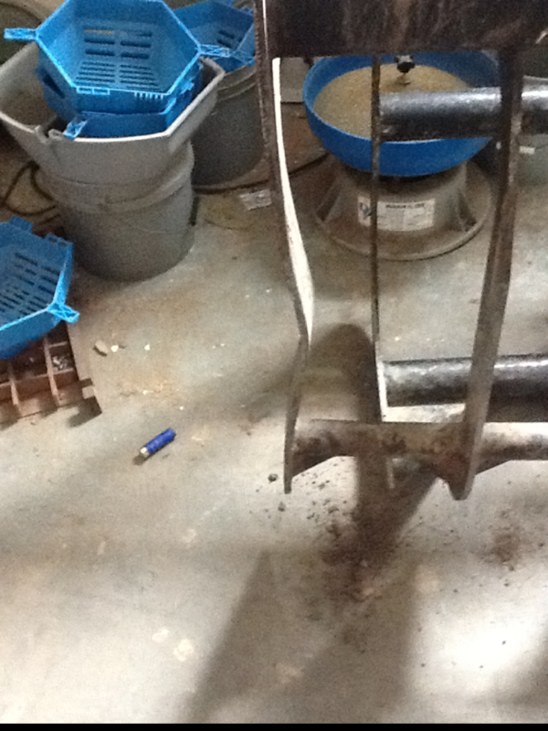

Try ramming a tree on the outside tine while going about 5 mph. I accidentally did this and it bent my grapple. How much are you paying for that job opportunity? I'd probably do that for 75 cents an hour.

It was an accident. I was driving through one of my trails it the woods. I had to make a sharp turn and I didn't hardly make it.

I was referring to the vibratory case cleaner and case media separation device

Try ramming a tree on the outside tine while going about 5 mph. I accidentally did this and it bent my grapple. How much are you paying for that job opportunity? I'd probably do that for 75 cents an hour. <img src="http://www.tractorbynet.com/forums/files/attachments/443290-attempted-grapple-destruction-image-1986482409-jpg"/>
How mad were you when this happened. I see the spent shotgun shell on the floor.
