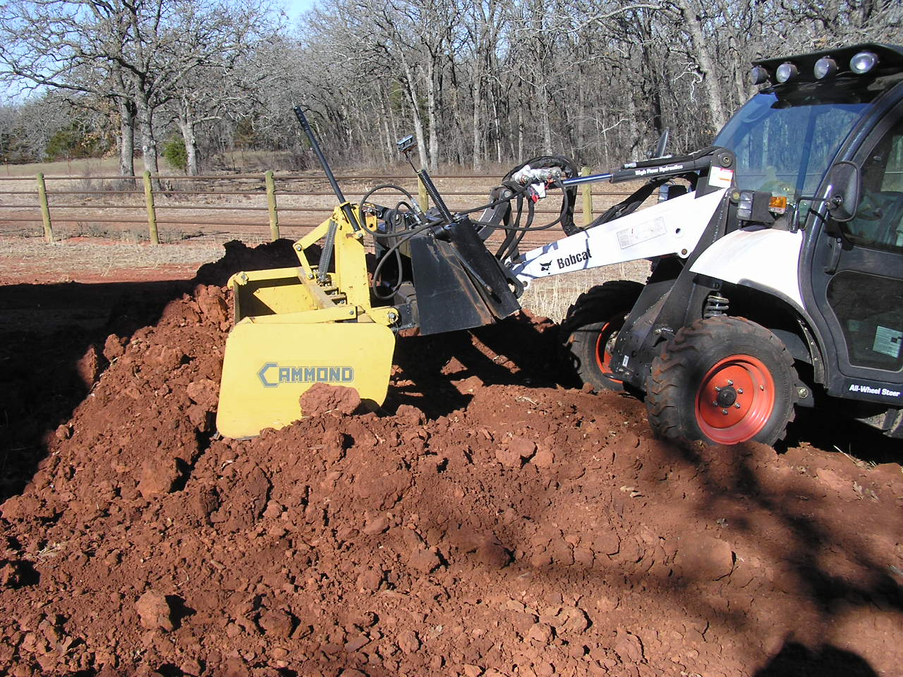

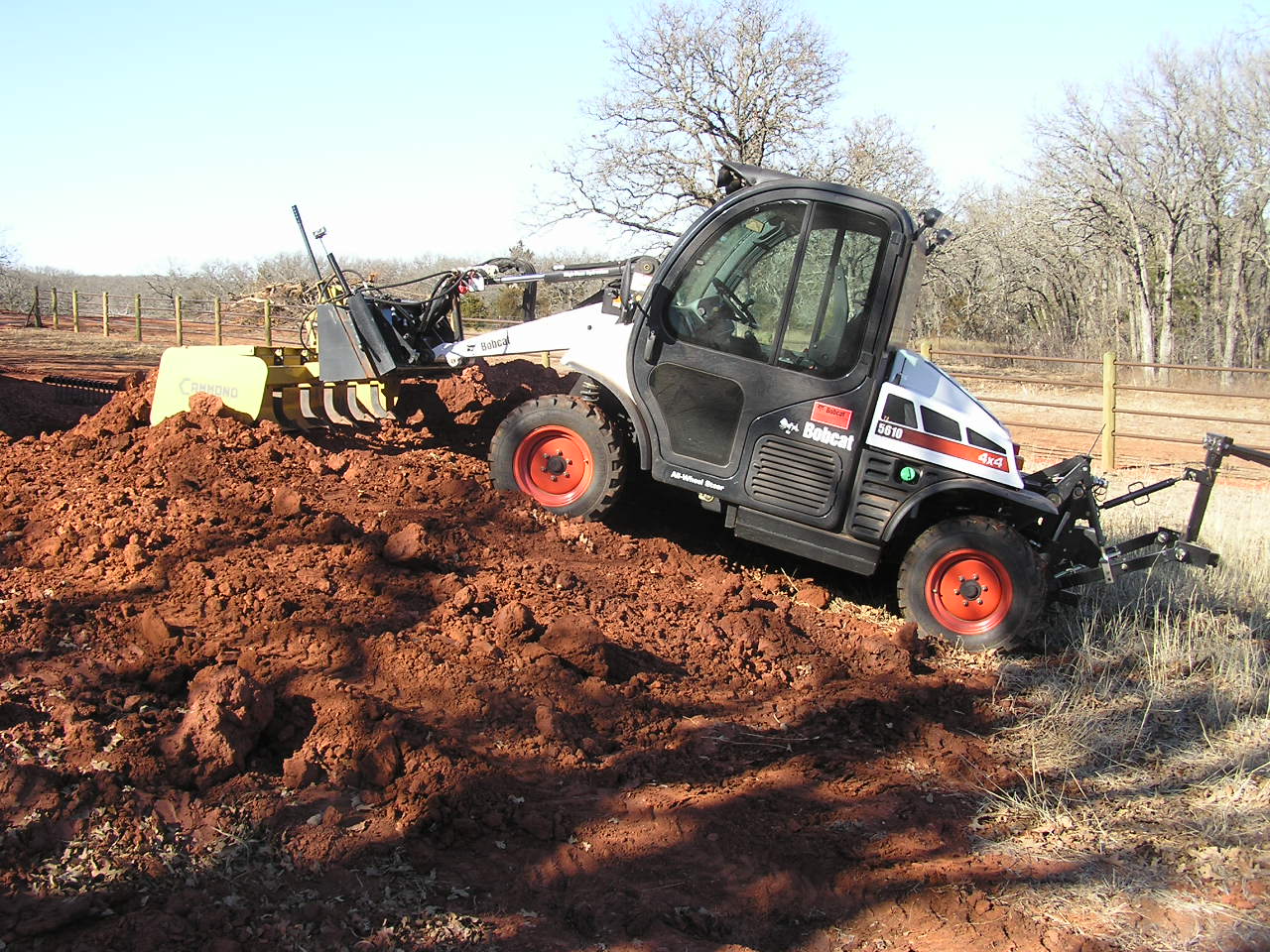

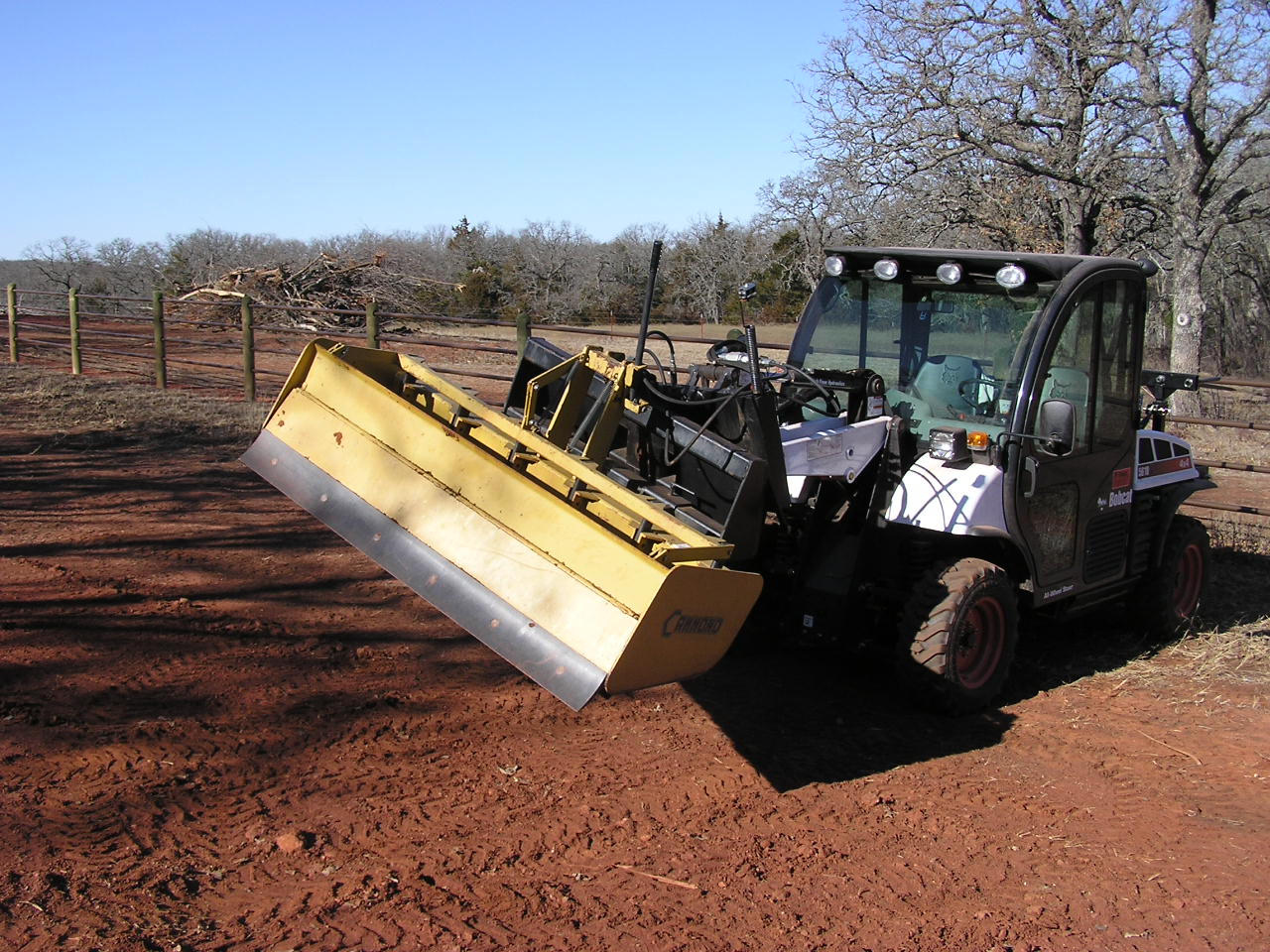

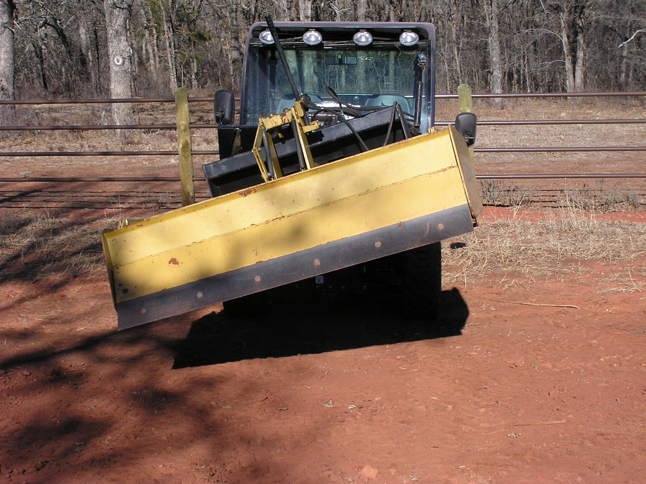

I like the lever that lifts or lowers all the scarifiers at once, like this Cammond. They raise straight up, out of the way.
I was moving silt with one that the scarifiers rotated back an up. The silt filled the BB and around the scarifiers, when you raised the BB the sticky silt stuck in there and would not fall out!
Don't need a hydraulic cylinder on the scarifiers, since I use the BB on a tilt-tach that takes the aux hydraulic connection.

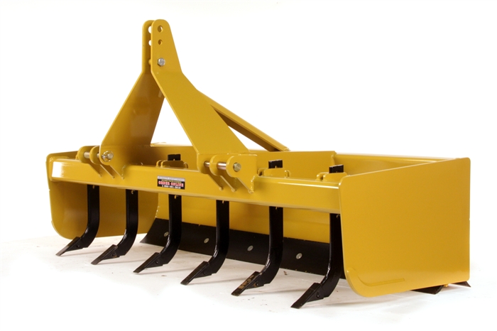

I recently bought the Woods BSM72 and it's heavy duty built. 1/2" plate sides that roll over at the top for extra rigidity (I assume), added 1/4 or 3/8 (don't remember) added to the wear edges, and I liked the best that the scarifiers are mounted behind the cross tube in 1/2" brackets so all the force is on them and not wallowing the holes in the tube out over time. I wanted a heavy weight and heavy built BB. I looked at the ones you offer but they weren't as heavy as this one.
http://www.tractorbynet.com/forums/attachments/285326-box-blade-kubota-l3800-5.html

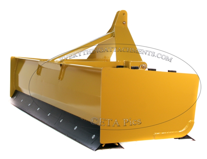

Our ETA Severe Xtreme Boxblade is designed extremely well, has many nice features and hasn't let us down at all.
After seeing recommendations for heavier on a regular basis here on TBN, he wants to make an even heavier box blade and would like some opinions on which blades are the best in the 800-1,200 pound range.
Let us know what you think is the best heavy box blade on the market, why you like it and what you would do to improve it.

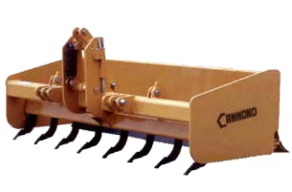

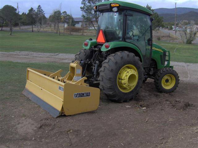

I think it should be a "high-back" model, like these.
Pictures from Google Image Search.
Not like your standard style, that won't move as much dirt as a high back style.

I own the 96" ETA Severe Extreme box blade and after using it wouldn't spend the extra money on something heavier. At 815 lbs its plenty heavy enough to cut through anything I have on my property.
I have some real wet areas that I'm making into shallow ponds for the ducks and if I'm not careful watching the angle on the blade it will dig in enough to stop the tractor.
I've over filled it with gravel, wet and dry soil and turning this blade into a pretzel isn't something I am remotely worried about, even with my 88 HP tractor.
Maybe I'm missing something here so could somebody explain to me what material or conditions would dictate the need for a heavier blade? Up until I read this thread I was really happy with my purchase.:)
