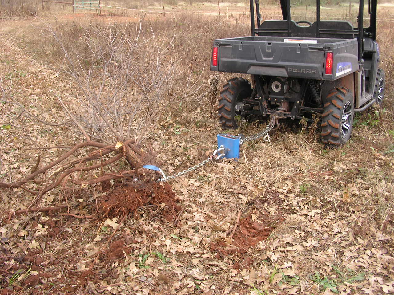

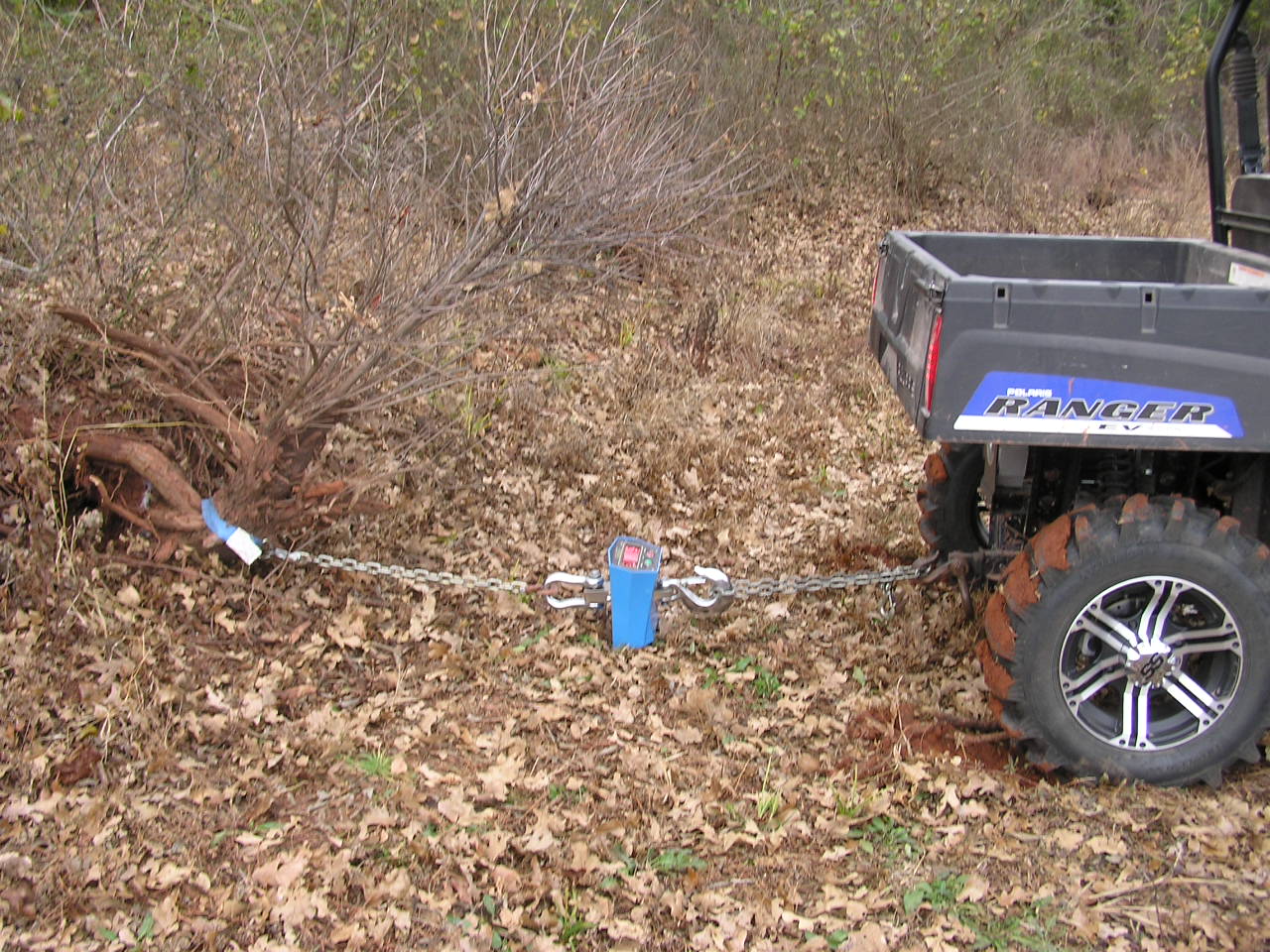

If you don't have an ATV, I think a UTV would do better. Mine has a tow rating of 1500 pounds.
2015 Polaris RANGER EV Avalanche Gray : Specs
I tried to measure the maximum pull with the Crane Scale, didn't work.
Pulled the stump out instead. :D
http://www.tractorbynet.com/forums/...ic-polaris-ranger.html?highlight=#post3544626
