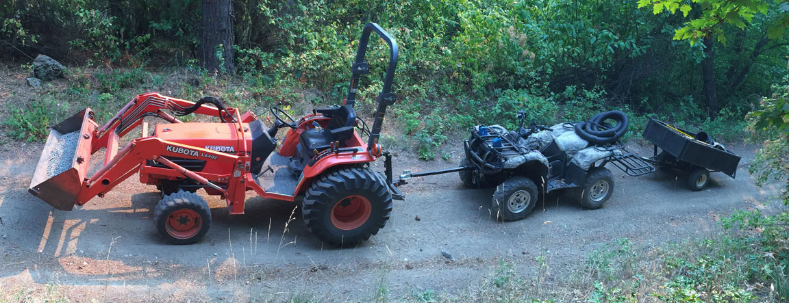

I like this towbar, I REALLY like it. Here's today headed off to "capture a seep".
Gravel in the bucket.
Drain tile on the ATV
ATV rear cargo bench to ferry 5-gal buckets of gravel to the site
Trailer full of woodchips, shovels, tools
attachment.php
Got'er done too, the water's running (trickling). Just before dark. Rode the ATV back, all the other stuff is still out there, will go get it in the AM & looking forward to it. Its a good system!

Great idea Sodo. I like everything about it. I have the same problem, especially on the deer lease. The area I hunt is about 5 miles from the camp. That's quite a long tractor ride, but nothing on the Honda. This may be my problem solver.
If I "borrow" your idea, I'll post pics.

Heres the towbar construction. Also have a clevis type attachment. All of my
ATV hitches have this interchangeable swivel arrangement that use a large 1" thread and welded nut.
I like it. Esp the threaded attachment to the clevis. You get way more articulation than with just
the trailer ball-hitch.
