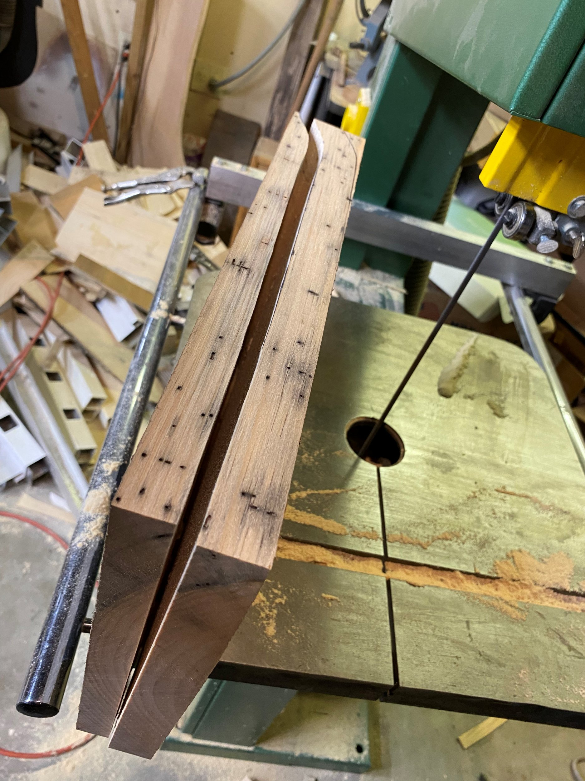

I have a small manual Woodland mills HM-126 saw mill, so there's a lot of dry wood sitting all over the place, and hefty pieces to choose from. I have some 16” wide 1” thick planks, and some 11” planks, a full 2” thick. The 1” wood is good for the bottom, the 2” material can be resawed to form the contoured perimeter of the carrier. My 18” band saw is capable of 9 ½”+ depth of cut to resaw, so that’s how deep the carrier will be. Before we had kids, I used to build RC airplanes from balsa, so gluing together irregular wood pieces and then contouring them is a pretty familiar thing to me. For most of the assembly, 30 minute epoxy will be used. The 30 minutes gives ample time to get everything arranged and held together securely before it sets up.

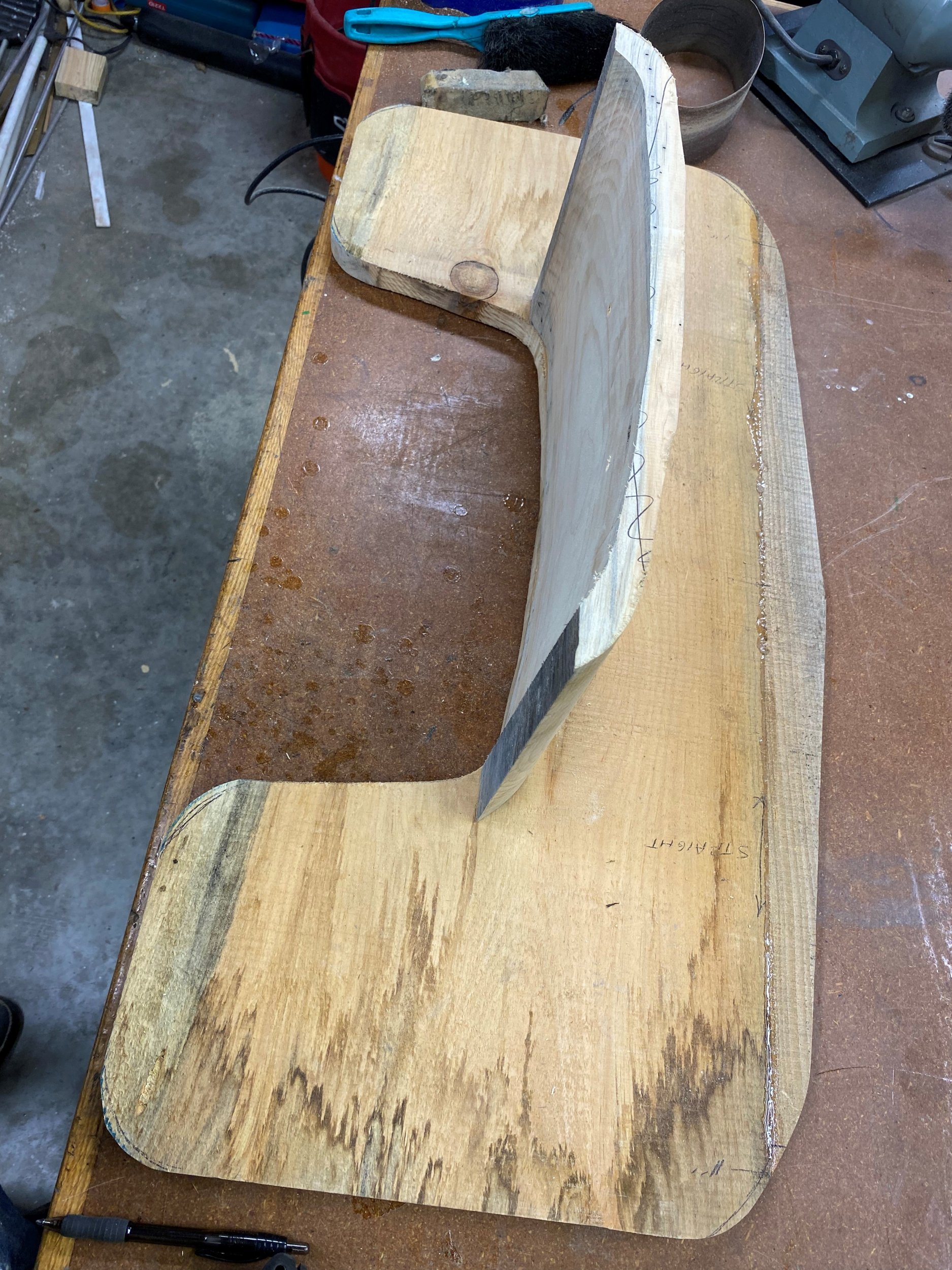

Here’s the base with the first contoured piece resawed from 2” white pine stock. The 2” material is good in that it provides a reasonable area to rest on the bandsaw table and stay vertical. But before resawing, each piece was run across the jointer to make sure that the side was perfectly square, and the bandsaw table fine-tuned so it’s also perfectly square.

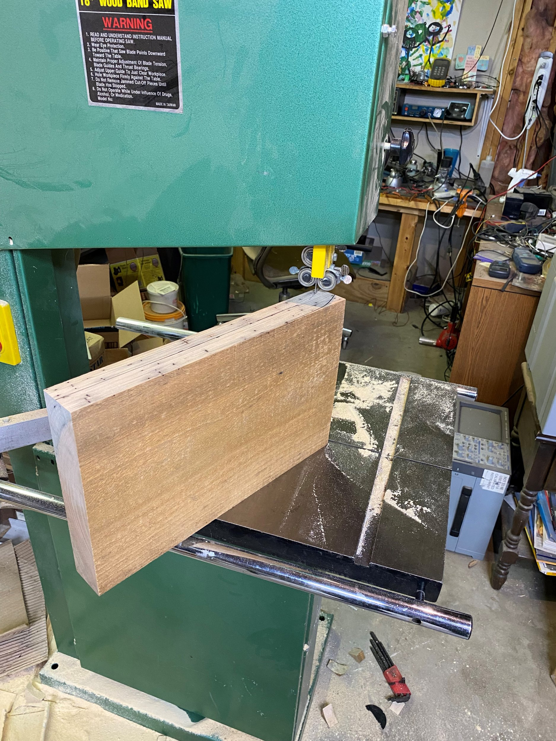

Resawing on the bandsaw. I have never used this saw to cut this kind of depth, so it was a new thing for me. I'm very pleased with the performance and results. This is a Grizzly 18" band saw that I picked up a long time ago. It's not the best quality machine out there, but it has served me very well all these years.

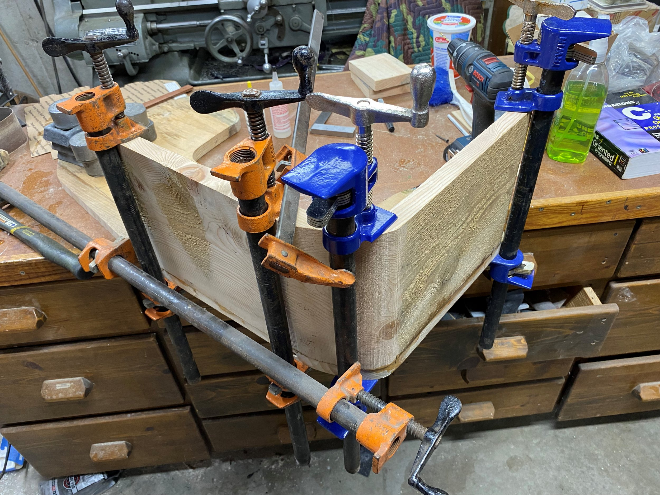

Gluing up the side sections goes one section at a time, doing final shaping to make sure that the joints are reasonably tight. A perfect fit is not necessary since the epoxy does an excellent job of filling voids. Sometimes you have to get creative with use of the clamps to get the pressure needed to pull things in. When I look closely at this pic, it looks like I have clamps pulling on other clamps and right now am not sure why, but when you're trying to close up gaps sometimes you have to grab onto whatever is there to pull on.
I always tell my son-in-laws that you can never have too many clamps, so they always get a couple new clamps every Christmas. It's now a bit of running joke for us.

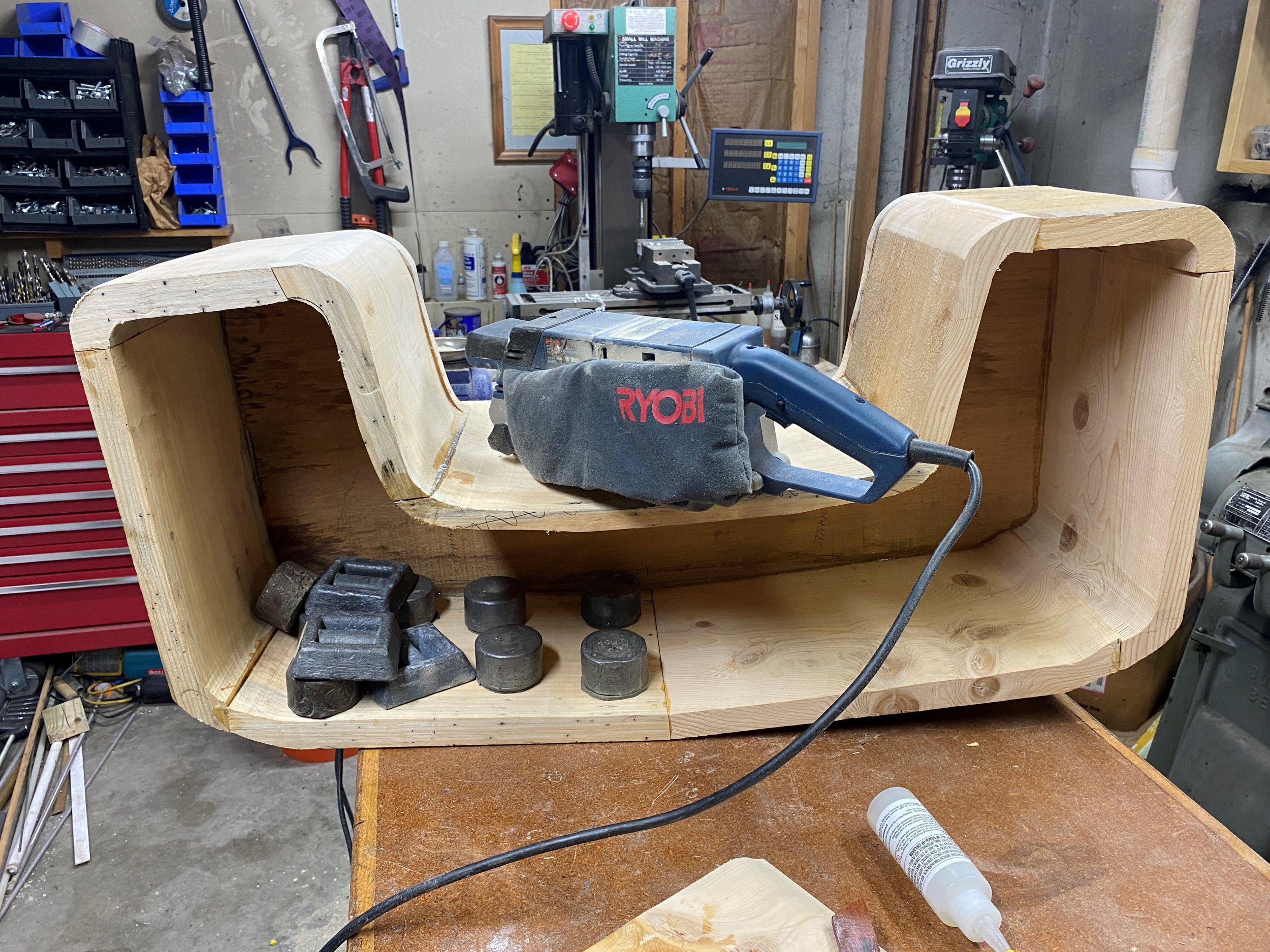

This post gets me caught up to where the project is at this morning. There are just two more sections to glue in, and then I'll be ready to start shaping the exterior with a belt sander. I'll use a small router to round the edges over and then do some sanding with an orbital sander. I'll have to sharpen up a chisel to clean up some of the joints on the inside, but I'm not going to be super particular about an interior that looks perfect.

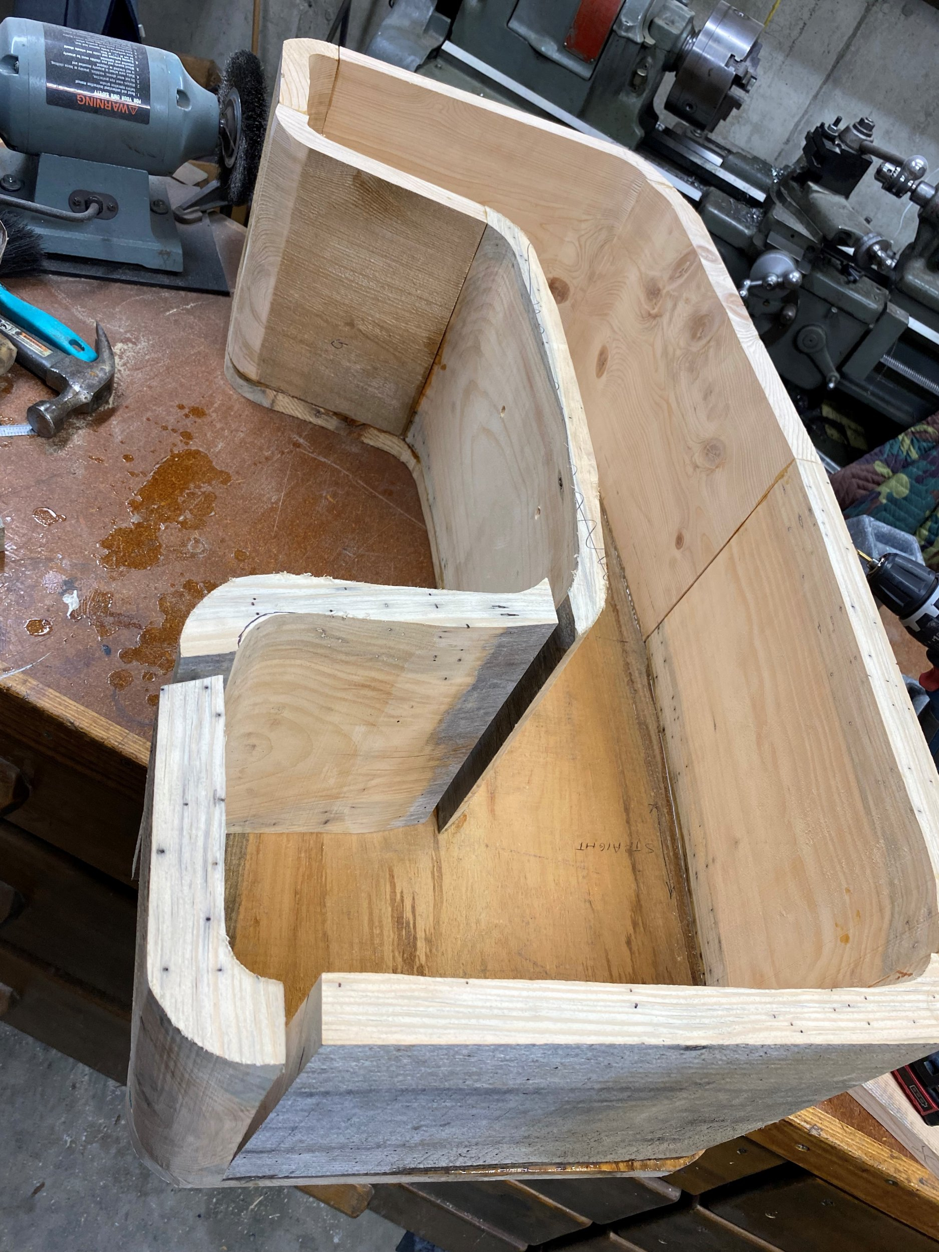

All glued up. Now there's a lot of shaping and sanding coming up. Incidently, I love this Ryobi belt sander. It has a square body that can easily be clamped in a vise for use as a fixed tool, and it is compact for getting into tight spaces. Sadly, it looks like Ryobi no longer sells this model. I bought this a very long time ago.
