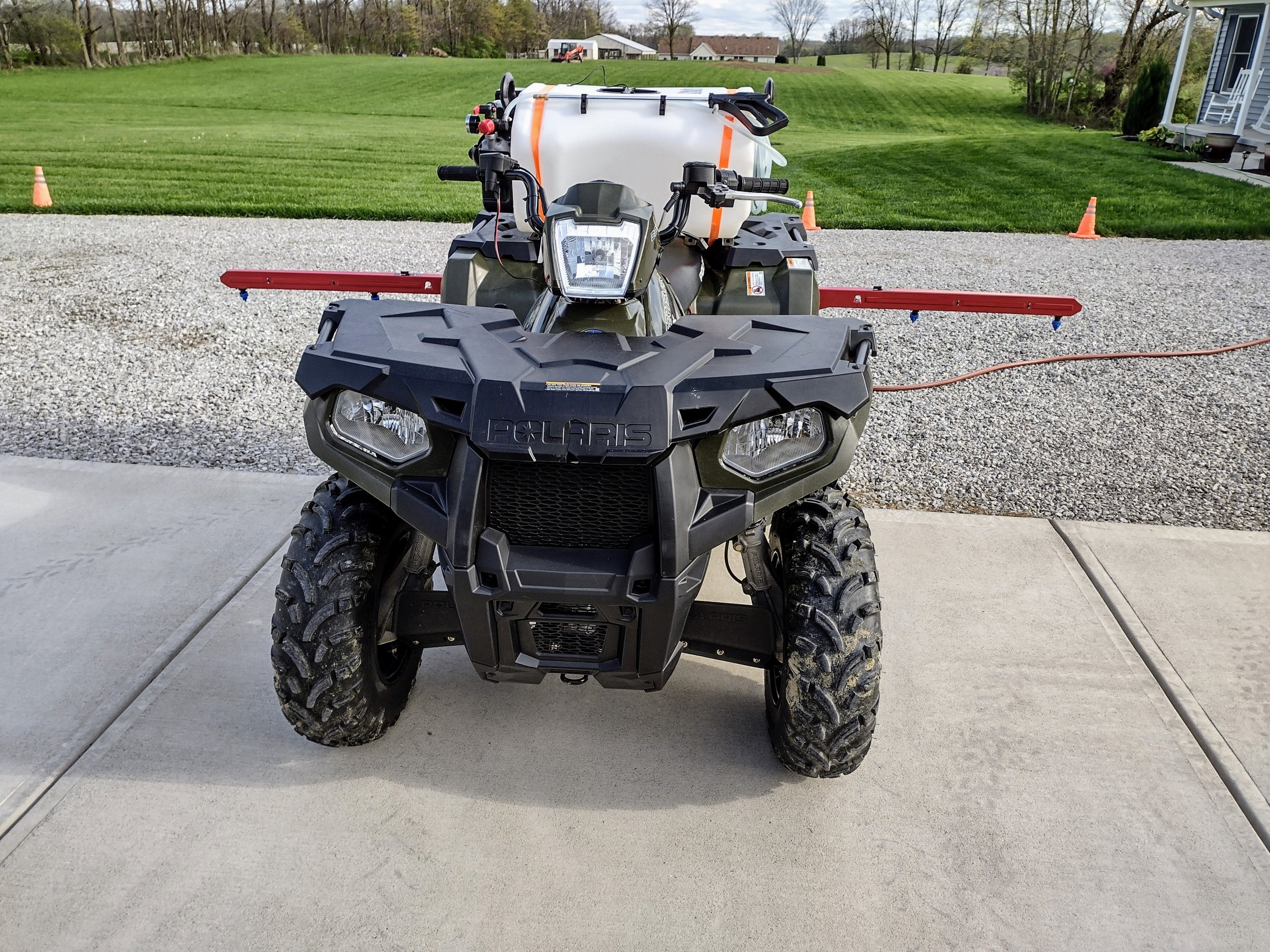

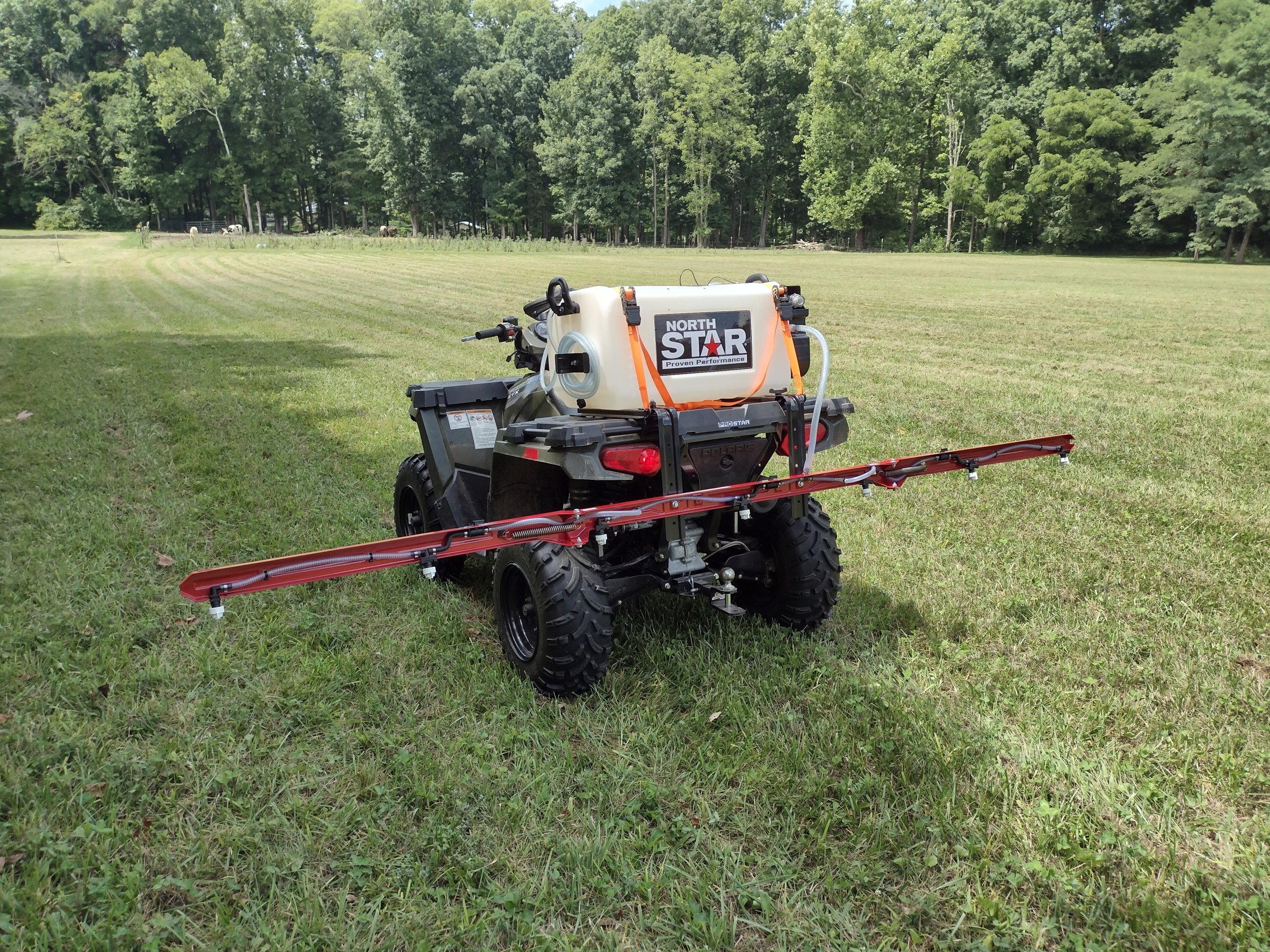

I bought the Northstar 25 gallon, 7 nozzle, 12’ boom sprayer for my ATV.
It is downright amazing. I did head over to TeeJet and found the correct tips for broadcast application of herbicide though. The spray wand is great, as the pump will max at 60psi. I used it to apply FertiLome to my pears this spring, which was also amazing.
I use about 20gal/acre during broadcast operations at about 40psi and 3-4mph with the twin turbo air induction 003 tips. The pump continuously recirculates the tank, so it mixes the herbicide/pesticide/sticker spreader very well.
I had a clip for one of the spray nozzles go MIA, and called Northstar. Within a week I had the warranty part on my step.
Oh, the boom folds, is spring loaded so if you hit a tree or post, it just flexes, and there are valves to turn each section off individually. It is a quality unit, with a lot of nice features you probably won’t find in a homemade unit.
