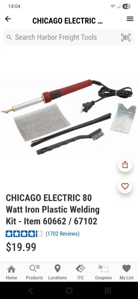

What about trying a plastic welding tool. I have an attachment that goes on a Weller soldering iron that has served me well over the years!

That $20 Harbor Freight soldering iron style plastic welder would work just fine for that HDPE tank, go slow as the tip is copper and is really soft and easy to break, let the heat do the work, don't force it... I would use the tip backward to open up the crack with the point then slowly heat it up with some of the filler rod it comes with until it is flush then probably cut a piece of the stainless mesh it comes with and push that in flush with the surface for strength.
Typically cracking on older poly tanks is because they are UV degraded. Welding might or might not work. I'd try deflecting the plastic and see if it cracks away from the seam, before I wnet ot the trouble of trying to repair it.
